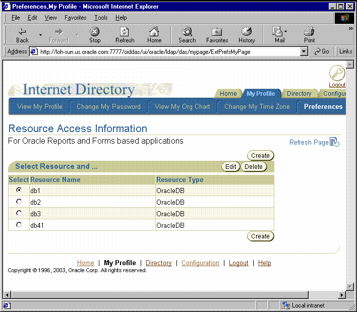

10.3.3.2.2 User Prompt
If you prefer to have users enter their own connection string information, you do not have to pre-populate the Oracle Internet Directory with data source connection information at all. If you use SSOCONN when launching the report but the Oracle Internet Directory does not already contain a connection string for the key and the key is not publicly available to all users, the Oracle Delegated Administration Services Create Resource page is displayed to the user, who must enter their data source connection string. See Figure 10-2. Oracle Delegated Administration Services stores the string entered by the user in the Oracle Internet Directory for future use and rwservlet uses the newly entered connection string for the data source connection string of the report.
Because of this feature, many users can use the same report URL even if they all use different data source connection strings.
Figure 10-2 Oracle Delegated Administration Services Create Resource
Description of sec_sso_das.gif follows
In the Create Resource dialog, if you want to enter a JDBC connection string, you can do so by entering hostname:port:sid in the Database field.

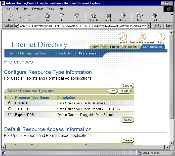

10.3.3.2.4 Making a Resource Available to All Users
If you want to make a resource publicly available to all of your users, you can do so by following these steps:
  1. Launch Oracle Delegated Administration Services and go to the Home tab.
  2. Login as the administrator (orcladmin).
  3. Click the Configuration tab.
  4. Click the Preferences sub tab and you should see a page similar to the one in Figure 10-3.
Figure 10-3 Oracle Internet Directory Configuration Preferences Page
Description of sso_dascrti.gif follows
  1. Under Default Resource Access Information, click Create.
  2. In the Create Resource page, enter the resource name and select the Resource type from the drop-down list. For example, JDBCPDS.
  3. Click Next.
  4. Enter the connection information. For example, scott/tiger@mydb.
  5. Click Submit.
  6. Click OK.
    That resource should now appear under Default Resource Access Information and be available to all users.

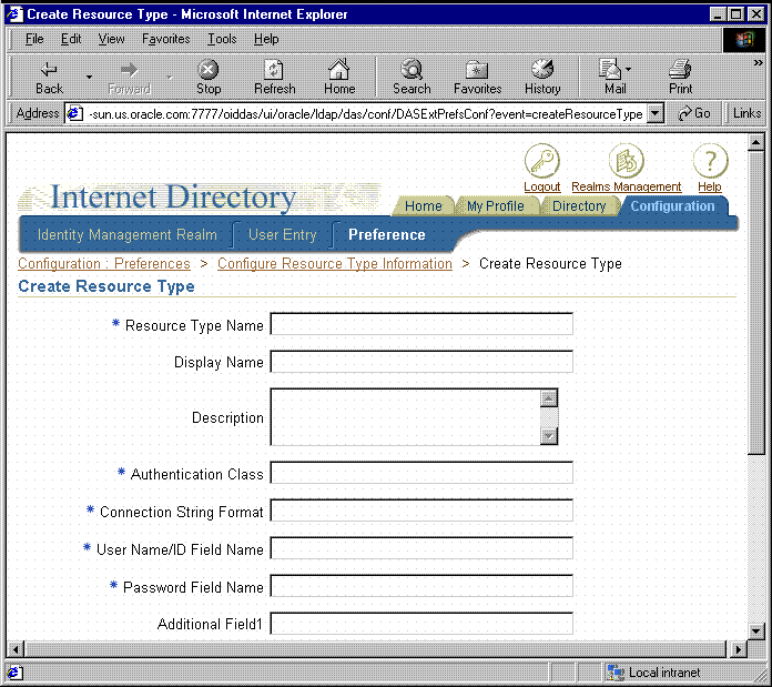

10.3.3.3 Adding a New Resource Type
If you want to add a new resource type to support your own pluggable data source, you need to perform the following procedure:
  5. Under Configure Resource Type Information, click Create and you should see a page similar to the one in Figure 10-4.
    Figure 10-4 Create Resource Type page
    Description of dascrt.gif follows
  6. Fill in at least the required fields. Field descriptions are provided in Table 10-1.
    Table 10-1 Create Resource Type Properties
    Property Description
    Resource Type Name Is the name of the new resource type. This name is used when you need to reference the resource type, for example, in the data_source_type portion of the SSOCONN string.
    Display Name Is the name to be used when the resource type appears in the user interface.
    Description Is a textual description that explains the purpose of the resource type and any other documentary information you want to enter for it.
    Authentication Class Leave this field blank.
    Connection String Format Defines how OracleAS Reports Services should construct the connection string using the values stored in Oracle Internet Directory for the resource. For example:
    for the Oracle database or a JDBC data source your connection string format might be:
    orclUserIDAttribute/orclPasswordAttribute @orclFlexAttribute1
    This string indicates that the user name is followed by a slash, the password, an at sign (@), and then additional attribute 1 (e.g., for the TNS name of the database). A connection string that adheres to this format would look similar to this one:
    scott/tiger@db1
    for Oracle Express your connection string format might be:
    server=orclFlexAttribute1/domain=orclFlexAttribute2/user=orclUserIDAttribute/password=orclPasswordAttribute
    This string indicates that server= is followed by the first additional attribute, a slash, domain=, the second additional attribute, a slash, the user name, a slash, and the password. A connection string that adheres to this format would look similar to this one:
    server=a1/domain=a2/user=scott/password=tiger
    User Name/ID Field Name Is the display name of the user name field that contains the value for orclUserIDAttribute. The display name appears on the Create Resource page (Figure 10-2) next to the field for orclUserIDAttribute. Typically, you would enter something like Username or User Name for this display name.
    Password Field Name Is the display name of the password field that contains the value for orclPasswordAttribute. The display name appears on the Create Resource page (Figure 10-2) next to the field for orclPasswordAttribute. Typically, you would enter something like Password or password for this display name.
    Additional Field 1-3 Is the display name of the additional fields, which contain the values of orclFlexAttribute1, orclFlexAttribute2, and orclFlexAttribute3. You need to specify these fields for whatever values your connection string requires beyond user name and password. For example, you might use one of them to contain a server or domain name.The display name appears on the Create Resource page (Figure 10-2) next to the field for orclFlexAttribute1, orclFlexAttribute2, or orclFlexAttribute3. Typically, you would enter something descriptive of the field’s contents, such as Server or Domain, for this display name.
  7. Click Submit. Your resource type is created and you can now reference it in the data_source_type portion of the SSOCONN argument.
