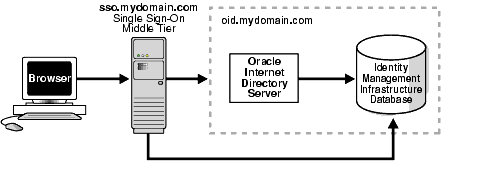

One Single Sign-On Middle Tier, One Oracle Internet Directory
The simplest and quickest way to deploy OracleAS Single Sign-On is to install OracleAS infrastructure components on the same computer. To do this, you choose the installation type "OracleAS Infrastructure 9.0.4.0.0" and the installation option "Identity Management and OracleAS Metadata Repository." When presented with the component list for this installation type, accept the default selected components.
Alternatively, you can install the single sign-on middle tier on a separate computer, choosing in succession "OracleAS Infrastructure 9.0.4.0.0," "Identity Management," and finally "Single Sign-On." This is the simplest distributed configuration.

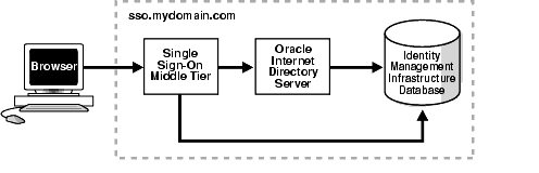

Figure 9-1 shows the first type of installation. Figure 9–2 shows the second. The first is typical of a testing, staging, or development environment. The second is appropriate when you want to position a firewall between the single sign-on computer and the Oracle Internet Directory computer. Placing these servers on separate computers has the added benefit that it improves performance.
Figure 9-1 Default Single Sign-On Installation: One Computer
Description of ssoag028.gif follows
Figure 9-2 Single Sign-On Installation: Two Computers
Description of ssoag029.gif follows

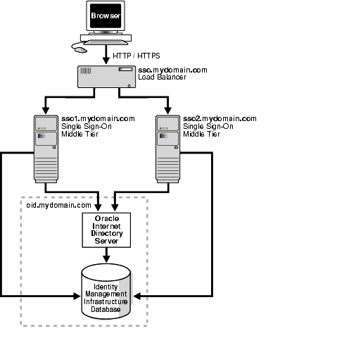

Multiple Single Sign-On Middle Tiers, One Oracle Internet Directory
The simplest high availability scenario involves failover within the single sign-on instance itself, at the middle tier. Adding multiple middle tiers increases scalability and therefore makes the single sign-on server more available.
In this configuration, a single HTTP load balancer is placed in front of two or more Oracle HTTP servers. At the backend is one directory server and one identity management infrastructure database. The purpose of the load balancer is to publish a single address to single sign-on partner applications while providing a farm of single sign-on middle tiers that actually service the application requests. The HTTP load balancer can detect when one of these Oracle HTTP Server instances has failed and can then fail over requests to another instance.
Usage Scenario
The usage scenario presented here assumes the following hypothetical configurations:
  • The directory server and identity management infrastructure database are located at oid.mydomain.com.
  • There are two single sign-on middle tiers. One is installed on host sso1.mydomain.com, IP address 138.1.34.172. The other is installed on sso2.mydomain.com, IP address 138.1.34.173. Both servers listen on non-SSL port 7777. Both are configured to use the directory and identity management infrastructure database located at oid.mydomain.com.
  • The effective URL of the single sign-on server that is published to partner applications is sso.mydomain.com, IP address 138.1.34.234. The HTTP load balancer is configured to listen on sso.mydomain.com, port 80. It load balances user requests between sso1.mydomain.com and sso2.mydomain.com.
    Notes:
    • In this scenario, the load balancer is listening on port 80, a non-SSL port number.
    • If the load balancer is configured to use SSL to interact with the browser, a different port number must be selected. The default SSL port number is 4443.
    • In this scenario and the one immediately following, two single sign-on middle tiers are used. There can, in fact, be any number of middle tiers.
Figure 9–3 shows two single sign-on middle tiers configured to use a single instance of Oracle Internet Directory.
Figure 9-3 Two Single Sign-On Middle Tiers, One Oracle Internet Directory
Description of ssoag030.gif follows

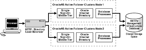

Using OracleAS Active Failover Clusters for the Identity Management Infrastructure
In OracleAS release 9.0.4, the OracleAS infrastructure may be installed on active failover clusters. When this option is selected, all infrastructure components—single sign-on, Oracle Internet Directory, and the database—are installed on one node. In Figure 9-4, a load balancer sits in front of a two-node active cluster, providing scalability, high availability, and failover for all infrastructure components.
Figure 9-4 Single Sign-On Using OracleAS Active Failover Clusters
Description of ssoag031.gif follows
Postinstallation note: if you modify policy.properties, web.xml, or any other single sign-on configuration file on one active cluster node, you must manually copy the files to the other active failover cluster nodes. Alternatively, you can make the files soft links to a shared disk drive.
Usage Scenarios and Configuration Steps
To learn how to configure and use OracleAS Active Failover Clusters, see Chapter 3, "Infrastructure High Availability," in Oracle Application Server 10g High Availability Guide.

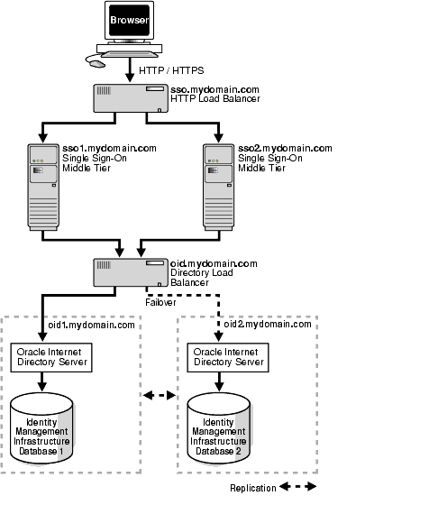

Multiple Single Sign-On Middle Tiers, Replicated Oracle Internet Directory
In local area networks that experience high traffic, it may be beneficial to supplement multiple single sign-on middle tiers with replicated instances of Oracle Internet Directory. This arrangement, depicted in Figure 9-5, provides failover not only at the middle tier, but also at the directory server.
Usage Scenario
The usage scenario that follows assumes the following hypothetical configurations:
  • There are two single sign-on middle tiers. One is installed on host sso1.mydomain.com. The other is installed on sso2.mydomain.com.
  • An HTTP load balancer is situated between the browser and the two single sign-on middle tiers.
  • The address of the single sign-on server that is published to partner applications is sso.mydomain.com. This is also the external address of the load balancer.
  • There are two identity management infrastructure databases—one at oid1.mydomain.com, the other at oid2.mydomain.com. The two directory servers located at these nodes constitute a replication group.
  • For replication purposes, oid1.mydomain.com is the master definition site (MDS), the site from which the replication scripts are run and data is first replicated. oid2.mydomain.com is the remote master site (RMS), the site to which data is replicated.
  • A load balancer is situated in front of the replicated directory servers. This load balancer is configured for failover, but not for load balancing.
  • The address of the directory server that is published to the single sign-on middle tiers is oid.mydomain.com. This is also the external address of the directory load balancer.
Configuration Steps
The following steps combine instructions presented in directory replication documentation and "Multiple Single Sign-On Middle Tiers, One Oracle Internet Directory". The latter is a deployment scenario that was presented earlier in this chapter.
  1. Choose effective host names for the load balancers serving Oracle Internet Directory and OracleAS Single Sign-On. In the usage scenario just introduced, this task has already been completed.
  2. Install Oracle Internet Directory on oid1.mydomain.com and oid2.mydomain.com; then set these servers up as a replication group. For instructions, see Oracle Internet Directory Administrator's Guide. These instructions cover both installation and replication. For replication concepts, see also Oracle Internet Directory Administrator's Guide.
  3. On the directory load balancer, configure one pool of real servers with the addresses oid1.mydomain.com and oid2.mydomain.com. Configure one virtual server with the address oid.mydomain.com. Ensure that the directory load balancer is configured for failover, but not for load balancing. The load balancer should be configured with persistent (stateful) routing.
  4. Install the OracleAS infrastructure on the middle tiers sso1.mydomain.com and sso2.mydomain.com, choosing the option "Identity Management." When presented with the component list for this installation type, choose "Single Sign-On." When the Oracle Universal Installer asks you to name the directory server associated with these single sign-on instances, enter oid.mydomain.com.
  5. Configure the two Oracle HTTP servers in this scenario to resolve the virtual address of the single sign-on server, sso.mydomain.com, to the real, internal host names, sso1.mydomain.com and sso2.mydomain.com. For instructions, see "Configure the Oracle HTTP servers on the single sign-on middle tiers" for instructions.
  6. Configure the single sign-on server to accept authentication requests from the effective URL of the single sign-on server. This task is effected by running the ssocfg script on one of the single sign-on middle tiers. Using the example provided, the script would be executed in the following way:
    • UNIX:
      $ORACLE_HOME/sso/bin/ssocfg.sh http sso.mydomain.com 80
    • Windows NT/2000:
      %ORACLE_HOME%\sso\bin\ssocfg.bat http sso.mydomain.com 80
    Note that the command example provides the listener protocol, host name, and port number of the load balancer as arguments. Recall that the load balancer address is the effective URL of the single sign-on server. If the load balancer is configured to use SSL, replace non-SSL port 80 with SSL port 4443 and http with https.
    After running ssocfg, update the targets.xml file on the single sign-on middle tier. See "Update targets.xml" for instructions.
  7. Reregister mod_osso on the single sign-on middle tiers. Follow the steps in "Reregister mod_osso on the single sign-on middle tiers".

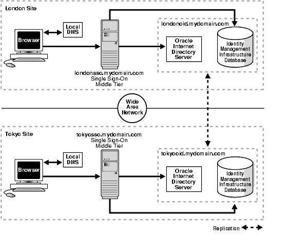

Multiple, Geographically Distributed Single Sign-On Instances
Server availability is critical for an enterprise whose operations are widely distributed geographically. If the enterprise uses a single server to authenticate remote users over a wide area network, the authentication time can be lengthy. To shorten network round-trips and speed access to applications, the enterprise can implement multiple, geographically distributed instances of the single sign-on server. This arrangement enables users to travel to remote locations and be authenticated by the nearest server, regardless of where applications are located.
In this scenario, single sign-on database tables are replicated over either a local area network or a wide area network. The DNS server located at each single sign-on middle tier site must be configured to resolve the effective address of the single sign-on server to the single sign-on instance that is nearest to the user.
Usage Scenario
  • There are two single sign-on middle tiers: londonsso.mydomain.com and tokyosso.mydomain.com. The effective address of the single sign-on server is sso.mydomain.com.
  • There are two directory servers/identity management infrastructure databases associated with the two single sign-on middle tiers: londonoid.mydomain.com and tokyooid.mydomain.com.
  • For replication purposes, londonoid.mydomain.com is the MDS, the site from which the replication scripts are run and data is first replicated. tokyooid.mydomain.com is the RMS, the site to which data is replicated.
  • The single sign-on middle tiers and the identity management infrastructure databases are located on separate computers.
Figure 9-6 depicts what this geographically distributed system looks like once it is deployed.
Figure 9-6 A Highly Available, Geographically Distributed Single Sign-On System
Description of ssoag033.gif follows
Configuration Steps
The geographically dispersed single sign-on system shown in Figure 9–6 incorporates steps presented in "Multiple Single Sign-On Middle Tiers, One Oracle Internet Directory" and "Configuring the Identity Management Database for Replication".
  1. Install Oracle Internet Directory on the MDS, londonoid.mydomain.com, and on the RMS, tokyooid.mydomain; then set these servers up as a replication group. For instructions, see Oracle Internet Directory Administrator's Guide. These procedures cover both installation and replication. For replication concepts, see also Oracle Internet Directory Administrator's Guide.
  2. Install the OracleAS infrastructure on the middle tier londonsso.mydomain.com, choosing the option "Identity Management." When presented with the component list for this installation type, choose "Single Sign-On." When the Oracle Universal Installer asks you to name the directory server associated with this single sign-on instance, enter londonoid.mydomain.com.
  3. Repeat step 2, this time on middle tier tokyosso.mydomain.com. In this case, you must associate the single sign-on server with the directory server located at tokyooid.mydomain.com.
  4. Synchronize single sign-on schema passwords between the MDS database and the RMS database. To do this, complete steps 2 and 3 in "Configuring the Identity Management Database for Replication".
  5. Although two single sign-on instances are now running at different locations, only one effective server URL is published to partner applications. Configure the single sign-on server to use this URL. In this scenario, we call the URL sso.mydomain.com. See "Configure the Oracle HTTP servers on the single sign-on middle tiers" for instructions.
  6. Add a DNS alias, sso.mydomain.com, that points to the single sign-on middle tiers. Configure the DNS server to rout the user to the nearest middle tier when single sign-on authentication is required. When, for example, a London user is redirected to http://sso.mydomain.com, the DNS server should route the user to http://londonsso.mydomain.com. Similarly, a Tokyo user redirected to http://sso.mydomain.com should be routed to http://tokyosso.mydomain.com.
    Note that some advanced DNS server products may be able to route users to the nearest server based on the geographic location.

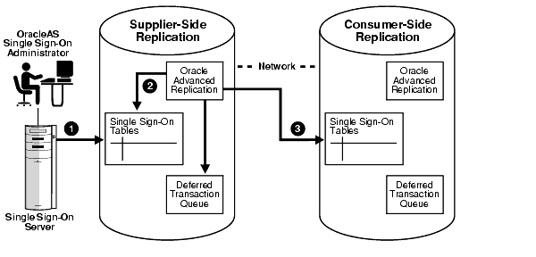

The Replication Mechanism
The identity management infrastructure uses Oracle9i Advanced Replication to replicate tables between two databases. This feature propagates data changes between databases asynchronously. In other words, suppliers write changes to single sign-on tables and periodically send batched changes to consumers, servers that replicate this data. All of the servers in a multiple, geographically distributed system can either propagate or receive data. This arrangement is called multimaster replication. Figure 9-7 illustrates the process.
Figure 9-7 Multimaster Replication Architecture
Description of ssoag027.gif follows
  1. The single sign-on administrator uses the single sign-on administration application to modify single sign-on partner applications or configuration data. This process modifies the corresponding table entry in the identity management infrastructure database.
  2. Oracle9i Advanced Replication copies the change to a deferred transaction queue.
  3. At a scheduled interval, Oracle9i Advanced Replication pushes transactions in the deferred transaction queue to the single sign-on table on the consumer side.
