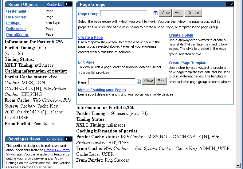

The following statistics are available when the portal page is run in debug mode:
The following image shows a page that is running in the _debug=0 mode:
Figure C-1 Portal Page Running in Debug Mode
Description of cg_sshot_dbug.gif follows
C.7.1 Portlet Statistics
In Figure C-1, you can see a number of Portlet related statistics listed under each portlet. Each Portlet has a unique internal reference identification number. This number is used in the "Information for Portlet" summary. For the portlet in the top left corner of Figure C-1, you can see that this number is 6256.
For each portlet the following statistics are listed:
C.7.1.1 Portlet Timing Information
  • Portlet Timing (msecs) (wait msecs)
    Indicates how many milliseconds it took to retrieve the portlet, and how long the request was queued, also in milliseconds.

C.7.1.2 Portlet Caching Information
  • Portlet Cache status Web Cache (values) File System Cache (values)
    This is the Cache status from both OracleAS Web Cache and the mod_plsql file cache.
    Valid values for OracleAS Web Cache are:
    • MISS, or NEW [M] indicating a cache miss in OracleAS Web Cache and that the content that is generated by the portlet is new.
    • MISS, or STALE [G] indicating a cache miss, due to stale content in OracleAS Web Cache.
    • HIT [H] indicating a OracleAS Web Cache hit.
