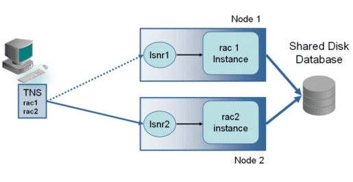

Another benefit of multiple listeners is fault-tolerance of listener failure. Clients can failover to alternate listeners at connect time by supplying a list of listeners in their connect descriptor. Figure D-3 illustrates connect time failover.
Figure D-3 When lsnr1 Fails, Requests Can Be Re-routed to lsnr2
Description of rac2.gif follows
Example D-2 Sample tnsnames.ora Entry Enabling Failover

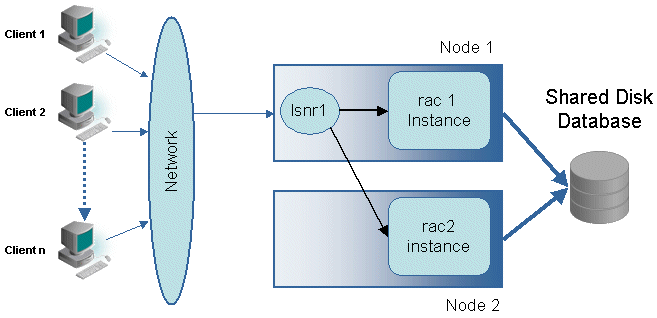

Listener Load Balancing
A database listener sitting in front of multiple RAC instances can provide load balancing across them. The listener is aware of each instance, whether it is running or down, and its load. In creating a database connection, a client generally specifies only the database service name and listener address, and not the instance name, in order to defer instance selection to the listener's load balancing algorithm. This is called listener or connection load balancing (see Figure D-4).
For more information about listeners and database connections, see the Oracle9i Net Services Administrator's Guide.
Figure D-4 Listener Load Balancing
Description of lnsrlb.gif follows
If you configure your system for listener-only load balancing, note the following:

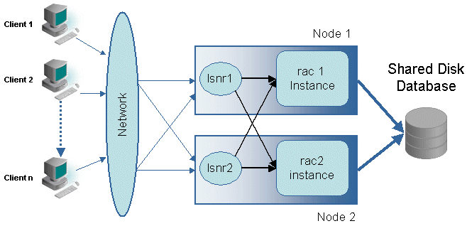

For optimal high availability and performance, you should configure your system for both client and listener load balancing. Figure D-5 illustrates this scenario.
Figure D-5 Client and Listener Load Balancing
Description of multilb.gif follows
