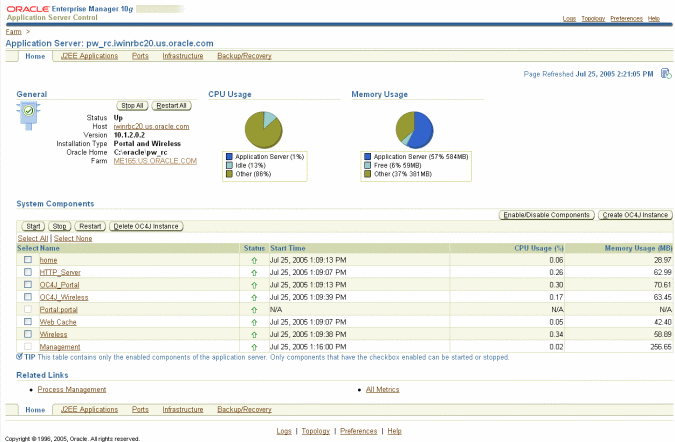

  1. Login into Oracle Application Server Control. The Application Server Control Console displays:
    Oracle Application Server Control Console

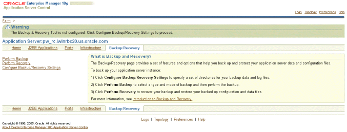

  2. Click BackupRecovery. The Backup and Recovery screen displays:
    Screen with warning that Backup/Recovery not configured
  3. If the Backup and Recovery Tool has not been configured, a warning screen displays stating that the tool is not configured. Click Configure BackupRecovery Settings. Depending on the type of installation, the midtier configuration screen or the Infrastructure configuration screen displays:

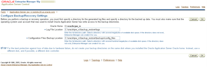

    For the midtier configuration screen, enter the following information for each field:
    • Log File Location—Enter the directory where you want the log file for backup and recovery stored. You should allow for several megabytes of disk space. In the preceding example screen the default location is shown.
    • Configuration Files Backup Location—Enter the directory where you want the backups of configuration files stored. You should allow for several hundred megabytes of disk space. In the preceding example screen, a location is filled in as an example. If the Backup and Recovery Tool is not configured, this field is blank.

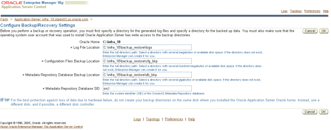

    For the Infrastructure configuration screen, enter the following information for each field:
    • Metadata Repository Database Backup Location—Enter the directory where you want the backups of the metadata repository database stored. You should allow for several hundred gigabytes of disk space.
    • Metadata Repository Database SID—This field is automatically filled in. Change it only in the case where the database SID has changed since installation.

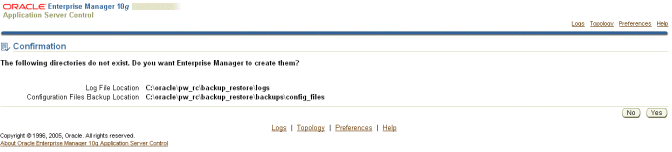

  4. Click OK. If any of the specified directories do not exist, a confirmation screen displays:
    Confirmation screen about existence of specified directories
  5. Click Yes to have the directories created, or click No to create the directories manually. Once a successful configuration completes, a confirmation screen displays a message stating that configuration was successful, or the screen displays a message stating that the configuration was unsuccessful.

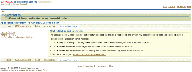

    Corfirmation screen about the success of the configuration
