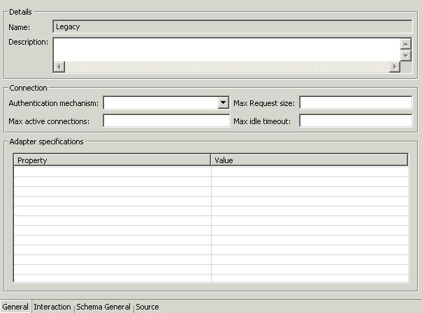

Use the General tab to maintain information describing the adapter and the connection to the adapter.
The General tab is shown in the following figure:
The General tab comprises fields, as listed in the following table:
| Field | Description |
| Adapter definition name | Specifies the name of the adapter definition. |
| Description | Specifies an identifying description of the adapter. |
| Authentication mechanism | Specifies the authentication method used to access the adapter. The available mechanisms are:
kerbv5 none basic password |
| Max request size | Specifies the maximum size in bytes for an XML request or reply. Larger messages are rejected with an error. |
| Max active connections | Specifies the maximum number of simultaneous connections for an adapter (per process). |
| Max idle timeout | Specifies the maximum time, in seconds, that an active connection can stay idle. After that time, the connection is closed. |
| Adapter Specifications | Specifies the adapter-specific properties for an interaction. The IMS/TM back-end adapter does not have any adapter-specific properties. |

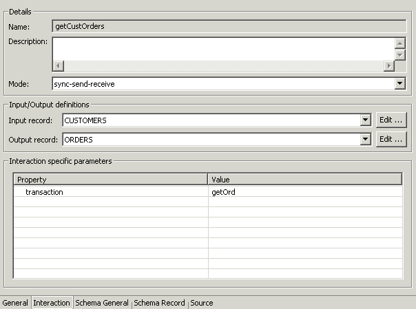

Use the Interaction tab to define the general details of the interaction in addition to its input and output definitions.
The Interactions tab is displayed in the following figure:
The Interaction tab comprises fields, as listed in the following table:
| Interaction name | Specifies the name of the interaction. |
| Description | Provides a descriptive identifier for the interaction. |
| Mode | Determines the interaction mode. The following interaction modes are available:
| Input record | Identifies an input record. |
| Output record | Identifies an output record for the results of an interaction. |
| Interaction Specific Parameters | Defines the properties and values of parameters specific to an interaction. The following property is available:
transaction: The name of the IMS/TM transaction that is called when the interaction is executed. |

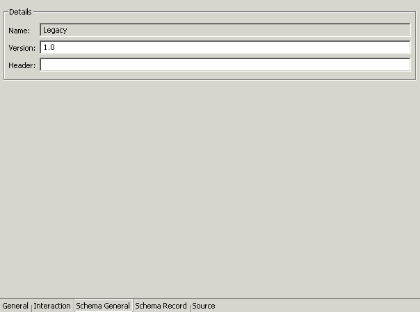

Use the Schema General tab to define the general details of the input and output record structures for the interaction.
The Schema General tab is shown in the following figure:
The Schema General tab comprises fields, as listed in the following table:
| Schema name | The name of the adapter. |
| Version | The schema version. |
| Header | A C header file to map between the data structure and the adapter. |

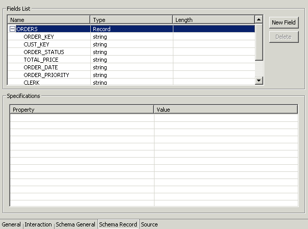

Use the Schema Record tab to define the input and output record structures for the interaction.
The Schema Record tab is shown in the following figure.
The Schema Record tab comprises fields, as listed in the following table:
Use the Fields List to defines single data items within a record.
| Name | Specifies the name of the field. |
| Type | The data type of the field. The following are valid data types:
See Also: Appendix B, "IMS/TM Back-end Adapter Data Type Support" for details about the mapping from COBOL data types to IMS/TM back-end adapter data types. |
| Length | The size of the field including a null terminator, when the data type supports null termination. |
Note: Use the Specifications box to specify field properties. |
See Also: Appendix B, "IMS/TM Back-end Adapter Data Type Support" for details about the mapping from COBOL data types to Oracle Connect data types. |
