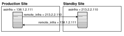

    4. Create a separate entry for Oracle Data Guard in the internal DNS servers. This entry is used by Oracle Data Guard to ship redo data to the database on the standby site.
      In the next example, the "remote_infra" entry points to the infrastructure node on the standby site. This name is used by the TNS entries on both the production and standby sites so that if a switchover occurs, the entry does not have to be changed.
      Figure 11-3 Entry for Oracle Data Guard in the Internal DNS Servers
      Description of Figure 11-3 follows
      Description of "Figure 11-3 Entry for Oracle Data Guard in the Internal DNS Servers"
      On the production site, the DNS entries look like this:
      asmid1.asha        IN  A  138.1.2.333
      asmid2.asha        IN  A  138.1.2.444
      asinfra.asha       IN  A  138.1.2.111
      remote_infra.asha  IN  A  213.2.2.110
      On the standby site, the DNS entries look like this:
      asmid1.asha        IN  A  213.2.2.330
      asmid2.asha        IN  A  213.2.2.331
      asinfra.asha       IN  A  213.2.2.110
      remote_infra.asha  IN  A  138.1.2.111
