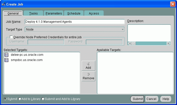

The agentInstallJob.tcl script must be run as a Tcl job from an Enterprise Manager Release 2.2, Release 9.0.1, or Release 9.2 Console. As shown in Figure 11-1, you define the job by choosing a "Node" target type and then selecting the machines on which the 10.1 Management Agents are to be installed.
Figure 11-1 Selecting Machines for Management Agent Deployment
Once you have selected where the Management Agents are to be deployed, you need to define an installation task using agentInstallJob.tcl. As shown in Figure 11-2, select the "Run TCL Script" task.
