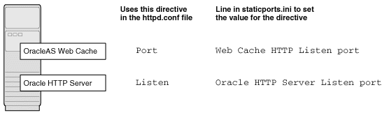

If you plan to install multiple instances (such as an OracleAS Infrastructure and a middle tier, or multiple middle tiers) on the same computer, only the first instance that you install on the computer will use the default ports. When you install additional instances, the installer will detect that the default ports are already in use by the first instance, and it will assign other ports to the additional instances.
The components where this is most visible are Oracle HTTP Server and OracleAS Web Cache, as shown in the following scenarios:

The staticports.ini file has the following format. Replace port_num with the port number that you want to use for the component.
# J2EE and Web Cache Oracle HTTP Server port = port_num Oracle HTTP Server Listen port = port_num Oracle HTTP Server SSL port = port_num Oracle HTTP Server Listen (SSL) port = port_num Oracle HTTP Server Diagnostic port = port_num Java Object Cache port = port_num DCM Java Object Cache port = port_num DCM Discovery port = port_num Oracle Notification Server Request port = port_num Oracle Notification Server Local port = port_num Oracle Notification Server Remote port = port_num Application Server Control port = port_num Application Server Control RMI port = port_num Oracle Management Agent port = port_num Web Cache HTTP Listen port = port_num Web Cache HTTP Listen (SSL) port = port_num Web Cache Administration port = port_num Web Cache Invalidation port = port_num Web Cache Statistics port = port_num Log Loader port = port_num # Infrastructure Oracle Internet Directory port = port_num Oracle Internet Directory (SSL) port = port_num Oracle Certificate Authority SSL Server Authentication port = port_num Oracle Certificate Authority SSL Mutual Authentication port = port_num Ultra Search HTTP port number = port_num
The easiest way to create the file is to use the staticports.ini file on the CD-ROM (Disk 1) or DVD-ROM as a template:

In the httpd.conf file for Oracle HTTP Server, the Port and the Listen directives specify the ports used by OracleAS Web Cache and Oracle HTTP Server. The correct lines in the staticports.ini file for setting these ports depend on which components you are configuring.
If You Are Configuring OracleAS Web Cache and Oracle HTTP Server
Set the port for OracleAS Web Cache.
OracleAS Web Cache uses the port specified by the Port directive (Figure 4-1). To set this port, use this line in the staticports.ini file:
Web Cache HTTP Listen port = port_number
To configure the SSL port for OracleAS Web Cache, use the following line:
Web Cache HTTP Listen (SSL) port = port_number
You cannot set the port number using the "Oracle HTTP Server port" line in this case. If your staticports.ini file contains both "Oracle HTTP Server port" and "Web Cache HTTP Listen port", the "Oracle HTTP Server port" line is ignored. For example, if you have these lines in staticports.ini:
Web Cache HTTP Listen port = 7979 Oracle HTTP Server port = 8080
the Port directive would be set to 7979.
Set the port for Oracle HTTP Server.
Oracle HTTP Server uses the port specified by the Listen directive. To set this port, use this line in the staticports.ini file:
Oracle HTTP Server Listen port = port_number
To configure the SSL Listen port, use the following line:
Oracle HTTP Server Listen (SSL) port = port_number
Figure 4-1 Configuring Both OracleAS Web Cache and Oracle HTTP Server

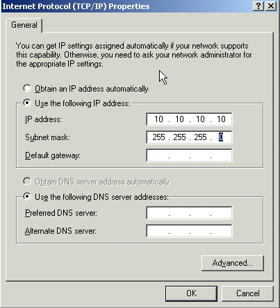

Before installing Oracle Application Server on a DHCP computer, perform these steps:
Install a loopback adapter on the DHCP computer.
When you install a loopback adapter, the loopback adapter assigns a local IP for your computer. Having a loopback adapter and a local IP address means that you do not have to run the chgiphost script after installation each time the IP address changes (due to DHCP).
Which Is the Primary Network Adapter?
Windows considers loopback adapters as a type of network adapter. After installing a loopback adapter on your computer, you have at least two network adapters on your computer: your network adapter and the loopback adapter.
You want Windows to use the loopback adapter as the primary adapter. The primary adapter is determined by the order in which you installed the adapters:
On Windows 2000, the primary adapter is the last adapter installed. You can just install the loopback adapter. However, if you install additional network adapters after you install the loopback adapter, you need to deinstall the loopback adapter and reinstall it.
To install a loopback adapter on the different Windows platforms, see Section 4.7.6, "Installing a Loopback Adapter".
Ping each computer where you plan to install Oracle Application Server.
Ping the computer from itself, using only the hostname and using the fully qualified name.
For example, if you installed a loopback adapter on a computer called mycomputer, check the following:
prompt> ping mycomputer Ping itself using just the hostname. Reply from 10.10.10.10 Returns loopback adapter IP. prompt> ping mycomputer.mydomain.com Ping using a fully qualified name. Reply from 10.10.10.10 Returns loopback adapter IP.

In the Properties dialog (Figure 4-3), enter the following values:
IP Address: Enter a non-routable IP for the loopback adapter. The following non-routable addresses are recommended:
192.168.x.x (x is any value between 1 and 255)
10.10.10.10
Subnet mask: Enter 255.255.255.0.
Leave all other fields empty.
Click OK.
Figure 4-3 Internet Protocol (TCP/IP) Properties Dialog Showing Values for the Loopback Adapter

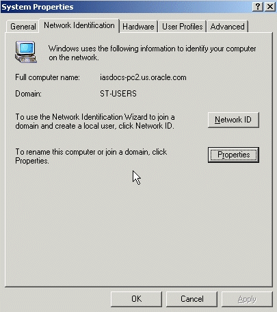

Open the System control panel, and select the Network Identification tab. In Full computer name, make sure you see the hostname and the domain name (Figure 4-4).
Figure 4-4 System Control Panel, Network Identification Tab

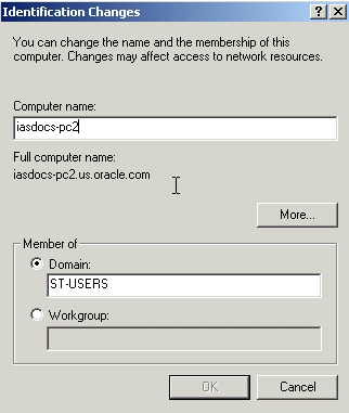

Click Properties. In Computer name, you should see the hostname, and in Full computer name, you should see the hostname and domain name (Figure 4-5).
Figure 4-5 Identification Changes Dialog

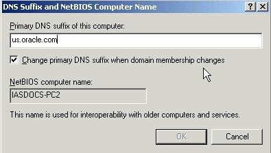

Click More. In Primary DNS suffix of this computer, you should see the domain name (Figure 4-6).
Figure 4-6 DNS Suffix and NetBIOS Computer Name Dialog

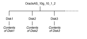

To Copy the CD-ROMs:
Create a directory structure on your hard drive as shown in Figure 4-7.
You need to create a parent directory (called OracleAS_10g_10_1_2 in the example, but you can name it anything you like), and, under the parent directory, create subdirectories called Disk1, Disk2, and so on. The names of the subdirectories must be DiskN, where N is the CD-ROM number.
Figure 4-7 Directory Structure for Copying CD-ROMs to Disk
Copy the contents of each CD-ROM into the corresponding directory.

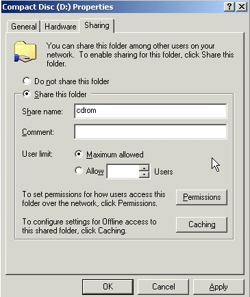

Right-click the CD-ROM or DVD-ROM drive letter and choose Sharing (Windows 2000) or Sharing and Security (Windows 2003, Windows XP).
In the Sharing tab (Figure 4-8):
Select Share this folder.
Share name: Give it a share name such as cdrom or dvd. You will use this name when you map the CD-ROM or DVD-ROM drive on the local computer. See step d.
Click Permissions. You need at least "read" permission for the user who will be accessing it to install Oracle Application Server.
Click OK when done.

The steps that you have to do are:
Make sure that the remote control software is installed and running on the remote and local computers.
On the local computer, share the CD-ROM or DVD-ROM drive.
On the remote computer, map a drive letter to the shared CD-ROM or DVD-ROM drive. You would use the remote control software to do this on the remote computer.
These steps are described in Section 4.7.8, "Installing from a Remote CD-ROM or DVD-ROM Drive".
Through the remote control software, run the installer on the remote computer. You access the installer from the shared CD-ROM or DVD-ROM drive.
