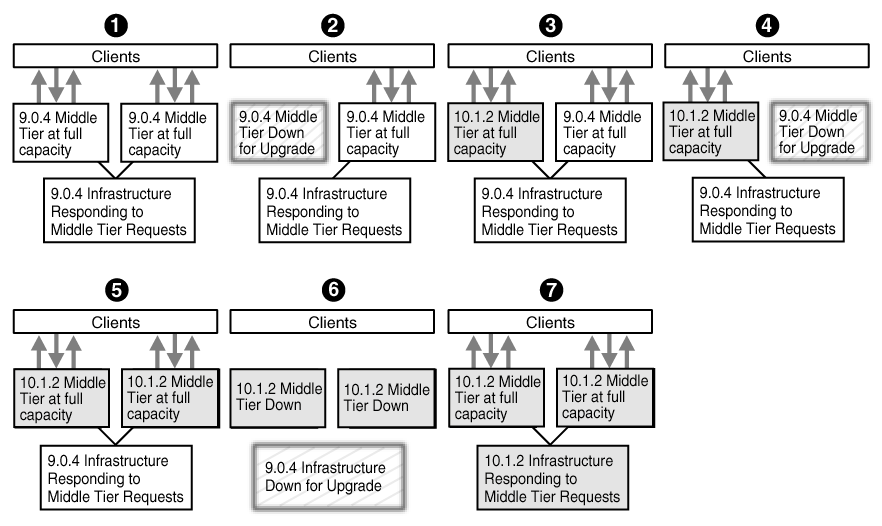

As an example of how you can plan for system availability, this section outlines the steps involved in the upgrade process when two Oracle Application Server 10g (9.0.4) middle tier instances use a single 10g (9.0.4) Infrastructure instance.
The colocated Infrastructure in this example consists of both an OracleAS Metadata Repository and OracleAS Identity Management. As shown in Figure 3-1, full system downtime occurs only in step 6 of the process (if the system relies on an Infrastructure). Step 6 involves stopping the OracleAS Infrastructure so it can be upgraded.
For simplicity's sake, only two middle tiers are shown in the figure; however, in practice, there may be many more. The more middle tiers in service, the lower the system capacity loss in downtime during upgrade. For example, if there are two middle tiers, 50% capacity is lost when one is stopped for upgrade. If there are four middle tiers, only 25% capacity is lost when one is stopped for upgrade.
In the figure, "Clients" may refer to a load balancer. If a load balancer is in use, users need not be aware of middle tier downtime.
Figure 3-1 Example of System Availability During the Upgrade Process
The progression of system states during the upgrade process is detailed as follows:
The 10g (9.0.4) system is functioning at full capacity, with clients connecting through both middle tiers.
The first middle tier is stopped, in preparation for upgrade. Clients can no longer connect through the first middle tier, but continue to connect through the second middle tier.
The first middle tier is upgraded to 10g (10.1.2). When the upgrade is complete and the middle tier is restarted, clients can then connect through both middle tiers.
This step in the process represents a transitional configuration.
The second middle tier is stopped, in preparation for upgrade. Clients can no longer connect through the second middle tier, but continue to connect through the first middle tier.
The second middle tier is upgraded to 10g Release 2 (10.1.2). After the second middle tier is upgraded and started, clients can then connect through both middle tiers.
The middle tiers are stopped in preparation for the Infrastructure upgrade. Applications that are dependent on the Infrastructure are unavailable now.
The Infrastructure is upgraded to 10g Release 2 (10.1.2). After the OracleAS Metadata Repository and OracleAS Identity Management are upgraded and all instances are started, clients can connect to the fully upgraded system.
This step in the process represents a final configuration.
