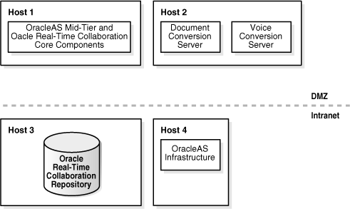

As shown in Figure 15-1, Host 1 and Host 2 are deployed in the DMZ, while Host 3 and Host 4 are deployed in the corporate intranet.
Figure 15-1 Oracle Real-Time Collaboration Basic Deployment
The following are the mandatory associations that must be made for the various parts of Oracle Web Conferencing to work:
Oracle Real-Time Collaboration Core Components to Oracle Real-Time Collaboration Repository: This association is made during installation
Oracle Real-Time Collaboration Core Components to Oracle9iAS Infrastructure: This association is made during installation
Document and Voice Conversion Servers to Oracle Real-Time Collaboration Repository: This association is made during installation
Document and Voice Conversion Servers to Oracle Real-Time Collaboration Core Components: This is a mandatory post-installation step
