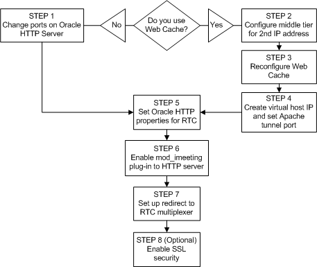

If you want to hold web conferences with users outside your company firewall, follow the steps in this section. Many of these steps need to be done on each of your Real-Time Collaboration core component instances.
Note: Whether you choose Step 1 or Steps 2 through 4 depends on whether you have Oracle9iAS Web Cache turned on or off on your Real-Time Collaboration core component instances. |
Step 1 If you do not use Web Cache, change ports on the Oracle HTTP Server. (System task)
If you do not use Web Cache, you must change the ports on the Oracle HTTP Server. These ports must be set to the standard values:
Set the HTTP port to 80.
Set the HTTPS port to 443.
After you have completed this task, you may skip steps 2 through 4 and go on to step 5.
Step 2 If you use Web Cache, configure your middle tier to use a second IP address (System task)
Step 3 If you use Web Cache, reconfigure it to listen to primary IP ports (System task)
Step 4 If you use Web Cache, create a second IP address and set tunnel properties. (Instance task)
If you use Oracle9iAS Web Cache, you must create set ApacheTunnel properties on the Real-Time Collaboration core component instance to use the second IP address and port you set previously. You must repeat these steps on each Real-Time Collaboration core component instance that uses Web Cache.

Step 5 Set Web Conferencing to use the Oracle HTTP Server settings. (Instance task)

Step 6 Enable mod_imeeting. (Server task)

Step 7 Set up the redirect from mod_imeeting to mx. (Instance task)

Step 8 Set up SSL Security. (OPTIONAL System, and Instance task)
