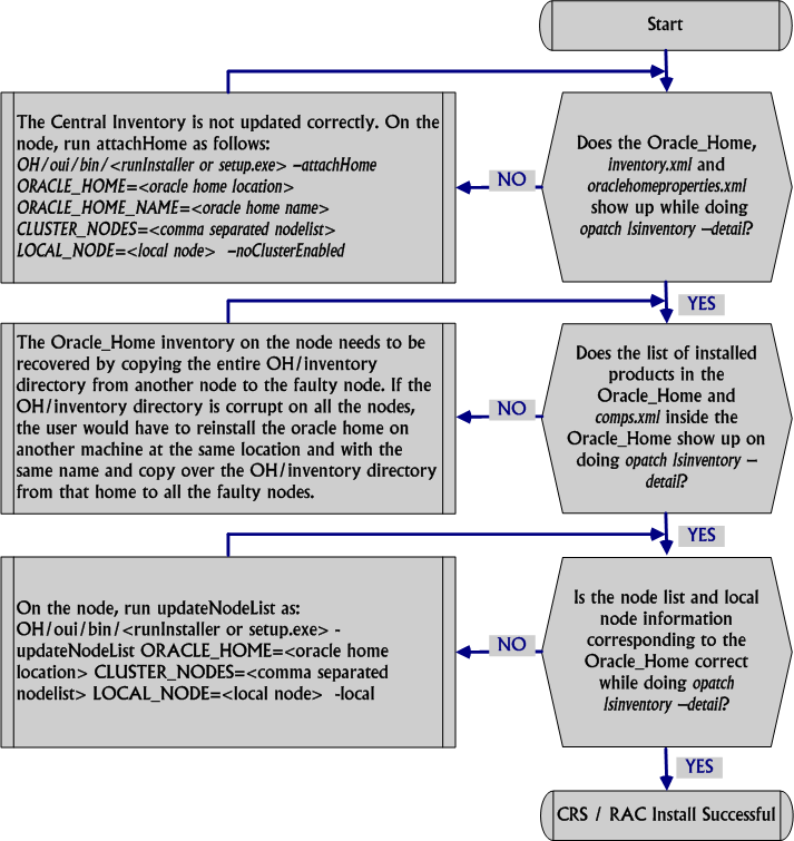

Troubleshooting Real Application Clusters / Oracle Clusterware Installation

The Oracle inventory maintains records of Oracle software versions and patches. Each installation has a Central Inventory where the Oracle home is registered. Oracle software installations have a local home directory, whose path location is recorded in the Central Inventory. The local inventory directory for each Oracle software installation contains a list of components and applied interim patches associated with that software. Because your Oracle software installation can be corrupted by faulty inventory information, the Oracle Universal Installer must perform all read and write operations on Oracle inventories. Ensure that you do not modify files in the Central Inventory or the Oracle home inventory.

After completing a Real Application Clusters installation, it is advisable that you perform the following tasks:
After your Oracle product with Real Application Clusters installation is complete, go to $ORACLE_HOME/Opatch on each node and execute the following command:
$ORACLE_HOME/OPatch/opatch lsinventory -detail
This command lists the components installed inside the Oracle home and also lists the local and remote nodes for the home. Verify this information. You may also want to look at installation logs, inventory.xml, and oraclehomeproperties.xml.
Refer to "Troubleshooting Real Application Clusters / Oracle Clusterware Installation" in case the check fails.
