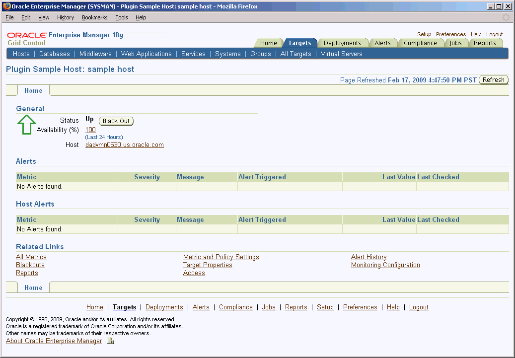

The default target home page provides basic information regarding target status such as Availability, Up/Down status, and Alerts. Depending on what level of monitoring support the Management Plug-in provides, there may be additional sections. Most all information is in tabular format.
Figure 3-1 Default Target Home Page without Charts

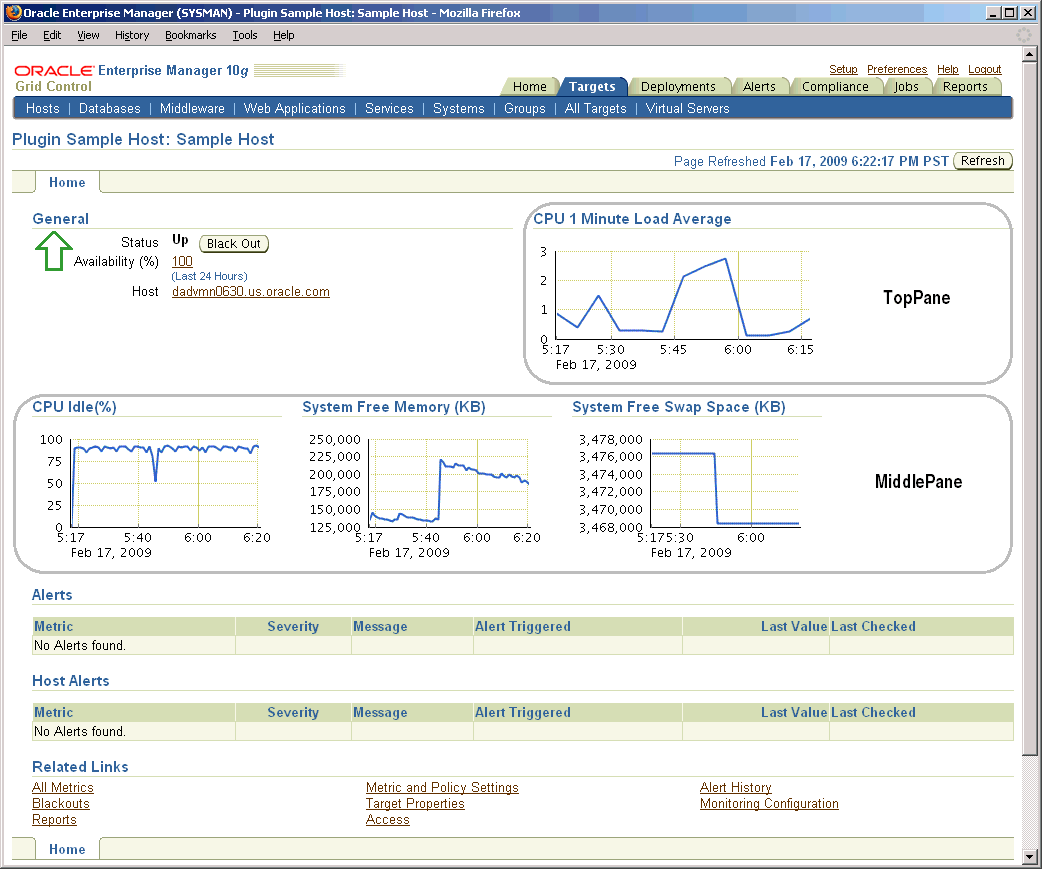

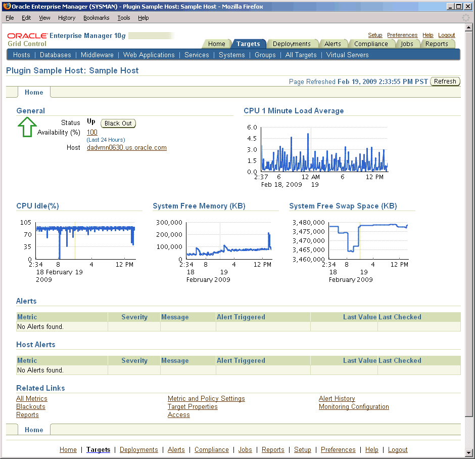

Adding charts to the target home page makes key graphical information normally found in Enterprise Manager reports readily available on the target home page.
Figure 3-2 Default Target Home Page with Charts
By adding a chart definition XML file to your Management Plug-in Archive, you will be able to specify any number of charts (pie, bar, and time series) on the target home page.

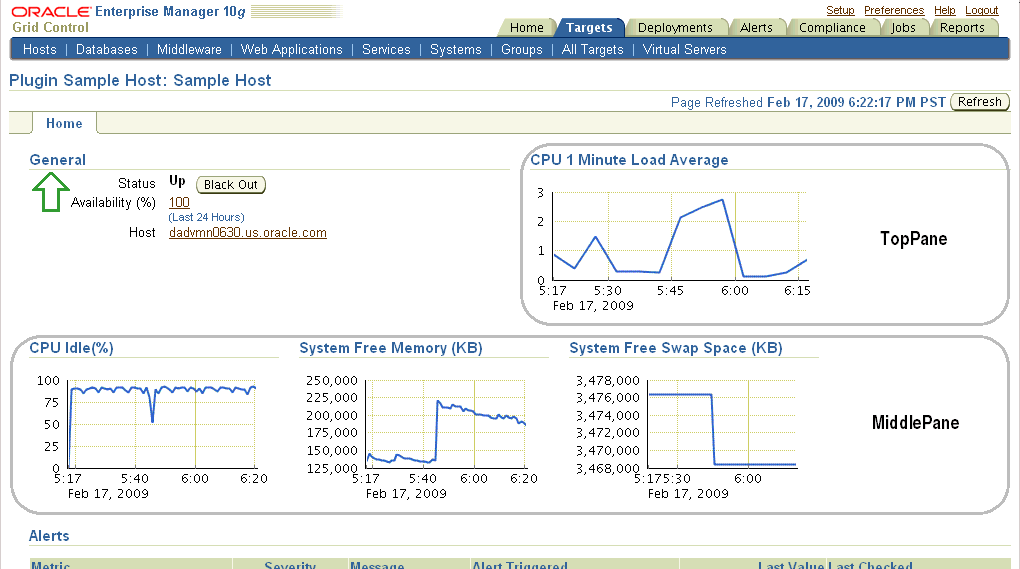

Figure 3-3 TopPane and MiddlePane Locations within the Target Home Page
Although there is no technical limit to the number of charts you can add, in practice, at most 3 - 4 charts will fit comfortably in the MiddlePane.

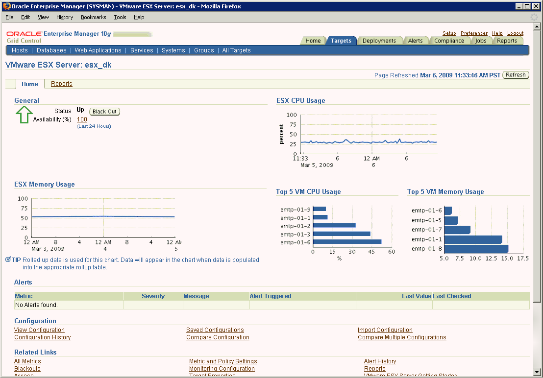

The following example demonstrates chart implementation for a VMware target type. As shown in Figure 3-5, both bar and time series charts have been created, making use of a variety of optional chart properties, such as stacked, timeGranularity, shadowEffect, xAxisLabel, yAxisLabel. The code used to define the charts is shown in Example 3-1.
Example 3-1 Home Page Charts XML for VMware
