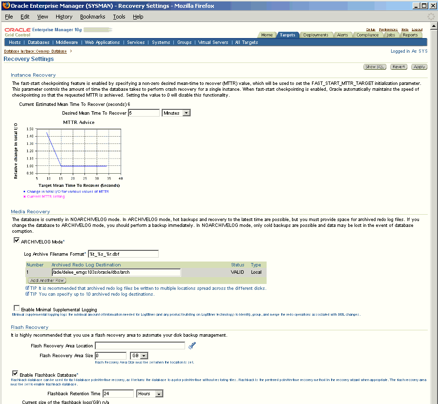

In addition to placing the Repository database in archivelog mode, you may also want to use an Oracle Flashback Database. A Flashback Database allows you to rewind an Oracle database to a previous time to correct problems caused by logical data corruptions or user errors.
Before you can enable a Flashback Database from the Enterprise Manager console, you first need to set the flashback recovery area (FRA). This involves updating the SPFILE for the Repository database and then bouncing the database in order for the changes to take affect.
To set the requisite initialization parameters:
Navigate to the Initialization Parameters page for the Repository database (Targets-->Databases--><Repository Database Target>-->Server-->Initialization Parameters).
From the SPFILE tab, set the following Backup and Recovery parameters for your environment.
db_recovery_file_dest_sizedb_recovery_file_destdb_flashback_retention_target
Bounce the Repository database.
Once bounced, the Repository database SPFILE changes will take effect and the FRA will be defined. You can then set the Flashback Database from the Enterprise Manager console by navigating to the Enterprise Manager Recovery Settings page (Targets-->Databases--><Repository Database Target>-->Availability-->Recovery Settings) and enabling Archive Logging then Flashback Database as shown in Figure 5-1.
For more information on using Flashback as part of your backup and recovery strategy, see the Oracle Database Backup and Recovery Advanced User's Guide and the Oracle Database Backup and Recovery Reference.

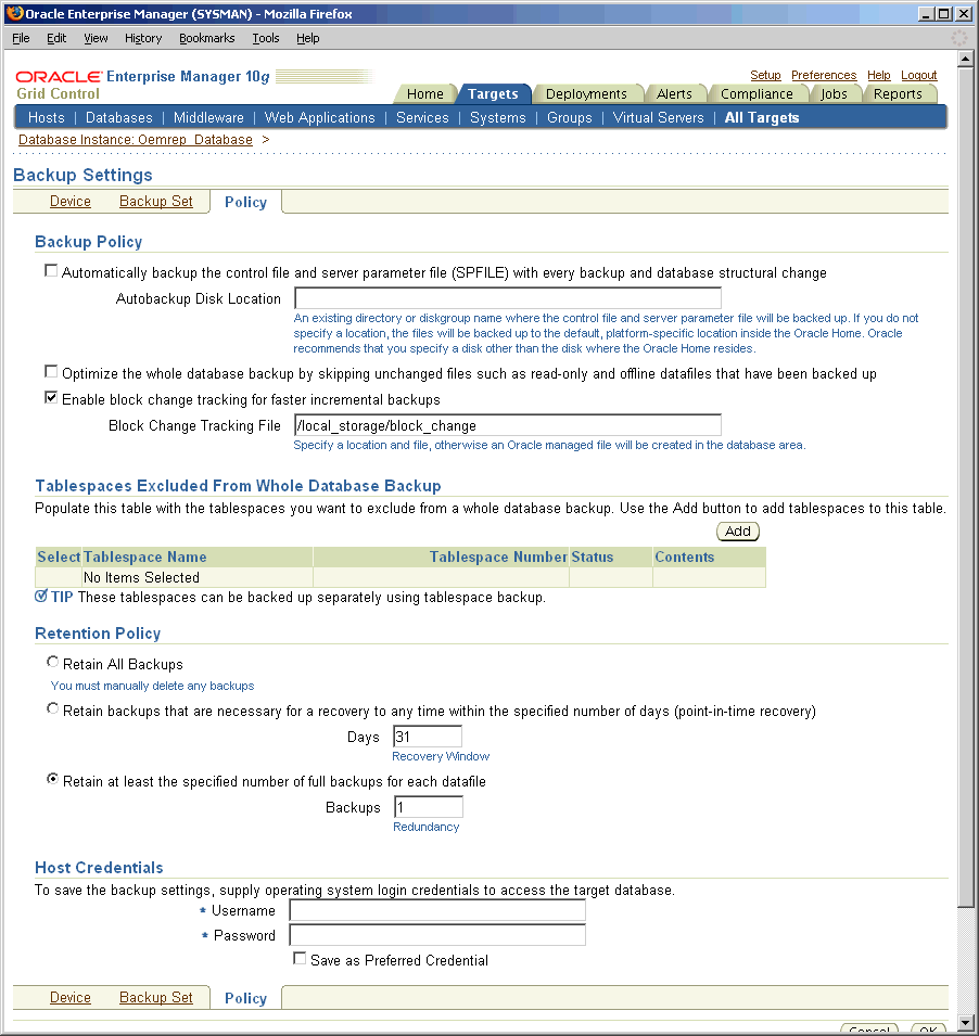

Next, navigate to the Backup Policies page (Target-->Database--><Repository Database Target>-->Availability-->Backup Settings-->Policy) and enable Block Change Tracking to speed up backup operations as shown in Figure 5-2.
A thorough summary of how to configure backups using Enterprise Manager is available in the Oracle Database 2 Day DBA guide. For additional information on Database high availability best practices, review the Oracle Database High Availability Best Practices documentation.

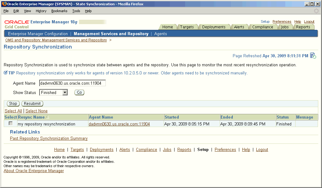

Beginning with Enterprise Manager version 10.2.0.5, a new repository resync feature allows you to automate the process of synchronizing the Enterprise Manager repository with the latest state available on the Agents. To resynchornize the repository with the Agents, you use Enterprise Manager Command-line utility (emctl) resync repos command:
emctl resync repos -full -name "<descriptive name for the operation>"
You must run this command from the OMS Oracle Home after restoring the repository but BEFORE starting the OMS. After submitting the command, start up all OMS's and monitor the progress of repository resychronization from the Enterprise Manager console's Repository Resynchronization page, as shown in Figure 5-3.
Figure 5-3 Repository Synchronization Page
Repository recovery is complete when the resynchronization jobs complete on all Agents.

The OMS detects that Agent has been re-installed and blocks the Agent.
Initiate Agent Resynchronization from the Agent homepage.
All targets in the repository are pushed to the new Agent and Agent is unblocked.

Since the OMS OracleHome is not available and repository resynchronization has to be initiated before starting an OMS against the restored repository, submit "resync" via the following PL/SQL block. Log into the repository as SYSMAN using SQLplus and run:
begin emd_maintenance.full_repository_resync('<resync name>'); end;

Initiate Repository resynchronization:
emctl resync repos -full -name "<resync name>"
from the OMS Oracle home of host "A"

Submits a repository resynchronization operation. When the –full option is specified, all agents are instructed to upload the latest state to the repository. A list of agents can be specified using the –agentlist option to resync with a given list of agents.
Usage:
emctl resync repos (-full|-agentlist "agent names") [-name "resync name"] [-sysman_pwd "sysman password"]
Aborts the currently running repository resynchronization operation. Use the –full option to stop a full repository resynchronization. Use the –agentlist option to stop resync on a list of agents.
Usage:
emctl abortresync repos (-full|-agentlist "agent names") -name "resync name" [-sysman_pwd "sysman password"]
Lists the status of given repository resynchronization operation.
Usage:
emctl statusresync repos -name "resync name"
