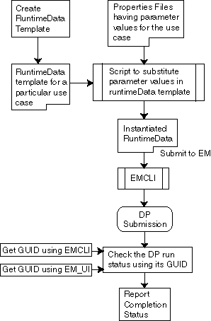

The runtime for all the deployment procedures can be automated using EMCLI and associated verbs, such as Oracle patching, OS patching and so forth. For more information on these verbs, see the Enterprise Manager Command Line Interface Guide available at:

You can provide values to various properties associated with a directive or component through Map Properties. You have three execution privileges: Normal, Sudo and PAM (Pluggable Authentication Modules) for Windows platform. You can choose the appropriate privilege you want by selecting the privilege from Execution privilege list box, under Execution Mode section.

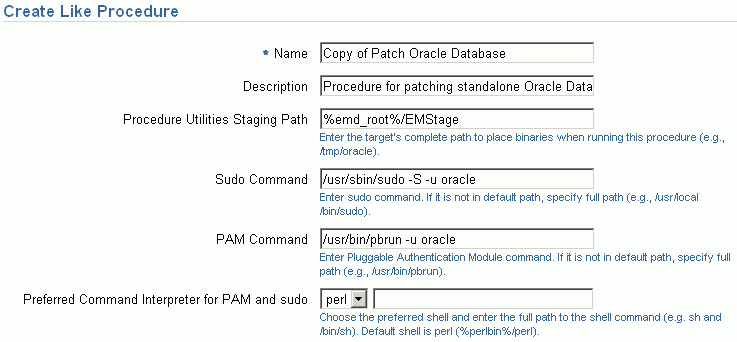

Do a 'Create Like' of the out-of-box procedures
Select the check box 'Enable Notification', and optionally provide the 'Notification Tag Name'.
Select the statuses for which you would want the notifications to be sent from the list. For example: Success, Failure, or Action Required.
Save the procedure.

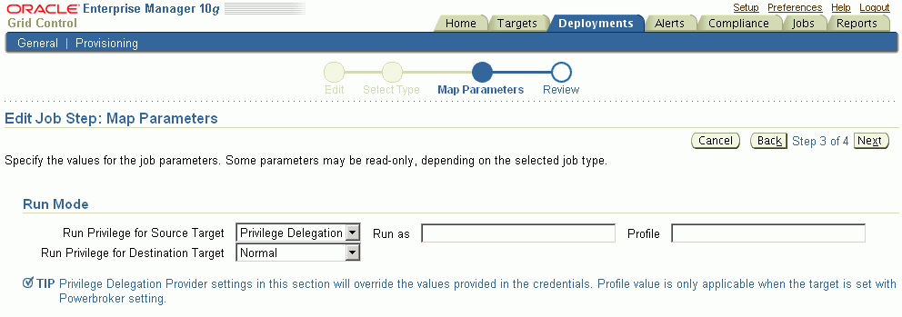

For SUDO and PowerBroker, you can specify the SUDO and PowerBroker commands to run, and also set environment variables and the preferred command interpreter for them (Figure 11-1).

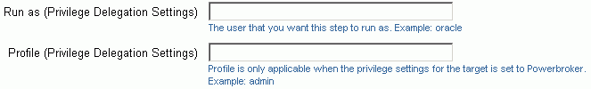

For Privilege Delegation, you can specify the user and the profile that the step must run as (Figure 11-2).

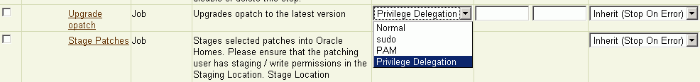

For each step, from the Run Privilege column, you can select either SUDO, PAM, or Privilege Delegation (Figure 11-3).
If you select SUDO or PAM, then in the Run Privilege Command/Privilege Delegation column, specify the Run As command. If you select Privilege Delegation, then specify the Run As value in the first text box and the Profile value in the second text box.
If you select SUDO or PAM, and leave the Run Privilege Command column blank, then the commands as set in the SUDO Command and PAM Command fields (Figure 11-1) are used. However, if you want some steps to override these globally declared commands, then in the Run Privilege Command column for that step, specify the commands that need to be used instead. If these settings are not made, then the Run As and Profile values specified along with preferred credential are used.See Also:

The process to use EMCLI to execute deployment procedures is depicted in Figure 11-5.
Figure 11-5 EMCLI Process to Execute Deployment Procedures
There are four required actions to execute deployment procedures. Those steps are described below:
Step 1: Find the GUID of the procedure to be executed using EMCLI. This is a one-time activity.
Step 2: Obtain the RuntimeData xml or RuntimeData template for the procedure that needs to be executed. This is also a one-time activity.
Step 3: Create the properties file for the RuntimeData xml or RuntimeData template. This step is required for each execution of the procedure.
Step 4: Submit the RuntimeData template or RuntimeData, properties file for the given execution and procedure GUID as input to an out-of-box script that will generate a new runtime data response file and then use this response file to execute the procedure using EMCLI.

Once the RuntimeData template or RuntimeData xml and properties file are ready then the procedure can be executed using the following script.
Usage:
perl executeDP.pl -t <template> -p <properties file name> -g <DP GUID> [-s <schedule> in the format yyyy/MM/dd HH:mm] [-z <time zone ID>] [-d <emcli directory path>, mandatory if emcli executable is not in the current directory]
Template -- The name of the RuntimeData template for out-of-box procedures or location of the RuntimeData xml file downloaded after the execution of a customized procedure.
Properties file name -- The location of the properties file created for executing the procedure.
DP GUID -- The GUID of the procedure that needs to be executed.
emcli Directory -- The directory which contains the EMCLI executable. If the current working directory contains the EMCLI executable, this parameter is optional.
Schedule -- The time when the deployment procedure would be scheduled to run. If not specified it defaults to running the deployment procedure immediately. The HH:MM is based on 24 hrs clock, for example, 22:30.
Time Zone ID -- The time zone to which the deployment procedure run is scheduled. If not specified it defaults to the time zone of the OMS.
Below is a sample code string executing RAC provisioning procedure for UNIX using out-of-box procedure:
perl executeDP.pl -t crsasmrac_gold_prov_template.xml -p Properties.txt -g 31ABCFF2199BB77990B057AC4A442DAC -t 2007/02/03 10:00 -z Americas/New_York -d /oracle/prod/orahome/
The following parameter descriptions apply to the script:
crsasmrac_gold_prov_template.xml is the name of the out-of-box template.
Properties.txt is the properties file
31ABCFF2199BB77990B057AC4A442DAC is the GUID for the RAC provisioning procedure for UNIX
2007/02/03 10:00 is the date and time during which the Deployment Procedure is scheduled to run.
Americas/New_York is the Time Zone ID for which the time schedule is set.
/oracle/prod/orahome/ is the directory location for the EMCLI executables.
The properties file and the out-of-box template are located in the same directory as the executed script.
Below is a sample code string executing SIDB patching for UNIX using an out-of-box procedure:
perl executeDP.pl patch_standalone_DB.xml Properties.txt 2EECED3592A0175FE040578CE808291F
patch_standalone_DB.xml is the name of the out-of-box template.
Properties.txt is the properties file.
2EECED3592A0175FE040578CE808291F is the GUID for the Single Instance Database patching procedure for UNIX.
The templates, properties file, and the EMCLI executables are located in the same directory as the executed script. Also, the deployment procedure is scheduled to run immediately in the time zone of the OMS.
