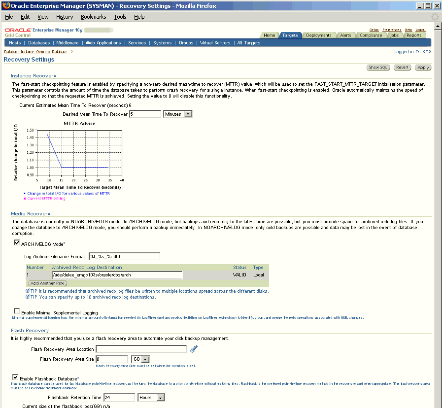

Database should be in archivelog mode. Not running the repository database in archivelog mode leaves the database vulnerable to being in an unrecoverable condition after a media failure.

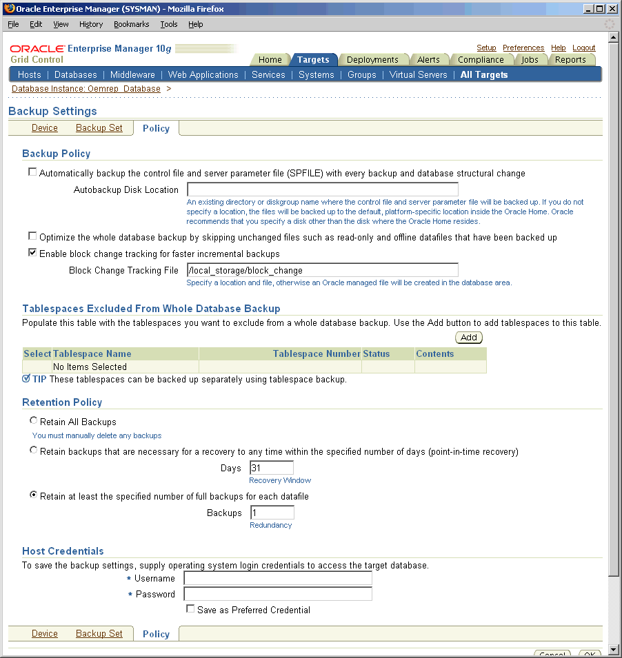

Perform regular hot backups with RMAN using the Recommended Backup Strategy option via the Enterprise Manager console. Other utilities such as DataGuard and RAC can also be used as part of a comprehensive strategy to prevent data loss.
Adhering to these strategies will create a full backup and then create incremental backups on each subsequent run. The incremental changes will then be rolled up into the baseline, creating a new full backup baseline.
Using the Recommended Backup Strategy also takes advantage of the capabilities of Enterprise Manager to execute the backups: Jobs will be automatically scheduled through the Job sub-system of Enterprise Manager. The history of the backups will then be available for review and the status of the backup will be displayed on the repository database target home page. This backup job along with archiving and flashback technologies will provide a restore point in the event of the loss of any part of the repository. This type of backup, along with archive and online logs, allows the repository to be recovered to the last completed transaction.
First, navigate to the Enterprise Manager Recovery Settings page (Target-->Database--><Repository Database Target>-->Availability-->Recovery Settings) and enable Archive Logging then Flashback Database as shown in Figure 9-1.
Next, navigate to the Backup Policies page (Target-->Database--><Repository Database Target>-->Availability-->Backup Settings-->Policy) and enable Block Change Tracking to speed up backup operations as shown in Figure 9-2.
A thorough summary of how to configure backups using Enterprise Manager is available in the Oracle Database 2 Day DBA guide. For additional information on Database high availability best practices, review the Oracle Database High Availability Best Practices documentation.

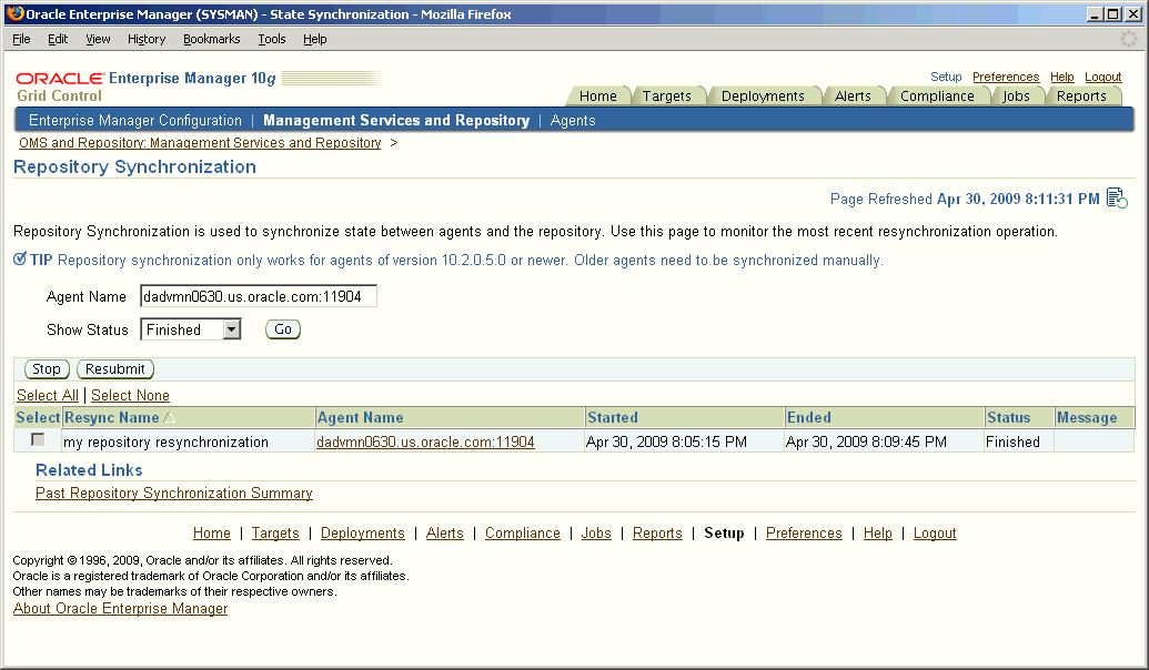

Beginning with Enterprise Manager version 10.2.0.5, a new repository resync feature allows you to automate the process of synchronizing the Enterprise Manager repository with the latest state available on the Agents. To resynchornize the repository with the Agents, you use Enterprise Manager Command-line utility (emctl) resync repos command:
emctl resync repos -full -name "<descriptive name for the operation>"
You must run this command from the OMS Oracle Home after restoring the repository but BEFORE starting the OMS. After submitting the command, start up all OMS's and monitor the progress of repository resychronization from the Enterprise Manager console's Repository Resynchronization page, as shown in Figure 9-3.
Figure 9-3 Repository Synchronization Page
Repository recovery is complete when the resynchronization jobs complete on all Agents.

The OMS detects that Agent has been re-installed and blocks the Agent.
Initiate Agent Resynchronization from the Agent homepage.
All targets in the repository are pushed to the new Agent and Agent is unblocked.

OMS detects that Agent has been restored from backup and blocks the Agent

Initiate Repository resynchronization:
emctl resync repos -full -name "<resync name>"
from the OMS Oracle home of host "A"

Submits a repository resynchronization operation. When the –full option is specified, all agents are instructed to upload the latest state to the repository. A list of agents can be specified using the –agentlist option to resync with a given list of agents.
Usage:
emctl resync repos (-full|-agentlist "agent names") [-name "resync name"] [-sysman_pwd "sysman password"]
Aborts the currently running repository resynchronization operation. Use the –full option to stop a full repository resynchronization. Use the –agentlist option to stop resync on a list of agents.
Usage:
emctl abortresync repos (-full|-agentlist "agent names") -name "resync name" [-sysman_pwd "sysman password"]
Lists the status of given repository resynchronization operation.
Usage:
emctl statusresync repos -name "resync name"
