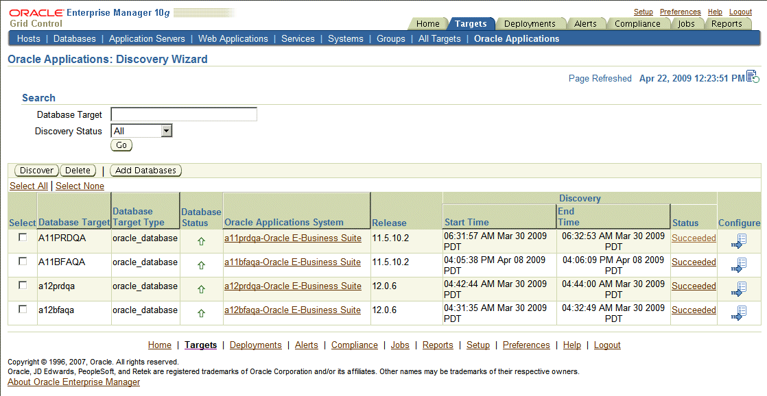

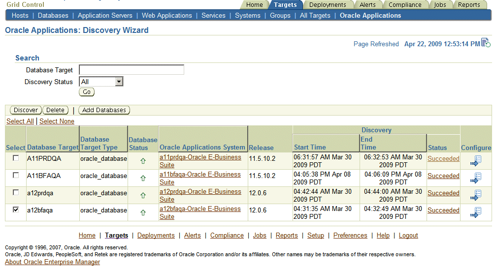

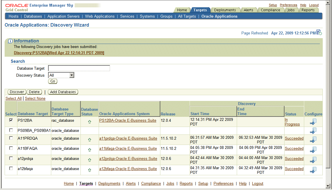

Discovery Wizard is a dashboard to track, plan, log and customize Oracle E-Business Suite discovery jobs.

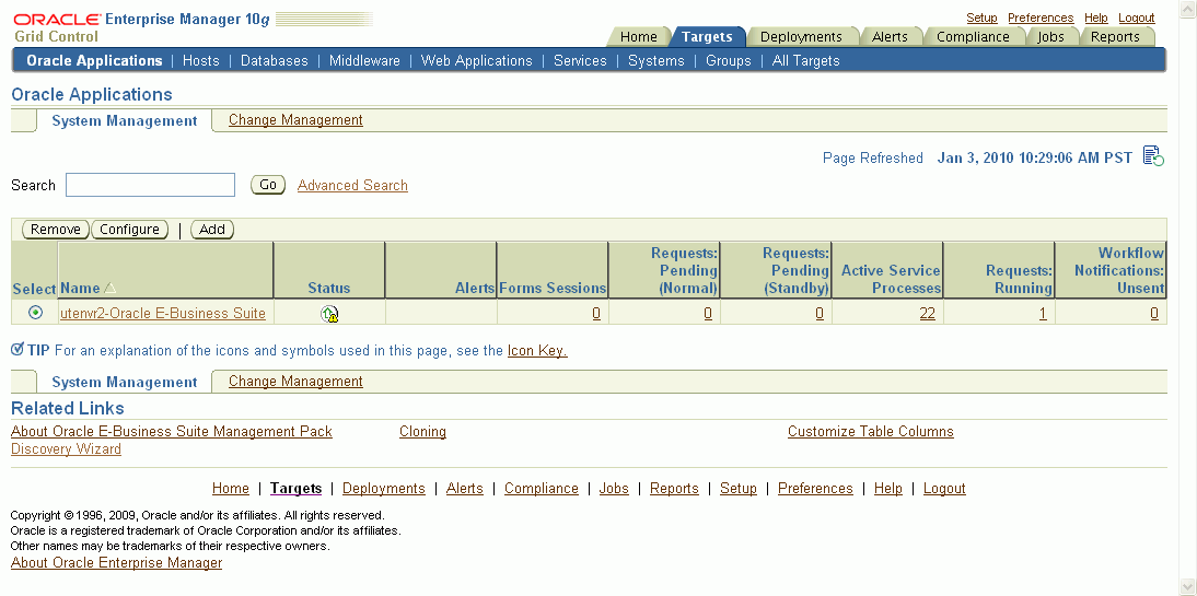

The Discovery Wizard can be accessed by:

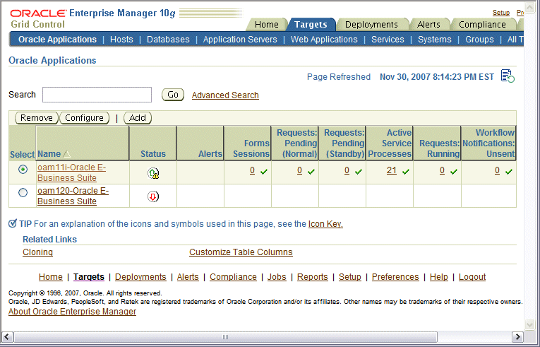

Click on the Discovery Wizard link under "Related Links" from the System Management Dashboard or Change Management Dashboard.
From the System Management dashboard, click the Add button to add a new Applications System and click Custom Discovery.

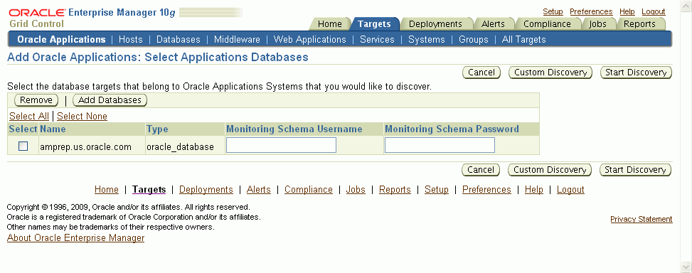

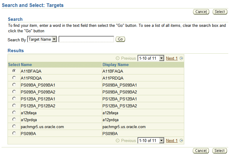

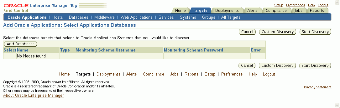

From the Discovery Wizard, you can add a database to the system using the Add Databases button.
Use the Add Databases button to select your database target.
Once added, the database target appears in the table. Select the Application Database Targets you want to discover and click the Start Discovery button.
You can also start the registration process from the Oracle Applications subtab by clicking the Add button on the System Management dashboard.
You can then use the Add Database button to add an additional Oracle E-Business Suite database target to be discovered. In the case of an Oracle E-Business Suite instance deployed on a Real Application Clusters (RAC) database, select the Cluster Database Target for Discovery.

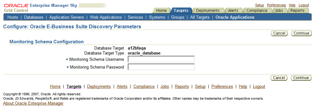

After choosing the relevant databases, enter the schema details and the application access details of the monitoring systems.
Note: If you had selected two or more database targets in the main Discovery Wizard page, you must enter credentials for all of them on this page, even if you do not select them all here.
For Monitoring Schema and Monitoring Schema Password, enter the schema username and password for the Oracle E-Business Suite database that can be used by the management pack for monitoring.

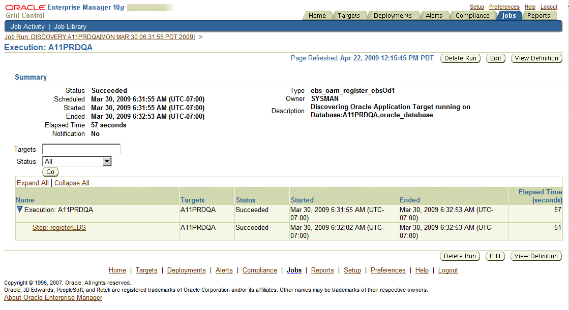

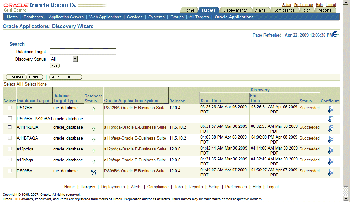

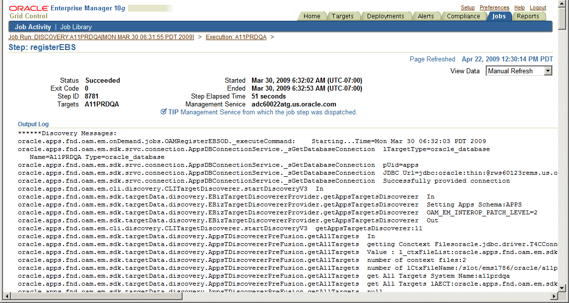

After the system starts a job to discover the Oracle E-Business Suite you can check its status on the main Discovery Wizard page.
You can view details on the job on the Discovery Wizard main page by clicking the status link. After gathering the inputs from the user (to register Oracle Application Instance with Grid Control), the discovery job connects to the Oracle E-Business Suite database and retrieves the configuration information. Grid Control then registers the various target types for the Oracle E-Business Suite system and starts capturing the metrics.
To learn more about a particular step in the discovery job's execution, click on the linked name of the step.

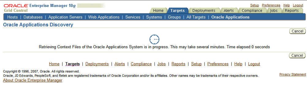

On the next page, enter application access details of the monitoring system. For Monitoring Schema Username and Monitoring Schema Password, enter the schema username and password for the Oracle E-Business Suite database that can be used by the management pack for monitoring. Click Continue.
The system then retrieves context files of the Oracle E-Business Suite system.

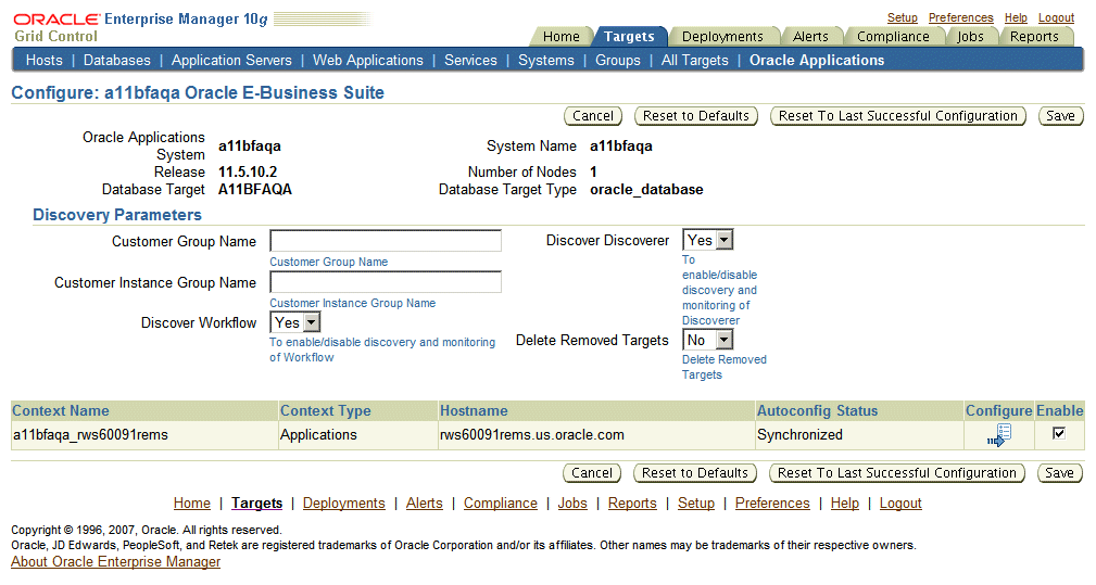

The Configure page allows you to update instance-level discovery parameters, as well as context-level parameters at the bottom of the page. To set context-level parameters, use the icon in the Configure column for the specified context.
Configure Page for a Release 12 System
Configure Page for a Release 11i System

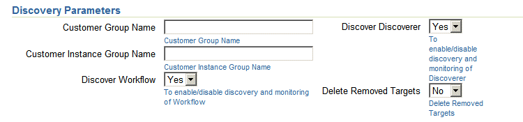

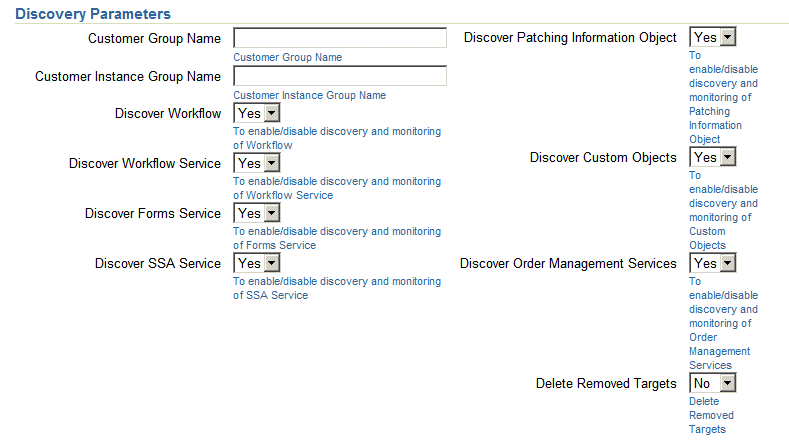

The following parameters of discovery can be customized.
| Parameter Name | Description | Default Value |
| Customer Instance Group Name | All targets discovered for this instance will be grouped under this group. This group will be added to Group: Customer Group Name. | No value. |
| Customer Group Name | If Customer Instance Group Name is provided all the targets discovered for this instance and the Customer Instance Group Name will be added to this group. | No value. |
| Discover Workflow | Disable/Enable Monitoring of the Oracle Workflow component. | Yes |
| Discover Workflow Service | Disable/Enable creation of the Oracle Workflow service. | Yes |
| Discover Forms Service | Disable/Enable creation of the Oracle Forms service. | Yes |
| Discover SSA Service | Disable/Enable creation of the Self-Service Applications (SSA) Service. | Yes |
| Discover Patching Information Object | Disable/Enable Discovery of the Patching Information Object. This target is essential for any Oracle E-Business Suite patching application and should be enabled if any patching applications are used with this Instance. | Yes |
| Discover Custom Objects | Disable/Enable Discovery of customs objects configuration. | Yes |
| Discover Order Management Services | Disable/Enable Monitoring of Order Management services (out-of-box services). | Yes |
| Delete Removed Targets | All targets which are dissociated from the Applications System will be deleted from the EM Repository if is this option is set to ‘Yes'. | No |
| Customer Instance Group Name | All targets discovered for this instance will be grouped under this group. This group will be added to Group: Customer Group Name. | No value |
| Customer Group Name | If Customer Instance Group Name is provided all the targets discovered for this instance and the Customer Instance Group Name will be added to this group. | No value |
| Discover Workflow | Disable/Enable monitoring of the Oracle Workflow component. | Yes |
| Discover Discoverer | Disable/Enable monitoring of the Discoverer component. | Yes |
| Delete Removed Targets | All targets which are dissociated from the applications system will be deleted from EM Repository if is this option is set to ‘Yes'. | No |
All contexts (nodes) that belong to the Oracle E-Business Suite are shown in this table. You can click the Configure icon for each individual context to set context-level parameters.
Once you have entered parameter values, you can do the following:
Save - This option saves your changes to the EM Repository.
Reset to Last Successful Configuration - This option resets the values to those that were used during the last successful discovery.
Reset to Defaults - This option sets the parameters to the default values.
Cancel - This option cancels your changes.

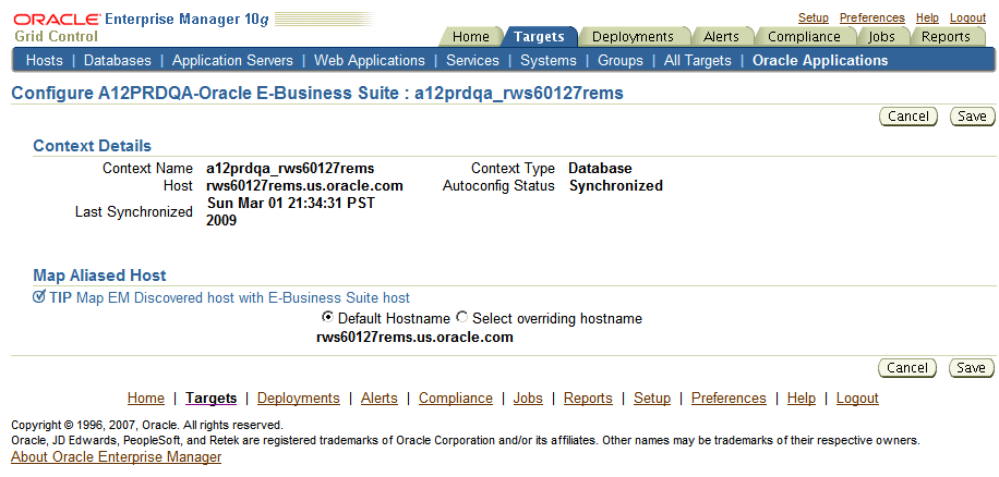

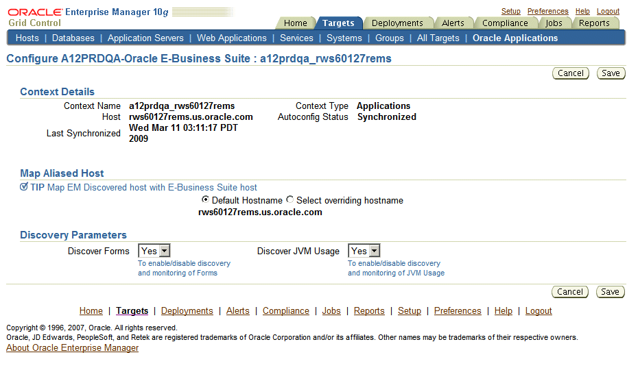

Context details are retrieved from context files. There is a Database Context page applicable to both Release 11i and Release 12, and different Applications Context pages for Release 11i and Release 12.
The Mapped Alias Host configuration information can be used in case of host aliasing to select Host Target registered with Enterprise Manager for this context.
Database Context Page for Releases 11i and 12
Applications Context Page for Release 11i
Applications Context Page for Release 12
| Discover Forms | Enable/Disable discovery of the Oracle Forms target for this context. | Yes |
| Discover JVM Usage | Enable/Disable discovery of the JVM Usage target. This option will not affect rediscovery of the applications system. | Yes |

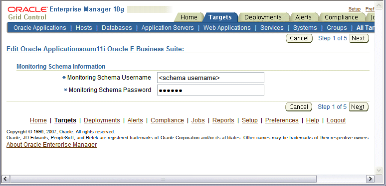

You can review and edit the monitoring schema information on this page.
Monitoring Schema Username - This is the name of the Monitoring schema in your Oracle Applications database. Enterprise Manager will connect to this schema to collect certain system metrics.
Monitoring Schema Password - This is the password of the Monitoring schema in your Oracle Applications database.
After you have reviewed the required information, click Next to continue.

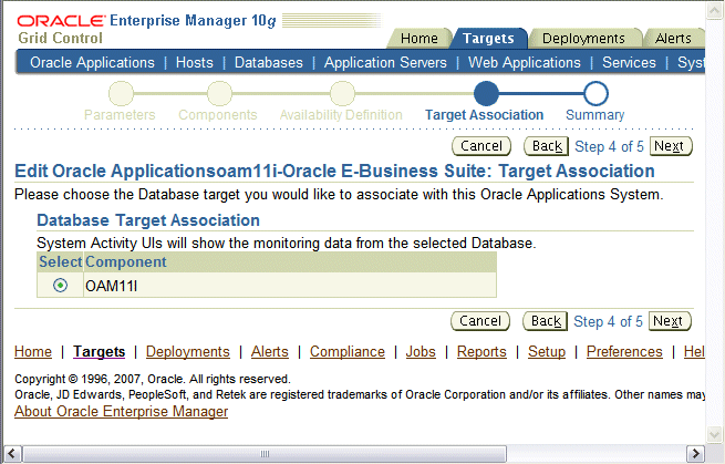

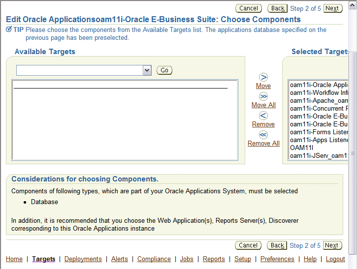

In this page, the registered Grid Control targets can be associated with the Oracle E-Business Suite system. These can include HTTP Servers, Oracle Forms listeners, databases, or any other targets registered in Grid Control. You will be able to monitor the status of these targets in the Oracle Applications pages, and you will later be given the option of defining the availability of the Oracle E-Business Suite system as a function of these targets.
Note: This page will attempt to automatically identify your Oracle E-Business Suite database and add it to the Selected Targets list. If the page cannot automatically match the database connection information that you provided to a registered target in Grid Control, then you will receive a warning, and you will need to add the correct database to the Selected Targets list manually.
To add a registered target to the Selected Targets list, choose the target type (for example, Database, Forms Listener for Oracle Applications Release 11i) and click Go. Select the appropriate target(s) from the Available Targets list, and click Move.
Once the Selected Targets List is complete, click Next to continue.

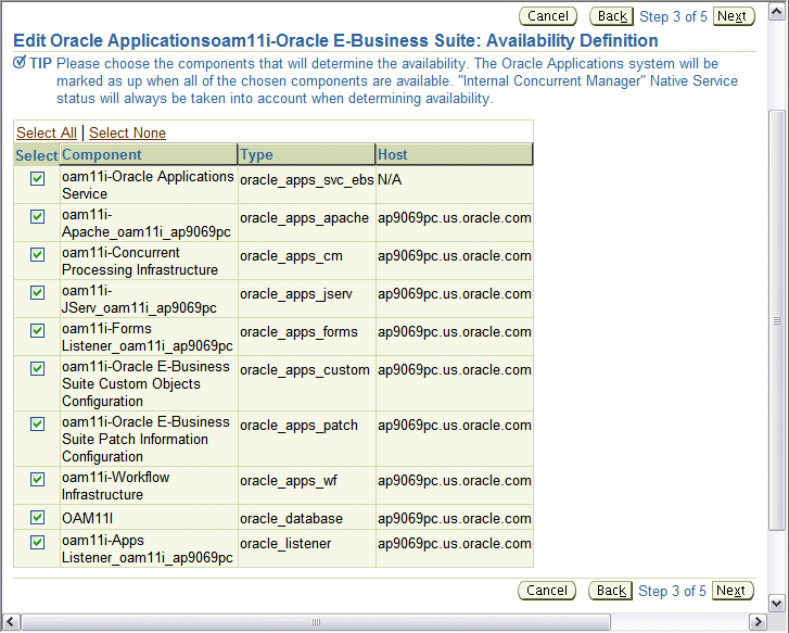

This page allows you to define the availability of your Oracle E-Business Suite system as a function of the availability of its member targets. Each selected target is included in the availability calculation for the Oracle E-Business Suite system. Any targets that are not selected are excluded from the availability calculation for the Oracle E-Business Suite system. The availability of the Oracle E-Business Suite system is calculated as described in the following table:
| Selected Targets’ Status | Oracle E-Business Suite System Status |
| All Up | Up |
| One or more Up | Partially Up |
| All Down | Down |
Once you have selected the appropriate targets, click Next to continue.

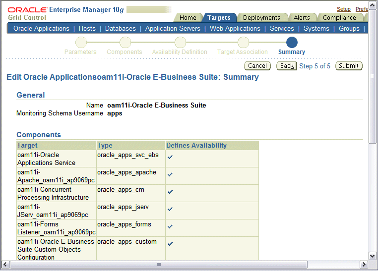

This page summarizes the configuration information for your Oracle E-Business Suite system. Click Next to complete configuring the Oracle Application system.

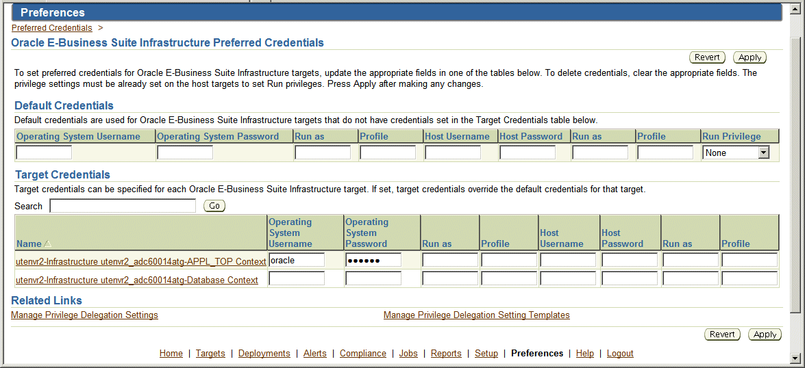

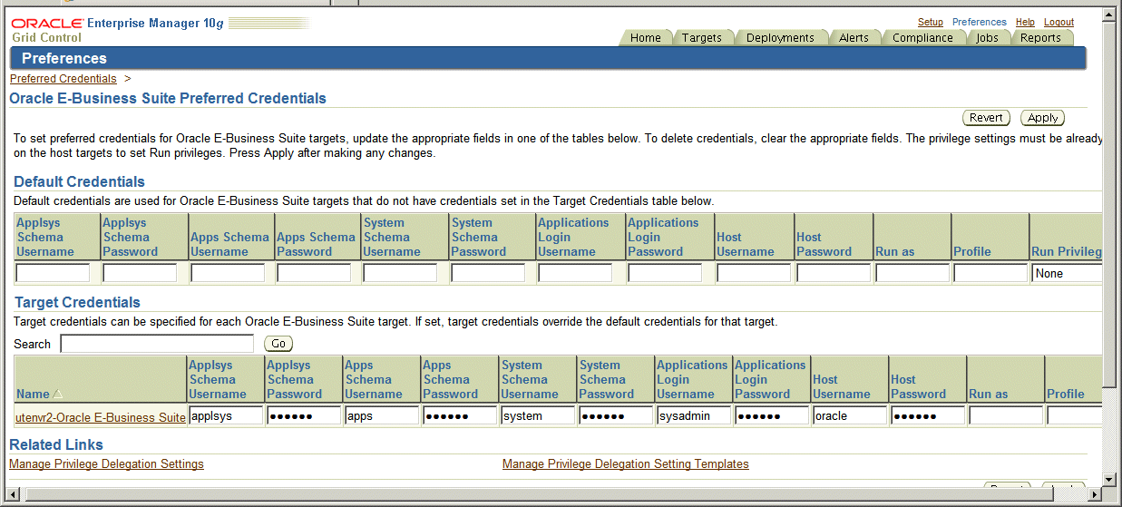

Oracle E-Business Suite administration uses preferred credentials for connecting to the System and executing various commands. Before managing an Oracle E-Business Suite instance from the Administration Dashboard, the Preferred Credentials must be set for the specific Oracle E-Business Suite target and Oracle E-Business Suite Infrastructure target of the specific node. Applications Schema Credentials need to be set for only those targets whose administration requires Applications Schema Credentials.
To set these credentials, navigate to Preferences (global link) > Preferred Credentials in Oracle Enterprise Manager.
Setting Credentials for the Oracle E-Business Suite Infrastructure Target
Setting Credentials for the Oracle E-Business Suite Target
