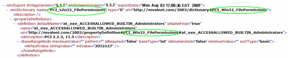

Step 2: Change the Dictionary Name
Edit the exported XML file to change the dictionary name and URI dictionary references:
In an XML or a text editor, open the exported dictionary XML file.
Change the dictionary name to your custom name in the mvDictionary name tag and in the URI value immediately following.
Change the dictionary name as specified in the URI value in each definition tag that appears in the file. Effectively, there is a tag for each property name value pair.
Save the file in XML format as the same name of your custom dictionary.
The graphic below illustrates which values (circled in green) to edit:
