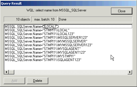

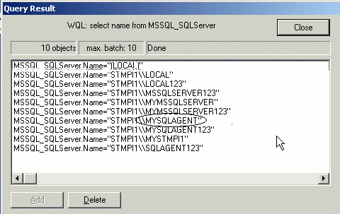

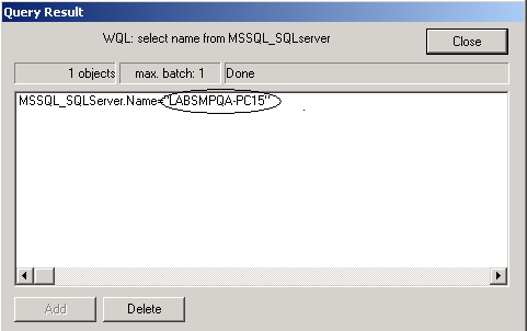

In the case of a default SQL Server instance, the name might be displayed in either of the ways listed in the table.
On the SQL Server task bar, go to Start, then click Run.
Type wbemtest in the Open field.
Click OK.
The Windows Management Instrumentation Tester dialog box appears.
In the Name Space text box, type root\MicrosoftSQLServer.
You might encounter the WMI error "0x8004100e" or "Invalid Namespace" if the namespace root\MicrosoftSQLServer is not enabled. For details, refer "Prerequisites".Click Login.
In the Windows Management Instrumentation Tester dialog box, click Query.
The Query dialog box appears.
Type the following query in the Query text box:
select name from MSSQL_SQLServer
Click Apply.
All the SQL Server instances available on the system are displayed.

Nondefault SQL Server Instance
The highlighted SQL Server instance is nondefault. The name displayed is MYSQLAGENT. Therefore specify MYSQLAGENT as the SQL Server Name.
Default SQL Server Instance: (LOCAL)
The highlighted SQL Server instance is default and the name displayed is (LOCAL). Therefore specify (LOCAL)as the SQL Server Name.
Default SQL Server Instance: SQL Server Machine Name
The highlighted SQL Server instance is default. The name displayed is the SQL Server Machine name. Therefore, specify the SQL Server Machine name as the SQL Server Name.
