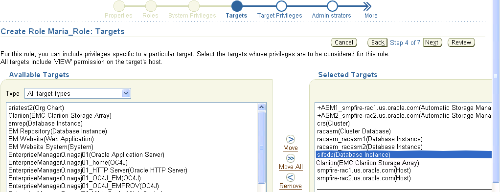

When the newly created administrator logs in, unlike SYSMAN, the administrator is restricted by the privileges set.
Susan, the super administrator wants to let Maria view target database instance sifsdb.
When Maria accesses the reports, if privileges are not set for Maria to view database target, the rows for sifsdb will not be displayed in the report. Therefore, for Maria to view sifsdb, Susan has to set privileges as illustrated below:
Susan launches Enterprise Manager Grid Control and then in the Setup page, selects Roles.
She uses the Create Roles page to create a role for assigning to Maria.
In the Create Role Properties page, she specifies the name of the role as Maria_Role.
In the Create Role: Roles page, she chooses an existing role for Maria.
In the Create Roles System Privileges page, she chooses the system privileges for Maria.
In the Create Roles Targets page (Figure 1) Susan selects the target sifsdb from the list of Available Targets.

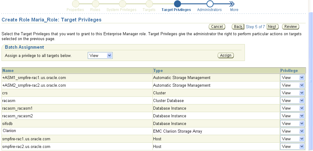

In the Create Role Target Privileges page (Figure 2) she selects View privileges for the role, so that Maria (when assigned with this role) has the rights to view the target.

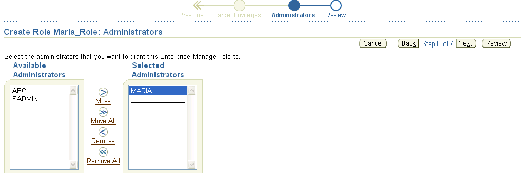

In the Create Role Administrator page (Figure 3) she grants Maria the role.
