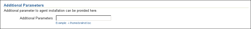

The additional parameters that you specify during the agent installation using the Agent Deploy application depend on the software source location that you have selected.
If you select the default source software location, you must specify additional parameters that are supported by the agentDownLoad script. See Table H-1 for a list of parameters supported by this script.
If you select an alternative location, you must specify additional parameters that are supported by Oracle Universal Installer (OUI). See Table H-2 for a list of parameters supported by OUI.
Also, if you cloning a Management Agent using the Agent Clone Wizard, you must specify additional parameters that are supported by OUI. See Table H-2 for a list parameters supported by OUI.
If the same parameters that you specify here are also specified independently (from the command-line option), the value of the parameters that you specify here take precedence over the other.For example, if the installation base directory is specified independently, and -b option is specified here, the latter value (-b) is used in the installation.
Table H-1 lists the possible parameters that you can specify if you select the default (Management Service) location. If you are decide to specify more than one parameter, then separate them with a white space.
