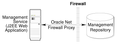

Firewalls Between the Management Service and the Management Repository

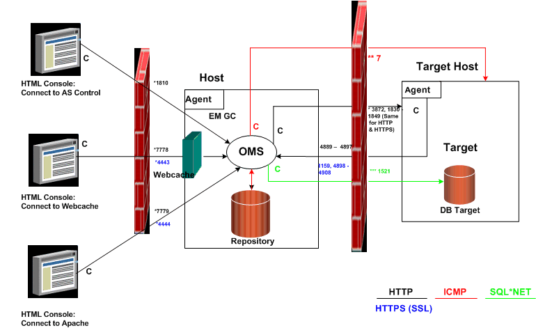

Figure 19–1 provides a topology of an Enterprise Manager grid environment that is using a firewall, and also illustrates the default ports that can be used.
Figure 19-1 Firewall Port Requirements (Default)
The conventions used in the preceding illustration are as follows:
| Convention | Description |
C |
Is the entity that is making the call. |
Enterprise Manager will default to the first available port within an Enterprise Manager set range. |
Enterprise Manager will default to the first available port. |
Are the Database listener ports. |
The direction of the arrows specify the direction of ports.
Port 1159, 4898-4989 specify that 1159 is the default. If this port is not available, the Management Service will search in the range that is specified.

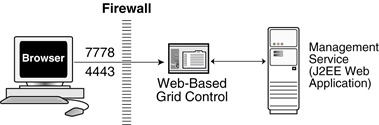

Connections from your browser to the Oracle Enterprise Manager 10g Grid Control Console are performed over the default port used for your Oracle HTTP Server.
For example, the default, non-secure port for the Oracle HTTP Server is usually port 7778. If you are accessing the Grid Control Console using the following URL and port, then you must configure the firewall to allow the Grid Control Console to receive HTTP traffic over port 7778:
http://mgmthost.acme.com:7778/em
On the other hand, if you have enabled security for your Oracle HTTP Server, you are likely using the default secure port for the server, which is usually port 4443. If you are accessing the Grid Control Console using the following URL and port, then you must configure the firewall to allow the Grid Control Console to receive HTTP traffic over port 4443:
https://mgmthost.acme.com:4443/em
Figure 19-2 shows the typical configuration of a firewall between your browser and the Grid Control Console Web-based console that is rendered by the Management Service.
Figure 19-2 Firewall Between Your Browser and the Grid Control Console

Figure 19-8 Firewall Between the Management Service and the Management Repository

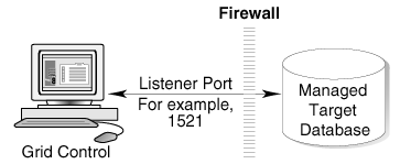

When you are using the Grid Control Console to manage a database, you must log in to the database from the Grid Control Console in order to perform certain monitoring and administration tasks. If you are logging in to a database on the other side of a firewall, you will need to configure the firewall to allow Oracle Net firewall proxy access.
Specifically, to perform any administrative activities on the managed database, you must be sure that the firewall is configured to allow the Oracle Management Service to communicate with the database through the Oracle Listener port.
You can obtain the Listener port by reviewing the Listener home page in the Grid Control Console.
Figure 19-9 shows a typical configuration of a firewall between the Management Service and the Management Repository.
Figure 19-9 Firewall Between the Grid Control and a Managed Database Target
