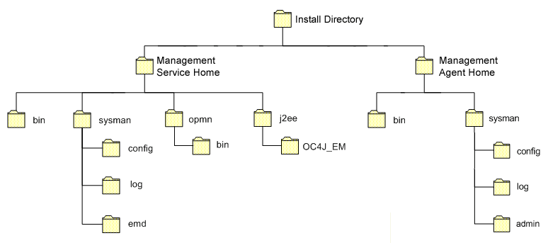

When you install Oracle Enterprise Manager 10g Grid Control, you can select from four installation types. All of these installation types, except the Oracle Management Agent installation type, install the Oracle Management Service.
When you install the Oracle Management Service, you actually install three Oracle home directories:
The Management Service home directory
The Management Agent home directory
The Database home directory
When you install Oracle Enterprise Manager 10g Grid Control, Oracle Database is also installed, but will not contain Enterprise Manager Configuration Assistant (EMCA) in the Oracle Database Home.The Oracle Management Service is a J2EE application in the form of an OC4J instance (OC4J_EM) that is installed and deployed using the Oracle Application Server J2EE and Web Cache installation type.
The installation procedure installs the Enterprise Manager components within the Oracle Application Server Home, including the Oracle Management Service.
Information about the directories that are specific to the Oracle Application Server installation can be found in the Oracle Application Server documentation. For example, the location of the most of the Oracle Application Server configuration and log files are described in the Oracle Application Server documentation.
See Also:
"Configuration Files and Log Files" in the Oracle Application Server Administrator's GuideIn addition to the Management Service home directory, the installation procedure installs the Oracle Management Agent that is used to gather management data and perform administration tasks for the targets on the Management Service host.
By default, if the Oracle Universal Installer (or the account used to run the Universal Installer) has the proper privileges to write to the install directories, the Management Agent is installed in a separate Oracle home directory at the same level as the Oracle Application Server home directory.
However, if the Oracle Universal Installer does not have the necessary privileges, the Management Agent is installed in a subdirectory of the Oracle Application Server home directory.
Figure 16-1 shows some of the important directories you should be familiar with in a typical Grid Control Console installation. You can use this information as you begin to maintain, troubleshoot, and configure the Oracle Management Service installation.
Figure 16-1 Important Oracle Management Service Installation Directories
Table 16-1 describes in more detail the Management Service directories shown in Figure 16-1. In the table, ORACLE_HOME refers to the Management Service home directory in which the Oracle Management Service is installed and deployed.
Table 16-1 Important Directories in the Management Service Oracle Home
| Directory | Description |
The Use the |
The Note that the |
This directory contains files used to control the Oracle Process Manager and Notification Server (OPMN) utility. OPMN can be used to start and stop the instances of Oracle Application Server Containers for J2EE (OC4J) associated with this instance of Oracle Application Server. The Oracle Management Service runs as an application in one of those OC4J instances. |
This directory contains the files associated with the OC4J instances running in this instance of Oracle Application Server. For example, you will notice a directory for the OC4J_EM instance, which is the OC4J instance used to deploy the Management Service J2EE Web application. |
ORACLE_HOME/hostname |
For real application cluster agent install, this directory contains sysman files. |

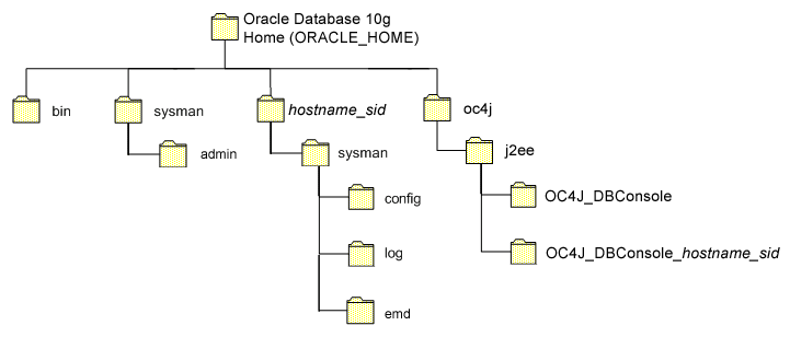

When you install Oracle Database 10g, you also install Oracle Enterprise Manager 10g Database Control. Database Control provides the tools you need to manage your Oracle Database 10g immediately after you install the database. As a result, the Oracle Database 10g installation procedure installs a set of Enterprise Manager directories and files into each Oracle Database 10g home directory.
In particular, the emctl commands required to control Database Console are installed into the ORACLE_HOME/bin directory.
The Management Agent and Management Service support files are installed in two locations in an Oracle Database 10g installation:
Files that are common and shared among all instances of the database are stored in the following directory of the Oracle Database 10g home:
ORACLE_HOME/sysman
For example, the administration files, which define the supported target types and the scripts used to perform Management Agent configuration tasks are stored in the ORACLE_HOME/sysman/admin directory.
Files that are unique to each instance of the database are stored in following directory of the Oracle Database 10g home:
ORACLE_HOME/hostname_sid/ (for a single instance database) ORACLE_HOME/nodename_sid/ (for a cluster database)
Throughout the rest of this guide, ORACLE_HOME/hostname_sid/ and ORACLE_HOME/nodename_sid/ may be used interchangeably. Both paths refer to the same concept – the Enterprise Manager directory for the specific database instance. The difference is that ORACLE_HOME/hostname_sid/ is used for single instance databases, while ORACLE_HOME/nodename_sid/ is used for cluster (Oracle RAC) databases. In cluster databases, nodename refers to the public name of the node, as specified during Cluster Ready Services (CRS) configuration for cluster environments.
For example, if the database host name is mgmt1.example.com and the system identifier for the database instance is db42, the log files for the Management Agent and Management Service for that instance are installed in the following directory:
ORACLE_HOME/mgmt1.example.com_db42/sysman/log
If a hostname_sid directory does not exist in the Oracle Database 10g home directory, then Oracle Enterprise Manager 10g Database Control was never configured for the database instance.
In addition, the files required to deploy the Database Console as a J2EE application are installed into the ORACLE_HOME/oc4j/j2ee directory structure. Database Console is a J2EE application that is deployed using the standalone version of Oracle Application Server Containers for J2EE (OC4J). The OC4J_DBConsole directory contains the template files that are used to create database-specific deployment directories for each Database Console instance deployed in the Oracle home.
The installation and configuration files are stored in the ORACLE_HOME directory in the following sub-directories:
cfgtoollogs/cfgfw
cfgtoollogs/dbua
cfgtoollogs/netca
cfgtoollogs/rconfig
cfgtoollogs/dbca
cfgtoollogs/emca
cfgtoollogs/oui
cfgtoollogs/opatch
Figure 16-2 summarizes the location of the important Enterprise Manager directories in a typical Oracle Database 10g home directory. Note that references to hostname_sid are for single instance databases; cluster databases have paths of the form nodename_sid instead.
Figure 16-2 Important Enterprise Manager Directories in an Oracle Database 10g Installation
When you install Grid Control, Oracle Application Server, or Oracle Database 10g, the resulting directory structure can often include multiple subdirectories with the same name. For example, you can have a bin directory within the AGENT_HOME directory. Use the emctl command within the AGENT_HOME/bin directory to control the Management Agent.
In addition, you can have a bin directory within the Management Service Oracle home. Use the emctl command in this directory to control the Management Service.
To quickly identify the Oracle home that is controlled by the files in a particular bin directory, use the following command:
$PROMPT> emctl getemhome
This command displays the path to the current Oracle home that will be affected by commands executed by this instance of the emctl command. For example, the following example shows how the current emctl command can be used to control the Management Service installed in the /dev1/private/em_ms_home1/ Oracle home:
$PROMPT> emctl getemhome Copyright (c) 1996, 2004 Oracle Corporation. All rights reserved. EMHOME=/dev1/private/em_ms_home1

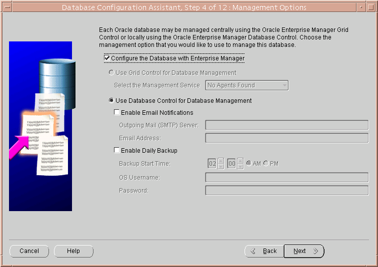

If you create a database while installing Oracle Database 10g, you have the option of configuring your database so it can be managed by Oracle Enterprise Manager 10g Grid Control Console or by Oracle Enterprise Manager Database Console.
Figure 16-3 shows the Management Options page, which allows you to select your database management options while installing Oracle Database 10g.
Figure 16-3 Selecting Your Management Options While Installing Oracle Database 10g
To select Grid Control Console as your management option, the Oracle Management Service must be installed on a network host. In addition, the Oracle Management Agent must be installed on the host where you are installing the database. Otherwise, the Grid Control Console option is unavailable and you must instead choose to manage your database with Database Control.
For most of the Oracle Database 10g installation types, you must choose either Database Control or Grid Control as your management option when you create a database during the installation.
However, if you create a database using one of the following methods, you can choose not to configure Database Console:
Choosing to create a database during a custom installation
Choosing the Advanced database configuration option during an Enterprise or Standard Edition installation
Running Database Configuration Assistant (DBCA) after the installation
If you do not configure Database Console during the Oracle Database 10g installation, no hostname_sid directory is created in the resulting Oracle home directory (Figure 16-2).
The primary method for configuring an existing Oracle Database 10g database so it can be managed with Database Console is to use DBCA. You can use DBCA to create a new database or to reconfigure an existing database.
See Also:
"Installing Oracle Software and Building the Database" in Oracle Database 2 Day DBA for more information about using DBCA to create a new database instanceTo use DBCA to reconfigure your database so it can be managed with Database Console:
Log into the database host as a member of the administrative group that is authorized to install Oracle software and create and run the database.
On Windows, select Start, point to Programs, Oracle - home_name, Configuration and Migration Tools, and then select Database Configuration Assistant.
On UNIX, change directory to the ORACLE_HOME/bin directory and enter the following command:
$PROMPT> ./dbca
The DBCA Welcome page appears.
Advance to the Operations page and select Configure Database Options.
Advance to the Database page and select the database you want to configure.
Advance to the Management Options page (Figure 16-4) and select the following options:
Configure the Database with Enterprise Manager
Use Database Control for Database Management
Optionally, select the options for enabling e-mail notifications and enabling daily backups.
For more information about Enterprise Manager notifications and daily backups, click Help on the Management Options page.
Advance until the Finish button is available.
Click Finish to reconfigure the database so it uses Database Console.
