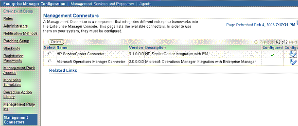

The new HP ServiceCenter connector should now appear in the Management Connector Page of the Enterprise Manager Grid Control Console as shown in Figure 2-1.
