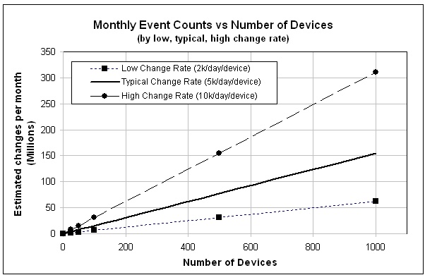

The size of the database correlates with the number of expected changes, rather than to the number of devices in the infrastructure. The first graph shows some change counts that might exist in some environments based on the expected change rates. A low change rate would mean that not very many changes happen on the rules sets that are configured. These can be used as a guideline when estimating how many changes you might expect to collect over a month.

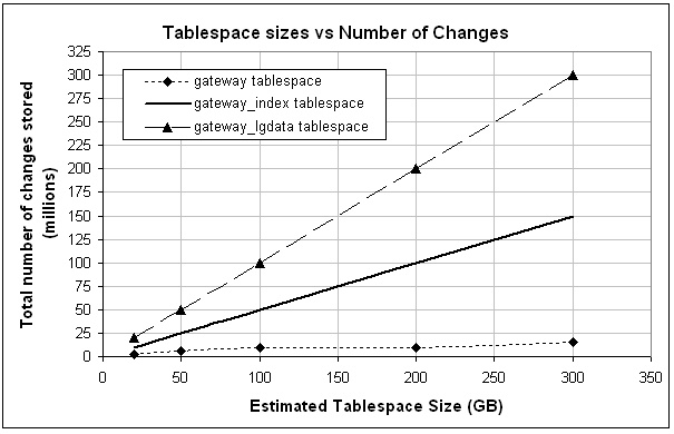

The next graph shows the estimated tablespace size versus the number of changes in the environment. The number of changes shown in the graph reflects the number of changes the application can retain in its repository. If you have your data purging set to three months, then you would find the number of changes you expect in a three month period. The previous graph showed some example total change counts for one month.
If you were storing events for three months, you would need to multiply the estimated change counts in the previous graph by three.
Note that if the tablespace is not sufficient in size, there may be data loss should the database become full. Once the database reaches its capacity you will receive an error message in your server log. You will be able to see this under the Administration > Server Reports > Server and Database Logs screen. Any new data will not be saved and users will not be able to log in to the product. To prevent data loss and user lockout, it is best to over-estimate the space needed for your database or leave a small buffer of disk space for auto-extension of the tablespace.
This graph does not include other tablespaces such as TEMP and UNDO. You must allocate an appropriate amount of disk space for these tablespaces based on your own best practices.
