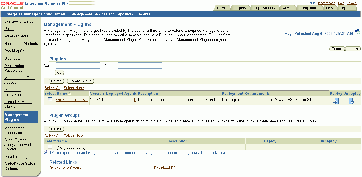

After you ensure that the prerequisites are met, follow these steps to deploy the plug-in:
Download the VMWare ESX Server Plug-in archive to your desktop or computer on which the browser is launched. You can download the archive from the Oracle Technology Network (OTN).
Log on to Enterprise Manager Grid Control as a Super Administrator.
Click the Setup link in the upper right corner of the Grid Control Home page, then click the Management Plug-ins link on the left side of the Setup page.
Click Import.
Click Browse and select the plug-in archive.
Click List Archive.
Select the plug-in and click OK.
Verify that you have set preferred credentials on all Agents where you want to deploy the plug-in.
In the Management Plug-ins page, click the icon in the Deploy column for the VMWare ESX Server plug-in. The Deploy Management Plug-in wizard appears.
Click Add Agents, then select one or more Agents for which you want to deploy the plug-in. The wizard reappears and displays the Agent or Agents selected.
Click Next, then click Finish.

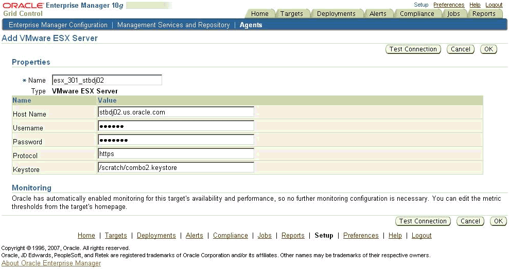

After successfully deploying the plug-in, follow these steps to add the plug-in target to Grid Control for central monitoring and management:
From the Agent home page where the plug-in was deployed, select the VMware ESX Server target type from the Add drop-down list, then click Go. The Add VMware ESX Server page appears.
Provide the following information for the properties:
Name — Name of the VMware ESX Server being monitored
Host Name — Fully qualified host name, including domain, of the ESX Server
Username — Name of the user with proper privileges for enabling the plug-in to access data through the embedded Web Service in the VMWare ESX Server
Password — Password for the specified Username
Protocol — Either HTTP or HTTPS can be specified. If HTTPS is specified, you must specify the Keystore parameter (with HTTP set, the Keystore parameter is left blank). However, due to an issue with the ESX Server, Oracle recommends using the HTTP protocol at this time. Refer to the section for more details.
Keystore — Full path name and file name to the keystore file that contains the certificate for the VMware ESX Server. The agent must have access to this keystore file.
Click Test Connection to make sure the parameters you entered are correct.
Reenter the encrypted parameters from step 2 if the connection test was successful, then click OK. This step is not required if the Enterprise Manager version is 10.2.0.4 or above.

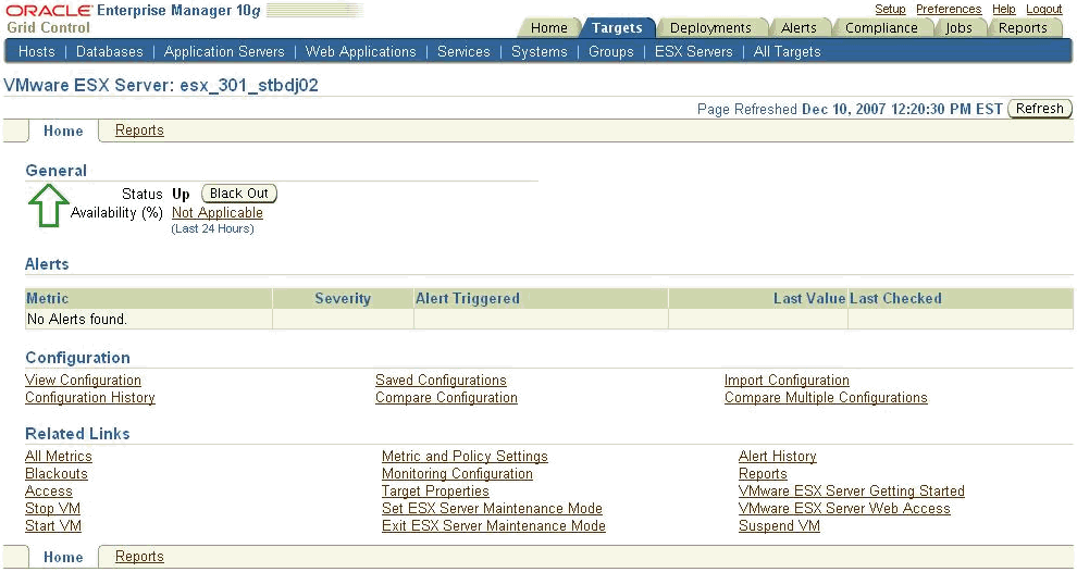

After you deploy and configure the plug-in to monitor one or more targets in the environment, you can customize the monitoring settings of the plug-in. This alters the collection intervals and threshold settings of the metrics to meet the particular needs of your environment. If you decide to disable one or more metric collections, this could impact the reports that the metric is part of.After waiting a few minutes for the plug-in to start collecting data, deploy the following steps to verify and validate that Enterprise Manager is properly monitoring the plug-in target:
Click the VMware ESX Server target link from the Agent home page Monitored Targets table. The VMware ESX Server home page appears.
Verify that no metric collection errors are reported in the Metrics table.
Ensure that reports can be seen by selecting the Reports property page.
Ensure that configuration data can be seen by clicking the View Configuration link in the Configuration section. If configuration data does not appear immediately, click Refresh in the View Configuration page.
