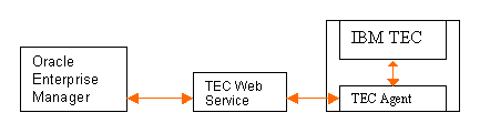

The Oracle Enterprise Manager Connector Framework requires a web service interface for exchanging event information with IBM TEC. Since TEC does not provide a web services interface, you must install a third-party TEC web service front-end, which is included in the Oracle Enterprise Manager installation package.
You can install the web service on any Unix or Windows system that has connectivity with the TEC server. In addition to the TEC web service front-end, you must also install a back-end TEC Agent on the same physical system as the TEC server. The TEC Agent is preconfigured and is also included in the Oracle Enterprise Manager installation package.
Figure 2–1 shows the communication between the various components of the TEC Connector.

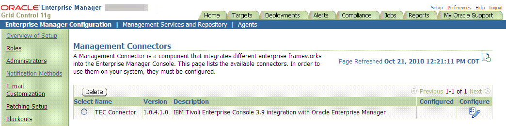

$OMS_HOME/bin/emctl register_connector connector –dd $OMS_HOME/sysman/connector/TEC_Connector/TECConnector.xml” -repos_pwd password
The new TEC connector should now appear in the Management Connectors page after the emctl register_connector command has loaded the connector, as shown in Figure 2–2.
