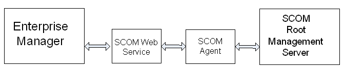

The Oracle Enterprise Manager Connector Framework requires a web service interface for exchanging event information with Microsoft SCOM. To integrate with Enterprise Manager, a third-party SCOM web service front-end must be installed. In addition to the web service front-end, an Oracle SCOM Agent must also be installed. Both of these components are included in the Oracle Enterprise Manager installation package.
You can install the web service on any Unix or Windows system that has connectivity with the SCOM server. In addition to the SCOM web service front-end, you must also install a back-end SCOM Agent. The Oracle SCOM Agent is preconfigured and is also included in the Oracle Enterprise Manager installation package.
Figure 2–1 shows the communication between the various components of the SCOM Connector.
