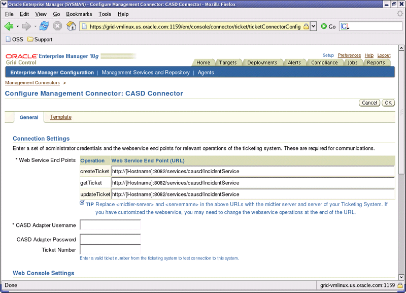

The General tab of the Configure Management Connector page appears, as shown in Figure 3-2.
Provide the required settings. See Providing General Settings for details.

The CA Service Desk Connector communicates with the Service Desk through a web service provided by the CASD Adapter. Mandatory fields are indicated by an asterisk (*).
Web Service End Points - End points to createTicket, updateTicket, and getTicket web services exposed by the CASD Adapter. See "Using the Correct URL for CASD Adapter Operations" in Appendix A for additional information.
CASD Adapter Username - User name that was configured for accessing the Adapter web service in step 10 of the appropriate adapter installation section ( Installing the Adapter on Unix for Unix and Installing the Adapter on Windows for Windows).
CASD Adapter Password - Password that was configured for accessing the Adapter web service in step 11 of the appropriate adapter installation section ( Installing the Adapter on Unix for Unix and Installing the Adapter on Windows for Windows).
Ticket Number - Enter a valid ticket number if you want to test the connection when you save the configuration.
If you do not enter a ticket number, no message appears on the Management Connectors page after you click OK and the configuration is saved.
