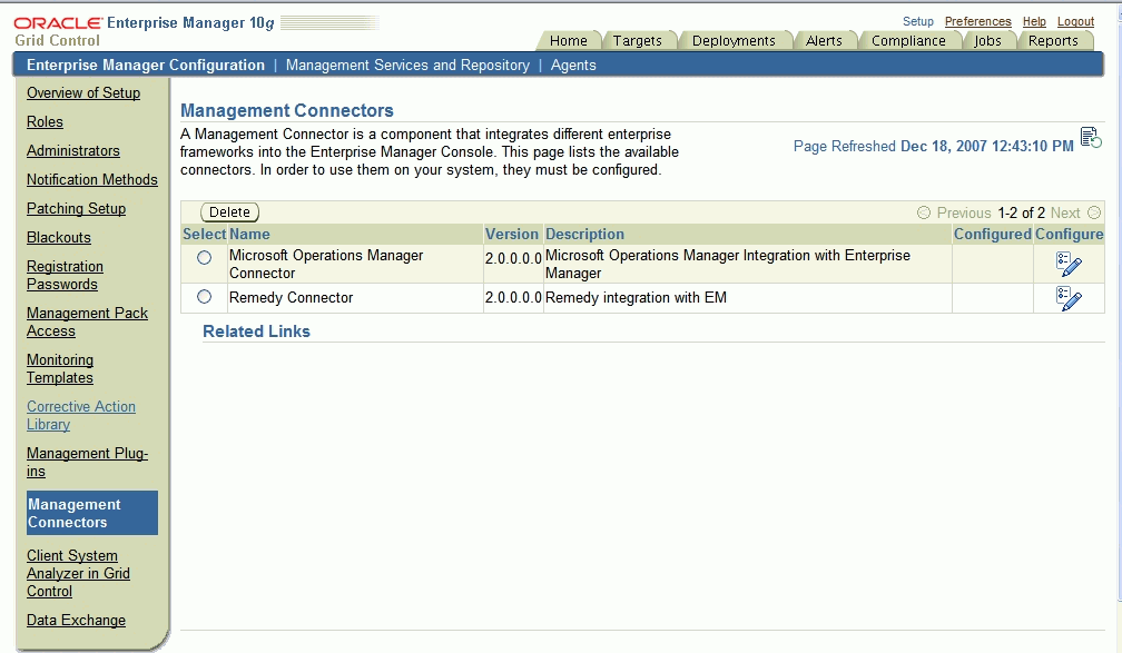

  1. From the Enterprise Manager console, click Setup.
  2. Click the Management Connectors link in the left pane.
    The Management Connectors page appears. For the MOM Connector row, the Configured column should be blank (Figure 2–1).
    A check mark in the Configured column indicates that the Connector is already configured.
    Figure 2-1 Management Connectors Page
    Surrounding text describes Figure 2-1 .

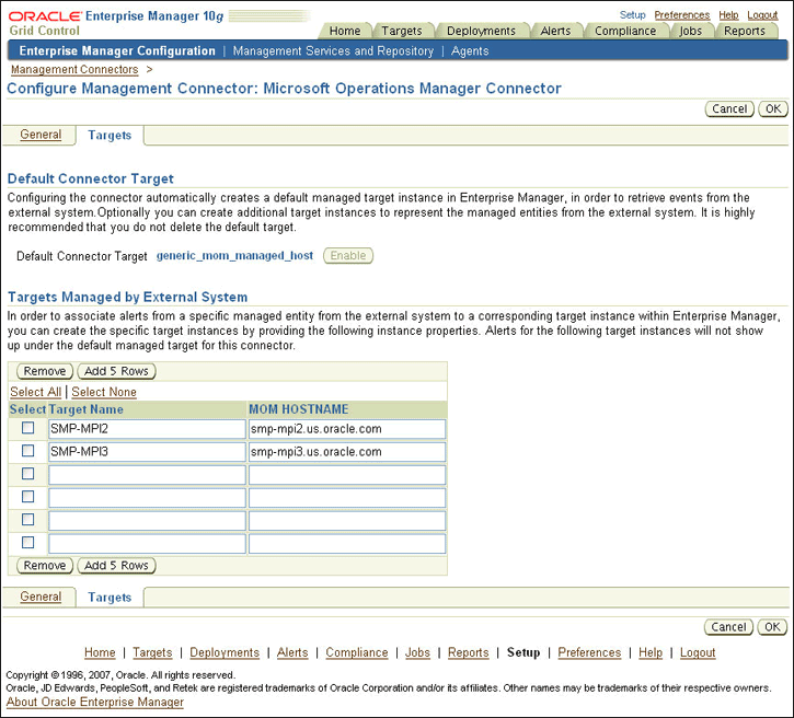

Creating Additional Target Instances
When you deploy or install a MOM Connector, a default target instance generic_mom_managed_host is created. In addition, you can create specific target instances.
An alert is assigned to the respective targets based on the computer name in MOM. If the name specified under Computer column in the MOM Operator console matches the target name you specify in the Target Name column in the section "Targets Managed by External System (Optional)" below, the alert is assigned to this target. If the target does not exist, the alert is assigned to the default target instance.
In the Configure Management Connector page, click the Targets tab to create specific target instances. Figure 2–3 shows the Configure Management Connector Target page.
Default Connector Target
The default target instance holds external alerts that are not associated with any particular Enterprise Manager target. Oracle recommends that you do not remove this default connector target when you create additional targets.
If the default target is removed accidentally, you can recreate it by clicking the Enable button in the Targets tab of the Configure Management Connector page.
If the default target is removed for alerts that cannot be mapped to any target, error messages are logged in the file emoms.log.
In this section, you can optionally create target instances and associate external alerts with these target instances.
To add a new target:
  1. Specify the target name in the Target Name column.
  2. In the MOM HOSTNAME column, specify the fully qualified host name (host name along with the domain name; for example, smp-mpi2.us.oracle.com) of the target.
  3. Click OK.
If you want to create more target instances, click Add Rows to add additional rows and then specify the target information. To remove a target, check the Select check box corresponding to the target, click Remove, then click OK.
Figure 2-3 Configure Management Connector Target Page
Surrounding text describes Figure 2-3 .
