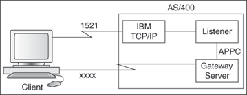

Oracle Net for AS/400 Architecture
Oracle Net connections are established on the AS/400 through a listener. A listener receives incoming connections from Oracle Net clients and starts or transfers to a job on the AS/400 system.
On the AS/400, the Oracle Net TNS listener is used for TCP/IP.
Figure 5-1 shows communication between a client and the AS/400. Oracle Net on the AS/400 can accept TCP/IP connections.
Figure 5-1 Oracle Net Communication to the OS/400
After the listener accepts the client connection, a batch job is started on the AS/400, or (more usually) a prestarted AS/400 batch job receives control. The batch job executes the gateway and sends a response back to the client. The response is data or a message. Each batch job is responsible for a client connection. Only one batch job is executed for a single connection, and a single connection is associated with only one batch job.
To reduce the waiting time for connecting to gateway jobs, a set of prestarted gateway batch jobs are associated with a TNS listener. The number of prestarted jobs and the point at which additional jobs are started can be modified by the system administrator.

Figure 5-2 demonstrates a TCP/IP connection flow.
Figure 5-2 TCP/IP Connection Flow
