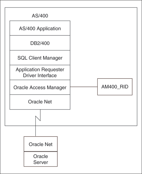

Figure 7-1 AS/400 In-Doubt Transactions
As a transaction progresses, the Access Manager sends status messages to the AM400_RID program. The AM400_RID program does not send anything back to the Access Manager. In this manner, the AM400_RID program is kept informed of the status of all Oracle Access Manager transactions.
