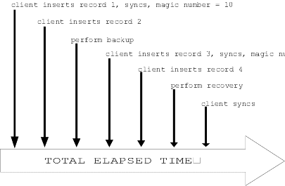

When you perform a backup, you may lose client data unless you plan accordingly. Figure 15-1 demonstrates the following scenario:
The client inserts record 1 and synchronizes the data to the server. The Mobile Server assigns the same magic number to both the client and the server to denote that they are in sync. In this example, the magic number on both the client and the server is 10.
The client inserts record 2. No synchronization is performed.
The backup is performed. Client record 1 is saved to the backup. The latest magic number on both the client and the server is 10.
The client inserts record 3 and synchronizes the data to the server. The Mobile Server assigns the same magic number to both the client and the server to denote that they are in sync. In this example, the magic number on both the client and the server is 20.
The client inserts record 4. No synchronization is performed.
A failure occurs and the last backup is used to recover the Mobile Server, the Mobile applications and the application data. In this scenario, only record 1 is in the backup, so it will exist in the restored database.
The client synchronizes. Records 2 and 3 can be lost, because they are not in the backup. The msync client does not send them to the server, since they were already sent in step 4. However, the msync client does send record 4 to the server, since it is a new record that has never been synchronized with the database. After the synchronization, record 4 is stored in the error queue, not in the application tables.
Figure 15-1 Lost Data With Backup and Recovery Strategy
