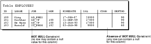

Figure 6-1 shows an example of a table with NOT NULL integrity constraints.
Figure 6-1 Table with NOT NULL Integrity Constraints

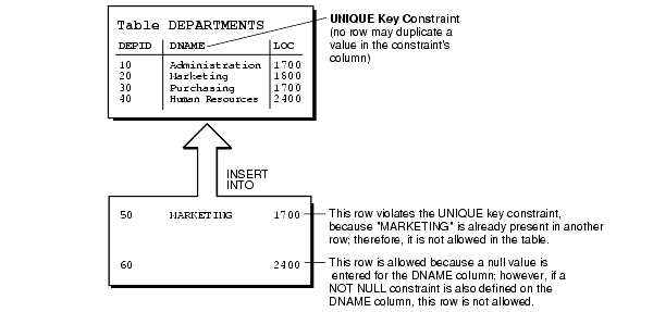

Choose columns for unique keys carefully. The purpose of these constraints is different from that of primary keys. Unique key constraints are appropriate for any column where duplicate values are not allowed. Primary keys identify each row of the table uniquely, and typically contain values that have no significance other than being unique. Figure 6-2 shows an example of a table with a unique key constraint.
Figure 6-2 Table with a UNIQUE Key Constraint
