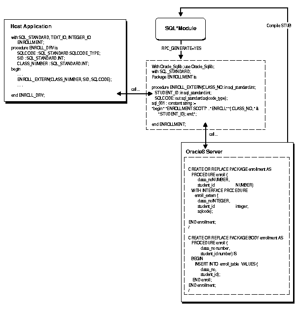

You can use SQL*Module to provide a bridge that enables your host application to access procedures stored in the database. A host application written in Ada cannot call a stored database subprogram directly. But you can use SQL*Module to construct an interface procedure ("stub'') that calls the stored database subprogram. shows, in schematic form, how this process works.
In this example, there is a procedure stored in the database called enroll. The PL/SQL source code that created the procedure is shown in the right-hand box. The WITH INTERFACE clause in the procedure is described in the section "The WITH INTERFACE Clause". The procedure has two database parameters: class_no and student_id. The SQLCODE error return parameter is added in the interfacing clause.
The Oracle Server always translates to uppercase the names of database objects as they are inserted into the database. This includes the names of packages and procedures. For example, if you are loading a package into the database in the SCOTT schema, and have a PL/SQL source file that contains the line
CREATE PACKAGE school_records AS ...
then Oracle inserts the name into the schema as SCHOOL_RECORDS, not the lowercase ''school_records''. The following SQL*Module command (in UNIX)
modada rpc_generate=yes pname=school_records userid=scott
generates an error, since there is no package named ''school_records'' in the schema.
If you prefer to have your package and procedure names stored in lowercase in the database, you must quote all references to the name in the PL/SQL source file, or as you insert them into the database using SQL*Plus. So, you would code
CREATE PACKAGE "school_records" AS ...
Note also that SQL*Module preserves the case of subprogram names when creating interface procedure files.
However, if you really do want uppercase names, some operating systems (OPEN VMS is an example) require that you quote the name when you specify it on the command line. So, you would enter the command as
modada rpc_generate=yes pname="SCHOOL_RECORDS" user=scott
See your system-specific Oracle documentation, and your operating system documentation, for additional information on case conventions for command lines that are in effect for your operating system.
When you generate RPCs (remote procedure calls) using SQL*Module, you have a choice of early binding or late binding. Your choice of early or late binding is controlled by the BINDING option.
When you choose early binding, SQL*Module generates a call to the procedure stored in the database, and also uses a time stamp that is associated with the call. The time stamp records the date and time (to the nearest second) that the stored procedure was last compiled. The time stamp is created by the Oracle database. If a host application calls the stored procedure through the interface procedure, and the time stamp recorded with the interface procedure is earlier than the time stamp on the stored procedure recorded in the database, an error is returned to the host application in the SQLCODE or SQLSTATE status parameter. The SQLCODE error is 4062 "time stamp of name has been changed".
The late binding option, on the other hand, does not use a time stamp. If your application calls a stored procedure that has been recompiled since SQL*Module generated the interface procedure, no error is returned to the application.
With late binding, SQL*Module generates the call to the stored procedure using an anonymous PL/SQL block. The following example shows a specification for a stored procedure that is part of a package in the SCOTT schema:

If you run the module compiler, modada, as follows:
modada pname=PROC1 rpc_generate=yes user=scott/tiger oname=proc1
then the Ada procedure specification in the generated output file proc1_.a would be created by SQL*Module as follows:
procedure PROC1(SQLCODE: in out sql_standard.sqlcode_type; sqlstate: in out sql_standard.sqlstate_type; PARAM1: in sql_standard.double_precision; PARAM1_ind: in sql_standard.smallint; PARAM2: in out oracle_sqllib.sql_date; PARAM2_ind: in out sql_standard.smallint; PARAM3: out sql_standard.double_precision; PARAM3_ind: out sql_standard.smallint; PARAM4: in string; PARAM4_ind: in sql_standard.smallint; PARAM5: in sql_standard.int; PARAM5_ind: in sql_standard.smallint);
Function calls are generated as procedures with the last two parameters in the generated prototype being the return parameter and the indicator variable for the return parameter. For example:
FUNCTION func1 (
PARAM1 IN NUMBER) RETURN VARCHAR2
would have the Ada prototype:
procedure FUNC1(SQLCODE: in out sql_standard.sqlcode_type; sqlstate: in out sql_standard.sqlstate_type; PARAM1: in sql_standard.double_precision; PARAM1_ind: in sql_standard.smallint; mod_func_return: out string; mod_func_return_ind: out sql_standard.smallint) is begin . . . end FUNC1;

When you write an Ada program that calls RPC interface procedures that were generated from stored procedures, you need a way to connect to a database at runtime. The steps you can take to do this are
Write a module that contains connect and disconnect procedures. See "CONNECT Statement" for the syntax of these procedures. See also the examples in the demomod sample in Chapter 6, "Demonstration Programs".
Compile the module using SQL*Module.
Add a with clause to the host application file referencing the generated specification name.
Compile the specification file.
Compile the source output file.
Link your main application.
