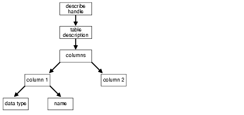

The information returned by OCIDescribeAny() is organized hierarchically like a tree, as shown in Figure 6-1:
Figure 6-1 OCIDescribeAny() Table Description
The describe handle returned by OCIDescribeAny() has an attribute, OCI_ATTR_PARAM, that points to such a description tree. Each node of the tree has attributes associated with that node, and attributes that are like recursive describe handles and point to subtrees containing further information. If all the attributes are homogenous, as in the case of elements of a column list, they are called parameters. The attributes associated with any node are returned by OCIAttrGet(), and the parameters are returned by OCIParamGet().
A call to OCIAttrGet() on the describe handle for the table returns a handle to the column-list information. An application can then use OCIParamGet() to retrieve the handle to the column description of a particular column in the column-list. The handle to the column descriptor can be passed to OCIAttrGet() to get further information about the column, such as the name and datatype.
