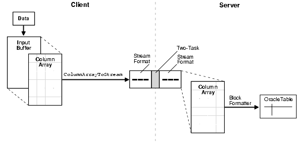

The direct path load interface enables an OCI application to access the direct path load engine of the Oracle database server to perform the functions of the Oracle SQL*Loader utility. This functionality provides the ability to load data from external files into either a table or a partition of a partitioned table.
The OCI direct path load interface has the ability to load multiple rows by loading a direct path stream that contains data for multiple rows.
To use the direct path API, the client application performs the following steps:

These handles are used to present an array of rows to the direct path interface. A row is represented by three arrays: column values, column lengths, and column flags. Methods used on a column array include: allocate the array handle and set or get values corresponding to an array entry.
Both handles share the same data structure, OCIDirPathColArray
. But these column array handles differ in parent handles and handle types.

This handle is used by the conversion operation, OCIDirPathColArrayToStream(), and by the load operation, OCIDirPathLoadStream().
Direct path stream handles is allocated by the client with OCIHandleAlloc()
. The structure of a OCIDirPathStream
handle can be thought of as a pair in the form (buffer, buffer length).
A direct path stream is a linear representation of Oracle table data. The conversion operations always append to the end of the stream. Load operations always start from the beginning of the stream. After a stream is completely loaded, the stream must be reset by calling OCIDirPathStreamReset()
