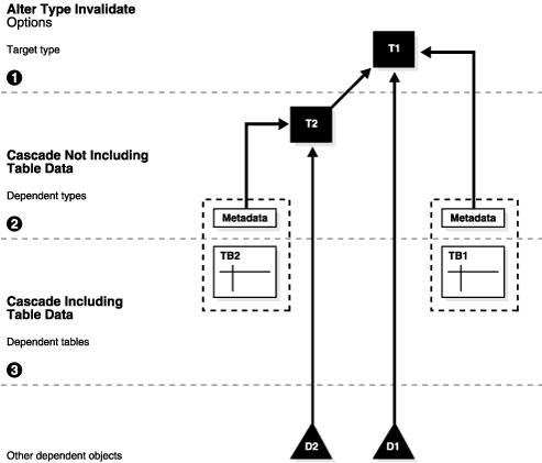

Changing a object type is called type evolution. You can make the following changes to an object type:
Add and drop attributes
Add and drop methods
Modify a numeric attribute to increase its length, precision, or scale
Modify a varying length character attribute to increase its length
Change a type's FINAL
and INSTANTIABLE
properties
Modify limit and size of VARRAY
s
Modify length, precision, and scale of collection elements
Changes to a type affect things that reference the type. For example, if you add a new attribute to a type, data in a column of that type must be presented so as to include the new attribute.
Schema objects that directly or indirectly reference a type and are affected by a change to it are called dependents of the type. A type can have these kinds of dependents:
Table
Type or subtype
Program unit (PL/SQL block): procedure, function, package, trigger
Indextype
View (including object view)
Function-based index
Operator
How a dependent schema object is affected by a change to a type depends on the dependent object and on the nature of the change to the type.
All dependent program units, views, operators and indextypes are marked invalid when a type is modified. The next time one of these invalid schema objects is referenced, it is revalidated using the new type definition. If the object recompiles successfully, it becomes valid and can be used again. Depending on the change to the type, function-based indexes may be dropped or disabled and need to be rebuilt.
If a type has dependent tables, then, for each attribute added to a type, one or more internal columns are added to the table depending on the new attribute's type. New attributes are added with NULL
values. For each dropped attribute, the columns associated with that attribute are dropped. For each modified attribute, the length, precision, or scale of its associated column is changed accordingly.
These changes mainly involve updating the tables' metadata (information about a table's structure, describing its columns and their types) and can be done quickly. However, the data in those tables must be updated to the format of the new type version as well. Updating this data can be time-consuming if there is a lot of it, so the ALTER TYPE
command has options to let you choose whether to convert all dependent table data immediately or to leave it in the old format to be converted piecemeal as it is updated in the course of business.
The CASCADE
option for ALTER TYPE
propagates a type change to dependent types and tables. See "ALTER TYPE Statement for Type Evolution". CASCADE
itself has options that let you choose whether to convert table data to the new type format as part of the propagation: the option INCLUDING TABLE DATA
converts the data; the option NOT INCLUDING TABLE DATA
does not convert it. By default, the CASCADE
option converts the data. In any case, table data is always returned in the format of the latest type version. If the table data is stored in the format of an earlier type version, Oracle converts the data to the format of the latest version before returning it, even though the format in which the data is actually stored is not changed until the data is rewritten.
You can retrieve the definition of the latest type from the system view USER_SOURCE
. You can view definitions of all versions of a type in the USER_TYPE_VERSIONS
view.

These changes result in new versions of the altered type and all its dependent types and require the system to add, drop, or modify internal columns of dependent tables as part of the process of converting to the new version.
When you make any of these kinds of changes to a type that has dependent types or tables, the effects of propagating the change are not confined only to metadata but affect data storage arrangements and require the data to be converted.
Besides converting data, you may also need to make other changes. For example, if a new attribute is added to a type, and the type body invokes the type's constructor, then each constructor in the type body must be modified to specify a value for the new attribute. Similarly, if a new method is added, then the type body must be replaced to add the implementation of the new method. The type body can be modified by using the CREATE OR REPLACE TYPE BODY
statement.
Example 7-2 illustrates how to make a simple change to person_typ
by adding one attribute and dropping another. The CASCADE
keyword propagates the type change to dependent types and tables, but the phrase NOT
INCLUDING
TABLE
DATA
prevents conversion of the related data.
Example 7-2 Altering an Object Type by Adding and Dropping an Attribute
CREATE TABLE person_obj_table OF person_typ; INSERT INTO person_obj_table VALUES (person_typ(12, 'Bob Jones', '111-555-1212')); SELECT value(p) FROM person_obj_table p;
VALUE(P)(IDNO, NAME, PHONE)
PERSON_TYP(12, 'Bob Jones', '111-555-1212')
-- add the email attribute and drop the phone attribute ALTER TYPE person_typ ADD ATTRIBUTE (email VARCHAR2(80)), DROP ATTRIBUTE phone CASCADE NOT INCLUDING TABLE DATA; -- Disconnect and reconnect to accommodate the type change -- The data of table person_obj_table has not been converted yet, but -- when the data is retrieved, Oracle returns the data based on -- the latest type version. The new attribute is initialized to NULL. SELECT value(p) FROM person_obj_table p;
VALUE(P)(IDNO, NAME, EMAIL)
PERSON_TYP(12, 'Bob Jones', NULL)
During SELECT
statements, even though column data may be converted to the latest type version, the converted data is not written back to the column. If a certain user-defined type column in a table is retrieved often, you should consider converting that data to the latest type version to eliminate redundant data conversions. Converting is especially beneficial if the column contains a VARRAY

Figure 7-1 graphically summarizes the options for ALTER
TYPE
INVALIDATE
and their effects. In the figure, T1
is a type and T2
is a dependent type. See the notes following the figure.
Notes on the figure:
Invalidate: All objects following line (1) are marked invalid
Cascade Not Including Table Data: All objects following line (2) are marked invalid. Metadata of all dependent tables are upgraded to the latest type version, but the table data are not converted.
Cascade Including Table Data: All objects following line (3) are marked invalid. All dependent tables are upgraded to the latest type version, including the table data.
