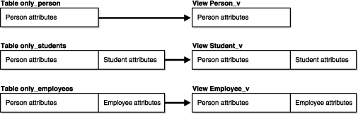

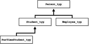

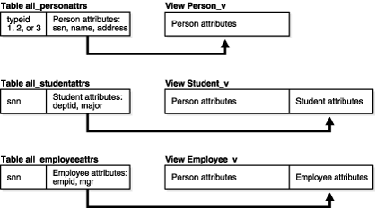

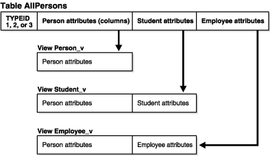

Something you want to be careful of: In an object view hierarchy, UPDATE
and DELETE
statements operate polymorphically just as SELECT
statements do: the set of rows picked out by an UPDATE
or DELETE
statement on a view implicitly includes qualifying rows in any subviews of the specified view as well. See "Object View Hierarchies" for a discussion of object view hierarchy and examples defining Student_v
and Employee_v.
For example, the following statement, which deletes all persons from Person_v
, also deletes all students from Student_v
and all employees from the Employee_v
view.
DELETE FROM Person_v;
To exclude subviews and restrict the affected rows just to those in the view actually specified, use the ONLY
keyword. For example, the following statement updates only persons and not employees or students.
UPDATE ONLY(Person_v) SET address = ...

An object view hierarchy is a set of object views each of which is based on a different type in a type hierarchy. Subviews in a view hierarchy are created under a superview, analogously to the way subtypes in a type hierarchy are created under a supertype.
Each object view in a view hierarchy is populated with objects of a single type, but queries on a given view implicitly address its subviews as well. Thus an object view hierarchy gives you a simple way to frame queries that can return a polymorphic set of objects of a given level of specialization or greater.
For example, suppose you have the following type hierarchy, with person_typ
as the root:
If you have created an object view hierarchy based on this type hierarchy, with an object view built on each type, you can query the object view that corresponds to the level of specialization you are interested in. For instance, you can query the view of student_typ
to get a result set that contains only students, including part-time students.

The following examples show three possible storage models. In the first, a flat model, all views in the object view hierarchy are based on the same table. In the second, a horizontal model, each view has a one-to-one correspondence with a different table. And in the third, a vertical model, the views are constructed using joins.
In the flat model, all the views in the hierarchy are based on the same table. In the following example, the single table AllPersons
contains columns for all the attributes of person_typ
, student_typ
, or employee_typ
Figure 5-2 Flat Storage Model for Object View Hierarchy
CREATE TABLE AllPersons ( typeid NUMBER(1), ssn NUMBER, name VARCHAR2(30), address VARCHAR2(100), deptid NUMBER, major VARCHAR2(30), empid NUMBER, mgr VARCHAR2(30));
The typeid
column identifies the type of each row. Possible values are:
-- 1 = person_typ -- 2 = student_typ -- 3 = employee_typ CREATE TYPE person_typ AS OBJECT ( ssn NUMBER, name VARCHAR2(30), address VARCHAR2(100)) NOT FINAL;/ CREATE TYPE student_typ UNDER person_typ ( deptid NUMBER, major VARCHAR2(30)) NOT FINAL;/ CREATE TYPE employee_typ UNDER person_typ ( empid NUMBER, mgr VARCHAR2(30));/
The following statements create the views that make up the object view hierarchy:
Example 5-9 Creating an Object View Hierarchy
CREATE VIEW Person_v OF person_typ WITH OBJECT OID(ssn) AS SELECT ssn, name, address FROM AllPersons WHERE typeid = 1; CREATE VIEW Student_v OF student_typ UNDER Person_v AS SELECT ssn, name, address, deptid, major FROM AllPersons WHERE typeid = 2; CREATE VIEW Employee_v OF employee_typ UNDER Person_v AS SELECT ssn, name, address, empid, mgr FROM AllPersons WHERE typeid = 3;
The flat model has the advantage of simplicity and poses no obstacles to supporting indexes and constraints. Its drawbacks are:
A single table cannot contain more than 1000 columns, so the flat model imposes a 1000-column limit on the total number of columns that the object view hierarchy can contain.
Each row of the table will have NULLs for all the attributes not belonging to its type. Such non-trailing NULLs can adversely affect performance.
On the horizontal model, each view or subview is based on a different table. In the example, the tables are relational, but they could just as well be object tables for which column substitutability is turned off.
Figure 5-3 Horizontal Storage Model for Object View Hierarchy
CREATE TABLE only_persons ( ssn NUMBER, name VARCHAR2(30), address VARCHAR2(100)); CREATE TABLE only_students ( ssn NUMBER, name VARCHAR2(30), address VARCHAR2(100), deptid NUMBER, major VARCHAR2(30)); CREATE TABLE only_employees ( ssn NUMBER, name VARCHAR2(30), address VARCHAR2(100), empid NUMBER, mgr VARCHAR2(30));
These are the views:
CREATE OR REPLACE VIEW Person_v OF person_typ WITH OBJECT OID(ssn) AS SELECT * FROM only_persons CREATE OR REPLACE VIEW Student_v OF student_typ UNDER Person_v AS SELECT * FROM only_students; CREATE OR REPlACE VIEW Employee_v OF employee_typ UNDER Person_v AS SELECT * FROM only_employees;
The horizontal model is very efficient at processing queries of the form:
SELECT VALUE(p) FROM Person_v p WHERE VALUE(p) IS OF (ONLY student_typ);
Such queries need access only a single physical table to get all the objects of the specific type. The drawbacks of this model are that queries of the sort SELECT * FROM
view require performing a UNION
over all the underlying tables and projecting the rows over just the columns in the specified view. (See "Querying a View in a Hierarchy".) Also, indexes on attributes (and unique constraints) must span multiple tables, and support for this does not currently exist.
In the vertical model, there is a physical table corresponding to each view in the hierarchy, but each physical table stores only those attributes that are unique to its corresponding subtype.
Figure 5-4 Vertical Storage Model for Object View Hierarchy
CREATE TABLE all_personattrs ( typeid NUMBER, ssn NUMBER, name VARCHAR2(30), address VARCHAR2(100)); CREATE TABLE all_studentattrs ( ssn NUMBER, deptid NUMBER, major VARCHAR2(30)); CREATE TABLE all_employeeattrs ( ssn NUMBER, empid NUMBER, mgr VARCHAR2(30)); CREATE OR REPLACE VIEW Person_v OF person_typ WITH OBJECT OID(ssn) AS SELECT ssn, name, address FROM all_personattrs WHERE typeid = 1; CREATE OR REPLACE VIEW Student_v OF student_typ UNDER Person_v AS SELECT x.ssn, x.name, x.address, y.deptid, y.major FROM all_personattrs x, all_studentattrs y WHERE x.typeid = 2 AND x.ssn = y.ssn; CREATE OR REPLACE VIEW Employee_v OF employee_typ UNDER Person_v AS SELECT x.ssn, x.name, x.address, y.empid, y.mgr FROM all_personattrs x, all_employeeattrs y WHERE x.typeid = 3 AND x.ssn = y.ssn;
The vertical model can efficiently process queries of the kind SELECT * FROM
root_view
, and it is possible to index individual attributes and impose unique constraints on them. However, to re-create an instance of a type, a join over OIDs must be performed for each level that the type is removed from the root in the hierarchy.
