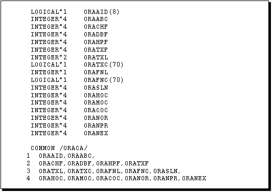

When more information is needed about runtime errors than the SQLCA provides, you can use the ORACA, which contains cursor statistics, SQL statement data, option settings, and system statistics.
The ORACA is optional and can be declared regardless of the MODE setting. For more information about the ORACA status variable, see Using the Oracle Communications Area.

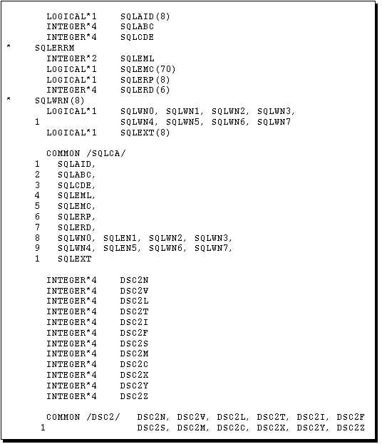

Figure 2-1 shows all the variables in the SQLCA. However, SQLWN2, SQLWN5, SQLWN6, SQLWN7, and SQLEXT are not currently in use.
Figure 2-1 SQLCA Variable Declarations for Pro*FORTRAN
To ensure portability, LOGICAL variables are used in the SQLCA instead of CHARACTER variables. For a full description of the SQLCA, its fields, and the values its fields can store, see Chapter 8 of the Programmer's Guide to the Oracle Precompilers.
To declare the SQLCA, simply include it (using an EXEC SQL INCLUDE statement) in your Pro*FORTRAN source file outside the Declare Section as follows:
* Include the SQL Communications Area (SQLCA). EXEC SQL INCLUDE SQLCA
Because it is a COMMON block, the SQLCA must be declared outside the Declare Section. Furthermore, the SQLCA must come before the CONNECT statement and the first executable FORTRAN statement.
You must declare the SQLCA in each subroutine and function that contains SQL statements. Every time a SQL statement in one of the subroutines or functions is executed, Oracle updates the SQLCA held in the COMMON block.
Ordinarily, only the order and datatypes of variables in a COMMON-list matter, not their names. However, you cannot rename the SQLCA variables because the precompiler generates code that refers to them. Thus, all declarations of the SQLCA must be identical.
When you precompile your program, the INCLUDE SQLCA statement is replaced by several variable declarations that allow Oracle to communicate with the program.

The SQLCA handles standard SQL communications. The Oracle Communications Area (ORACA) is a similar structure that you can include in your program to handle Oracle-specific communications. When you need more runtime information than the SQLCA provides, use the ORACA.
Besides helping you to diagnose problems, the ORACA lets you monitor your program's use of Oracle resources such as the SQL Statement Executor and the cursor cache, an area of memory reserved for cursor management.
The ORACA contains option settings, system statistics, and extended diagnostics. Figure 2-2 shows all the variables in the ORACA.
Figure 2-2 ORACA Variable Declarations for Pro*FORTRAN
To ensure portability, LOGICAL variables are used in the ORACA instead of CHARACTER variables. For a full description of the ORACA, its fields, and the values its fields can store, see Chapter 8 of the Programmer's Guide to the Oracle Precompilers.
To declare the ORACA, simply include it (using an EXEC SQL INCLUDE statement) in your Pro*FORTRAN source file outside the Declare Section as follows:
* Include the Oracle Communications Area (ORACA). EXEC SQL INCLUDE ORACA
Because it is a COMMON block, the ORACA must be declared outside the Declare Section. Furthermore, the ORACA must come before the CONNECT statement and the first executable FORTRAN statement.
You can redeclare the ORACA in any subroutine or function that contains SQL statements. Every time a SQL statement in the subroutine or function is executed, Oracle updates the ORACA held in COMMON.
Ordinarily, only the order and datatypes of variables in a COMMON-list matter, not their names. However, you cannot rename the ORACA variables because the precompiler generates code that refers to them. Thus, all declarations of the ORACA must be identical.
