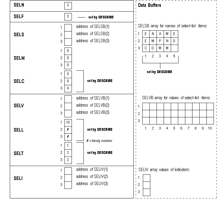

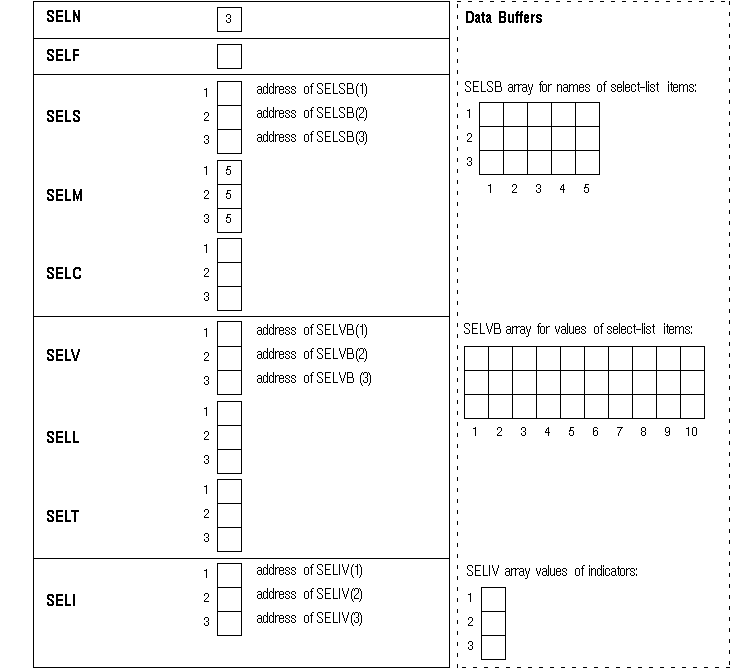

A select descriptor holds descriptions of select-list items and the addresses of output buffers where the names and values of select-list items are stored.
Note: The name of a select-list item can be a column name, a column alias, or the text of an expression such as SAL + COMM.

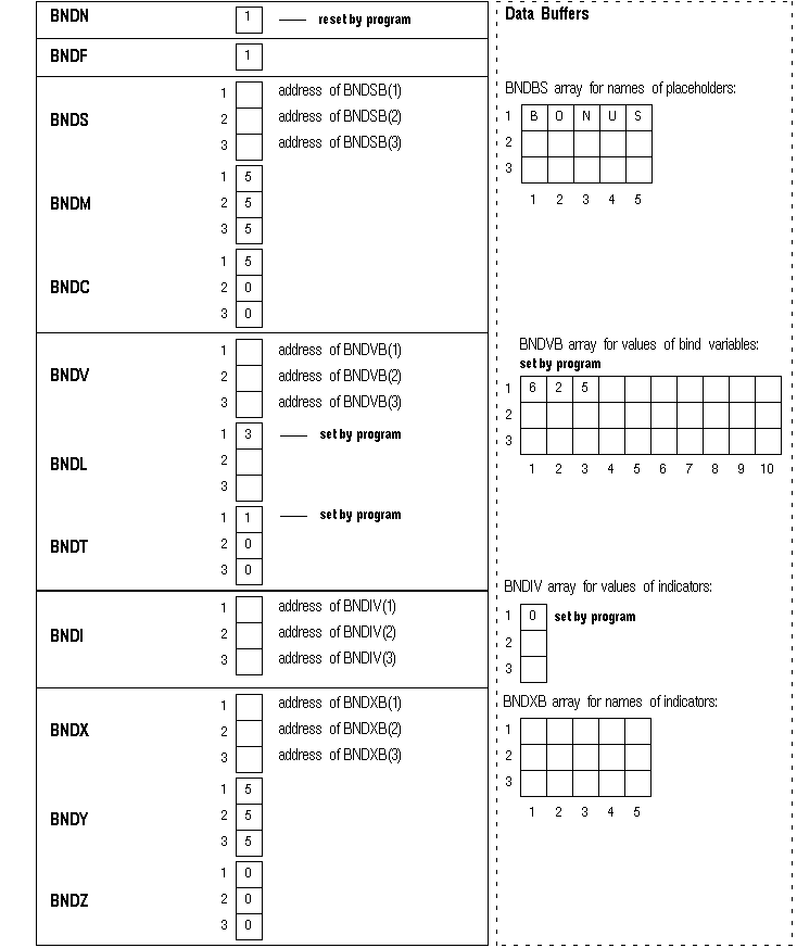

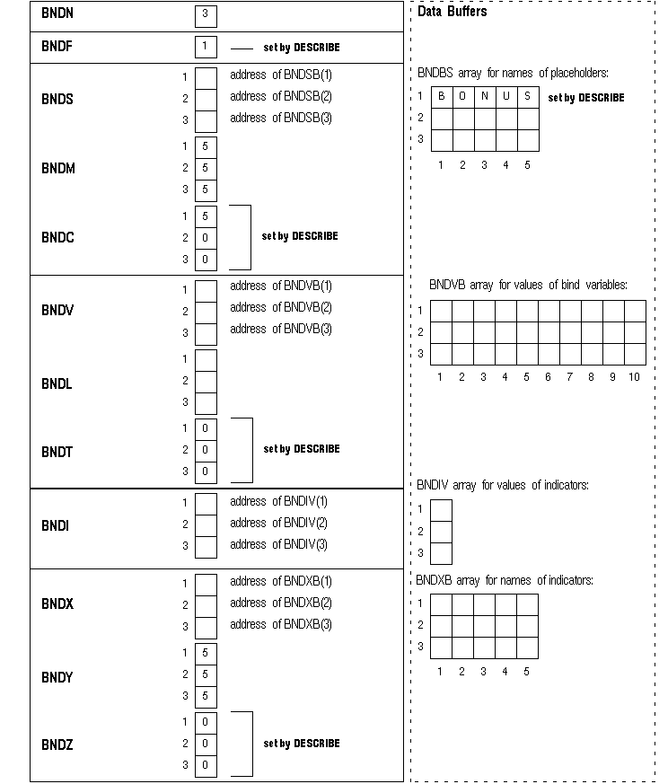

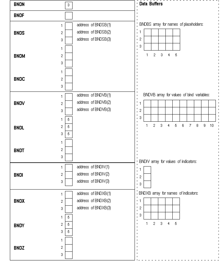

A bind descriptor holds descriptions of bind variables and indicator variables and the addresses of input buffers where the names and values of bind variables and indicator variables are stored.

You decide the names and sizes of the required data buffers. The variable and buffer names shown in Table 4 - 1 andTable 4 - 2, respectively, are used in the following discussion. For example, the elements of descriptor array SELS address the elements of data buffer array SELSB.
| Suffix | Host Datatype | Description |
| N | INTEGER var | maximum number of select-list items or placeholders |
| F | INTEGER var | actual number of select-list items or placeholders |
| S | INTEGER*4 var(n) | addresses of select-list or placeholder names |
| M | INTEGER*2 var(n) | maximum lengths of select-list or placeholder names |
| C | INTEGER*2 var(n) | actual lengths of select-list or placeholder names |
| L | INTEGER*4 var(n) | lengths of select-list or bind-variable values |
| T | INTEGER*2 var(n) | datatypes of select-list or bind-variable values |
| V | INTEGER*4 var(n) | addresses of select-list or bind-variable values |
| I | INTEGER*4 var(n) | addresses of indicator-variable values (1) |
| X (2) | INTEGER*4 var(n) | addresses of indicator-variable names (1) |
| Y (2) | INTEGER*2 var(n) | maximum lengths of indicator-variable names (1) |
| Z (2) | INTEGER*2 var(n) | actual lengths of indicator-variable names (1) |

| Buffer | Host Datatype | Description |
| SELSB | LOGICAL*1 var(m,n) | select-list names |
| SELVB | LOGICAL*1 var(m,n) | select-list names |
| SELIV | INTEGER*2 var(n) | indicator-variable values |
| BNDSB | LOGICAL*1 var(m,n) | placeholder names |
| BNDVB | LOGICAL*1 var(m,n) | bind-variable values |
| BNDXB | LOGICAL*1 var(m,n) | indicator-variable names |
| BNDIV | INTEGER*2 var(n) | indicator-variable names |

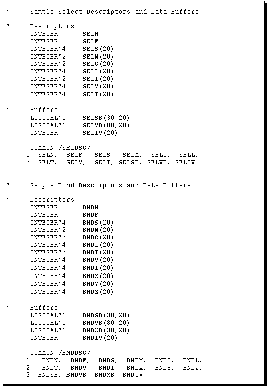

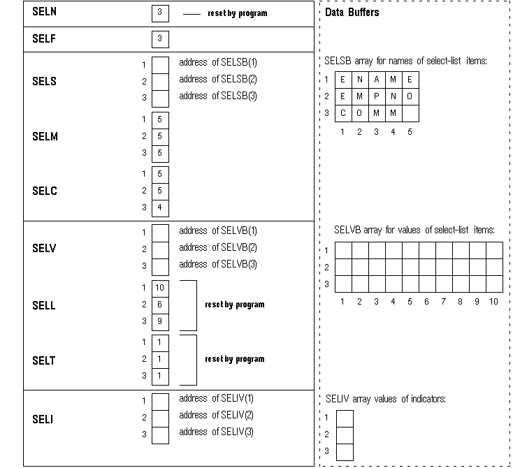

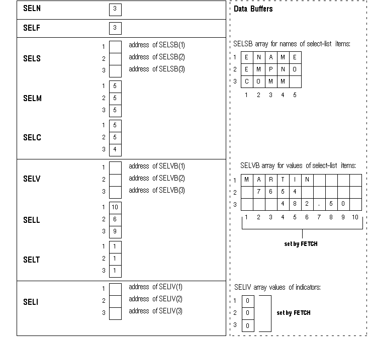

To declare select and bind SQLDAs, you can hardcode them into your program using the sample SQLDA shown in Figure 4-1.
Figure 4-1 Sample Pro*FORTRAN SQLDA Variables and Data Buffers
You can modify the array dimensions to suit your needs. The following example uses a parameter to specify array dimensions; which makes changing the dimensions easy:
INTEGER SIZE * Set dimension of descriptor arrays. PARAMETER (SIZE = 25) * Declare select descriptor. INTEGER SELN INTEGER SELF INTEGER*4 SELV(SIZE) INTEGER*4 SELL(SIZE) ...
You might want to store the SQLDAs in files (named SELDSC and BNDDSC, for example), revise them as needed, then copy the files into your program with the INCLUDE statement as follows:
* Declare select and bind SQLDAs. EXEC SQL INCLUDE SELDSC EXEC SQL INCLUDE BNDDSC
Because they are COMMON blocks, SQLDAs must be declared outside the Declare Section. How the data buffers are declared is up to you. You need not include them in the SQLDA COMMON blocks. For example, you might want to declare one large data buffer to store all names and values, then access them using byte offsets.

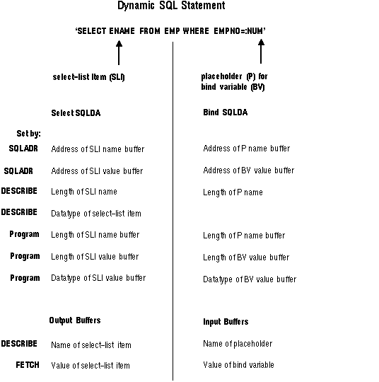

Figure 4-2 shows whether variables are set by SQLADR calls, DESCRIBE commands, FETCH commands, or program assignments.

This variable specifies the maximum number of select-list items or placeholders that can be DESCRIBEd. For example, SELN determines the number of elements in the select descriptor arrays.
Before issuing a DESCRIBE command, you must set this variable to the dimension of the descriptor arrays. After the DESCRIBE, you must reset it to the actual number of variables DESCRIBEd, which is stored in the F variable.
This is the actual number of select-list items or placeholders found by the DESCRIBE command.
The F variable is set by DESCRIBE. If the F variable is negative, the DESCRIBE command found too many select-list items or placeholders for the size of the descriptor. For example, if you set SELN to 10 but DESCRIBE finds 11 select-list items, SELF is set to -11. If this happens, you cannot process the SQL statement without reallocating the descriptor.
After the DESCRIBE command, you must set the N variable equal to the F variable.
This array contains the addresses of data buffers that store select-list or placeholder names as they appear in dynamic SQL statements.
You must set the elements of the S array using SQLADR before issuing the DESCRIBE command.
DESCRIBE directs Oracle to store the name of the Jth select-list item or placeholder in the buffer addressed by SELS(J) or BNDS(J). If the elements of SELS and BNDS address elements of data buffer arrays named SELSB and BNDSB, Oracle stores the Jth select-list or placeholder name in SELSB(J) or BNDSB(J).
This array contains the lengths of the data buffers that store select-list or placeholder names. The buffers are addressed by elements of the S array.
You must set the elements of the M array before issuing the DESCRIBE command. Each select-list or placeholder name buffer can have a different length.
This array contains the actual lengths of select-list or placeholder names. DESCRIBE sets the array of actual lengths to the number of characters in each select-list or placeholder name.
This array contains the lengths of select-list or bind-variable values stored in the data buffers.
DESCRIBE sets the array of lengths to the maximum expected for each select-list item. However, you might want to reset some lengths before issuing a FETCH command. FETCH returns at most n characters, where n is the value of SELL(J) before the FETCH.
The format of the length differs among Oracle datatypes. For character select-list items, DESCRIBE sets SELL(J) to the maximum length in bytes of the select-list item. For NUMBER select-list items, scale and precision are returned respectively in the low and next-higher bytes of the variable. You can use the library subroutine SQLPRC to extract precision and scale values from SELL. See the section Extracting Precision and Scale.
You must reset SELL(J) to the required length of the data buffer before the FETCH. For example, when coercing a NUMBER to a FORTRAN CHARACTER string, set SELL(J) to the precision of the number plus two for the sign and decimal point. When coercing a NUMBER to a FORTRAN REAL, set SELL(J) to the length of REALs on your system. For more information about the lengths of coerced datatypes, see the section "Converting Data".
You must set the array of lengths before issuing the OPEN command.
Because Oracle accesses a data buffer indirectly, using the address in SELV(J) or BNDV(J), it does not know the length of the value in that buffer. If you want to change the length Oracle uses for the Jth select-list or bind-variable value, reset SELL(J) or BNDL(J) to the length you need. Each input or output buffer can have a different length.
This array contains the datatype codes of select-list or bind-variable values. These codes determine how Oracle data is converted when stored in the data buffers addressed by elements of SELV. This topic is covered in the section "Converting Data".
DESCRIBE sets the array of datatype codes to the internal datatype (for example, VARCHAR2, CHAR, NUMBER, or DATE) of the items in the select list.
Before FETCHing, you might want to reset some datatypes because the internal format of Oracle datatypes can be difficult to handle. For display purposes, it is usually a good idea to coerce the datatype of select-list values to VARCHAR2. For calculations, you might want to coerce numbers from Oracle to FORTRAN format. See the section "Coercing Datatypes".
The high bit of SELT(J) is set to indicate the null/not null status of the Jth select-list column. You must always clear this bit before issuing an OPEN or FETCH command. You use the library subroutine SQLNUL to retrieve the datatype code and clear the null/not null bit. See the section "Handling Null/Not Null Datatypes".
You should change the Oracle NUMBER internal datatype to an external datatype compatible with that of the FORTRAN data buffer addressed by SELV(J).
DESCRIBE sets the array of datatype codes to zeros. You must reset the datatype code stored in each element before issuing the OPEN command. The code represents the external (FORTRAN) datatype of the data buffer addressed by BNDV(J). Often, bind-variable values are stored in character strings, so the datatype array elements are set to 1 (the VARCHAR2 datatype code).
To change the datatype of the Jth select-list or bind-variable value, reset SELT(J) or BNDT(J) to the datatype you want.

This array contains the addresses of data buffers that store indicator-variable names. You can associate indicator-variable values with select-list items and bind variables. However, you can associate indicator-variable names only with bind variables. So, you can use the X array only with bind descriptors.
You must set the elements of the X array using SQLADR before issuing the DESCRIBE command.
DESCRIBE directs Oracle to store any indicator-variable names in the buffers addressed by BNDX(1) through BNDX(BNDN). If the elements of BNDX address elements of a data buffer array named BNDXB, Oracle stores the Jth indicator-variable name in BNDXB(J).
This array contains the maximum lengths of the data buffers that store indicator-variable names. The buffers are addressed by elements of the X array. Like the X array, you can use the Y array only with bind descriptors.
You must set the elements BNDY(1) through BNDY(BNDN) before issuing the DESCRIBE command. Each indicator-variable name buffer can have a different length.

You must initialize several descriptor variables; some require the library subroutine SQLADR. In our example, you store the maximum lengths of name buffers in the M and Y arrays, and use SQLADR to store the addresses of value and name buffers in the V, S, I, and X arrays:
* Initialize select descriptor arrays. * Store addresses of select-list value and name * buffers in SELV and SELS, addresses of indicator * value buffers in SELI, and maximum length of * select-list name buffers in SELM. DO 100 J = 1, SELN CALL SQLADR (SELVB(1, J), SELV(J)) CALL SQLADR (SELSB(1, J), SELS(J)) CALL SQLADR (SELIV(J), SELI(J)) SELM(J) = 5 100 CONTINUE * Initialize bind descriptor arrays. * Store addresses of bind-variable value and name * buffers in BNDV and BNDS, addresses of indicator * value and name buffers in BNDI and BNDX, and maximum * lengths of placeholder and indicator name buffers in * BNDM and BNDY. DO 200 J = 1, BNDN CALL SQLADR (BNDVB(1, J), BNDV(J)) CALL SQLADR (BNDSB(1, J), BNDS(J)) CALL SQLADR (BNDIV(J), BNDI(J)) CALL SQLADR (BNDXB(1, J), BNDX(J)) BNDM(J) = 5 BNDY(J) = 5 200 CONTINUE ...
Figure 4-3 and Figure 4-4represent the resulting descriptors.

DESCRIBE BIND VARIABLES puts descriptions of bind variables into a bind descriptor. In our example, DESCRIBE readies BND as follows:
EXEC SQL DESCRIBE BIND VARIABLES FOR DYNSTMT INTO BND
The DESCRIBE BIND VARIABLES statement must follow the PREPARE statement but precede the OPEN statement.
Figure 4-5 shows the bind descriptor in our example after the DESCRIBE. Notice that DESCRIBE has set BNDF to the actual number of placeholders found in the processed SQL statement.
Figure 4-5 Bind Descriptor after the DESCRIBE

Your program must get values for the bind variables in the SQL statement. How the program gets the values is up to you. For example, they can be hard coded, read from a file, or entered interactively.
In our example, a value must be assigned to the bind variable that replaces the placeholder BONUS in the query's WHERE clause. Prompt the user for the value, then process it as follows:
CHARACTER*1 COLON COLON = ':' * BNDN was set equal to BNDF after the DESCRIBE. DO 500 J = 1, BNDN * Prompt user for value of bind variable. WRITE (*, 10200) (BNDSB(K,J), K = 1, BNDC(J)), COLON 10200 FORMAT (1X, 'Enter value for ', 6A1) * Get value for bind variable. READ (*, 10300) (BNDVB(K,J), K = 1, 10) 10300 FORMAT (10A1) * Find length of value by scanning backward for first * non-blank character. DO 200 K = 1, 10 IF (BNDVB(BNDL(J),J) .NE. ' ') GOTO 300 BNDL(J) = BNDL(J) - 1 200 CONTINUE * Set datatype of bind variable to VARCHAR2 (code 1), and set * indicator variable to NOT NULL. 300 BNDT(J) = 1 BNDIV(J) = 0 500 CONTINUE
Assuming that the user supplied a value of 625 for BONUS, Figure 4-6 shows the resulting bind descriptor.
Figure 4-6 Bind Descriptor After Assigning Values

Figure 4-7 shows the select descriptor in our example after the DESCRIBE. Notice that DESCRIBE has set SELF to the actual number of items found in the query select list. If the SQL statement is not a query, SELF is set to zero.
Also notice that the NUMBER lengths are not usable yet. For columns defined as NUMBER, you must use the library subroutine SQLPRC to extract precision and scale. See the section "Coercing Datatypes".
Figure 4-7 Select Descriptor after the DESCRIBE

In our example, before fetching the select-list values, you reset some elements in the length and datatype arrays for display purposes.
DO 500 J = 1, SELN * Clear null/not null bit. CALL SQLNUL (SELT(J), DATYPE, NULLOK) SELT(J) = DATYPE * If datatype is NUMBER, extract precision and scale. IF (SELT(J) .NE. 2) GOTO 400 CALL SQLPRC (SELL(J), PREC, SCALE) * Allow for maximum precision. IF (PREC .NE. 0) GOTO 200 * Although maximum precision is 38, we use 10 because * that is our buffer size. SELL(J) = 10 GOTO 400 200 CONTINUE SELL(J) = PREC * Allow for possible sign and decimal point. SELL(J) = SELL(J) + 2 * Adjust length if it exceeds size of buffer. This * applies to character as well as numeric data. 400 IF (SELL(J) .GT. 10) SELL(J) = 10 * Coerce datatype to VARCHAR2. SELT(J) = 1 500 CONTINUE
Figure 4-8 shows the resulting select descriptor. Notice that the NUMBER lengths are now usable and that all the datatypes are VARCHAR2. The lengths in SELL(2) and SELL(3) are 6 and 9 because we increased the DESCRIBEd lengths of 4 and 7 by two to allow for a possible sign and decimal point.
Note: When the datatype code returned by DESCRIBE is 2 (NUMBER), it must be coerced to a compatible FORTRAN type. The FORTRAN type need not be CHARACTER. For example, you can coerce a NUMBER to a REAL by setting SELT(J) to 4, and SELL(J) to the length of REALs on your system.
Figure 4-8 Select Descriptor before the FETCH
FETCH returns a row from the active set, stores select-list values in the data buffers, and advances the cursor to the next row in the active set. If there are no more rows, FETCH sets SQLCDE in the SQLCA, the SQLCODE variable, or the SQLSTATE variable to the "no data found" Oracle error code. In the following example, FETCH returns the values of columns ENAME, EMPNO, and COMM to SEL:
EXEC SQL FETCH EMPCUR USING DESCRIPTOR SEL
Figure 4-9 shows the select descriptor in our example after the FETCH. Notice that Oracle has stored the select-list and indicator values in the data buffers addressed by the elements of SELV and SELI.
For output buffers of datatype 1, Oracle, using the lengths stored in SELL, left-justifies CHAR or VARCHAR2 data, and right-justifies NUMBER data.
The value 'MARTIN' was retrieved from a VARCHAR2(10) column in the EMP table. Using the length in SELL(1), Oracle left-justifies the value in a 10-byte field, filling the buffer.
The value 7654 was retrieved from a NUMBER(4) column and coerced to "7654." However, the length in SELL(2) was increased by two to allow for a possible sign and decimal point, so Oracle right-justifies the value in a 6-byte field.
The value 482.50 was retrieved from a NUMBER(7,2) column and coerced to "482.50." Again, the length in SELL(3) was increased by two, so Oracle right-justifies the value in a 9-byte field.
After the FETCH, your program can process the select-list values returned by FETCH. In our example, values for columns ENAME, EMPNO, and COMM are processed.

This program shows the basic steps required to use dynamic SQL Method 4. After logging on to Oracle, the program prompts the user for a SQL statement, PREPAREs the statement, DECLAREs a cursor, checks for any bind variables using DESCRIBE BIND, OPENs the cursor, and DESCRIBEs any select-list items. If the input SQL statement is a query, the program FETCHes each row of data, then CLOSEs the cursor. Notice that a VARCHAR is used to store the dynamic SQL statement.
PROGRAM DYN4
EXEC SQL BEGIN DECLARE SECTION
CHARACTER*20 UID
CHARACTER*20 PWD
VARCHAR *1024 STMT, STMTL, STMTA
EXEC SQL END DECLARE SECTION
CHARACTER*1 ANS
EXEC SQL INCLUDE SQLCA
