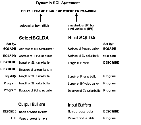

All the information Oracle needs about select-list items or placeholders for bind variables, except their actual values, is stored in a program data structure called the SQL Descriptor Area (SQLDA).
Descriptions of select-list items are stored in a select descriptor, and descriptions of bind variables are stored in a bind descriptor.
The values of select-list items are stored in output variables; the values of bind variables are stored in input variables. You store the addresses of these variables in a select or bind SQLDA so that Oracle knows where to write output values and read input values.
How do values get stored in these variables? Output values are FETCHed using a cursor, and input values are typically filled in by the program, often from information entered interactively by the user.
DESCRIBE helps you provide the information Oracle needs by storing descriptions of select-list items or placeholders in a SQLDA.
You use the DESCRIBE statement to help obtain the information Oracle needs.
The DESCRIBE SELECT LIST statement examines each select-list item and determines its name, datatype, constraints, length, scale, and precision. It then stores this information in the select SQLDA, and in program variables pointed to by fields in the SQLDA. The total number of select-list items is also stored in the SQLDA by the DESCRIBE statement.

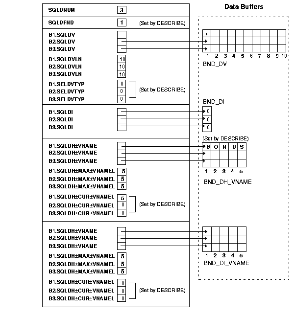

The DESCRIBE BIND VARIABLES statement obtains the number of placeholders in the SQL statement, and the names and lengths of each placeholder. The program must then fill in the datatype and length of the associated bind variables in the SQLDA, and obtain the bind variable values, which are stored in the program variables pointed to by fields in the SQLDA.

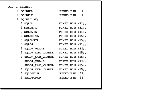

The SQLDA is a PL/1 structure that contains two top-level elements and an array of substructures. Each substructure contains information about a single input or output variable. You declare a separate SQLDA major structure for the select-list items, and for the bind (or input) variables. These are called the select descriptor and the bind descriptor.
All SQLDA elements that hold an address are declared as FIXED BINARY (31). This datatype, rather than the more natural PL/1 POINTER type, is used to achieve compatibility among different implementations of PL/1. You initialize these elements using the SQLADR procedure. The syntax of this procedure call is
CALL SQLADR(YOUR_BUFFER_ADDRESS, SQLDA_ELEMENT_ADDRESS);
as shown in the following example:
DCL SELECT_DATA_VALUE CHARACTER (10); DCL SQLADR EXTERNAL ENTRY(PTR VALUE, PTR VALUE); ... CALL SQLADR(ADDR(SELECT_DATA_VALUE), ADDR(SELDSC.SQLDSC(1).SQLDV));
In this example, the address of the buffer SELECT_DATA_VALUE is stored in the SQLDV element in the first substructure of the array SQLDSC.
Under IBM operating systems (MVS and VM/CMS), there is an alternate form of SQLADR called SQ3ADR. With SQ3ADR, the arguments are passed without using the PL/1 ADDR built-in function. See "Sample 10: Dynamic SQL Method 4 Program" to see how to use SQ3ADR.The SQLDVLN and SQLDVTYP elements contain the length and the datatype code for the select-list item or the bind variable. For a select descriptor, these elements are set when the SQL DESCRIBE statement is executed. You may reset them before actually fetching the values. For more information, see the later section "The SQLDA Variables." For a bind descriptor, you must set the length and datatype.
To declare a SQLDA, copy it into your program with the statement
EXEC SQL INCLUDE DESCRIPTOR_NAME;
where, DESCRIPTOR_NAME is the name of the file containing the text of the descriptor declaration. Or hardcode it as shown.

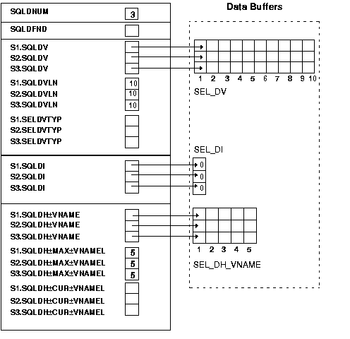

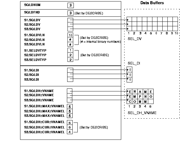

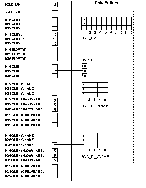

Figure 5-1 shows a SQLDA named SELDSC. It is a select descriptor. A bind descriptor is identical.
In the examples used in this section, the structures are named SELDSC for the select SQLDA, and BNDDSC for the bind SQLDA. These structures are identical, except for their names.
shows whether variables are set by calls to SQLADR, DESCRIBE commands, FETCH commands, or program assignments.

Contains the number of bind variables or select-list items that can be DESCRIBEd. Before issuing a DESCRIBE statement, your program must set this variable to the maximum size of the SQLDSC substructure array. After the DESCRIBE, SQLDNUM must be reset to the actual number of variables described, which is contained in SQLDFND.
Set when Oracle performs a DESCRIBE statement. It contains the number of bind variables or select-list items DESCRIBEd. If after a DESCRIBE, SQLDFND is less than 0, there were more bind variables or select-list items than specified in SQLDNUM. In this case, SQLDFND is set to the negative of the number of variables DESCRIBEd. For example, if SQLDNUM is 10, and SQLDFND contains the value -11 after a DESCRIBE, 11 select-list items or bind variables were found. If this happens, you cannot process the statement.

Select Descriptor Oracle sets this element when it executes the DESCRIBE statement. It contains the length of the select-list value. The format of the length differs among Oracle datatypes. For character datatypes (VARCHAR2 and CHAR), SQLDVLN is set to the number of bytes in the select-list item. For NUMBER datatypes, the scale is returned in the low-order byte of the variable, and the precision in the next highest-order byte.
If, for a NUMBER datatype, SQLDVLN is set to zero, this means that the column in the table was established with no explicit precision and scale, or the precision and scale for the select-list expression was not determined. In this case, you must decide on an appropriate value (between 0 and 38) and put it in SQLDVLN before the FETCH.
For maximum portability, use the SQLPRC or SQLPR2 library procedures (described in the "Datatypes in the SQLDA" section later in this chapter) to retrieve the precision and scale values from SQLDVLN.

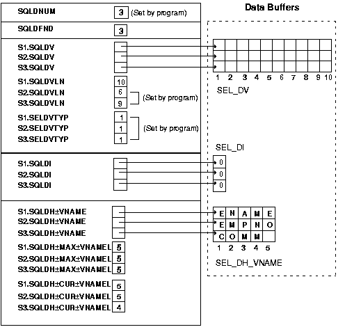

You must reset SQLDVLN to the required length of the data buffer before executing the FETCH statement. For example, if you coerce a described NUMBER to a PL/1 CHARACTER string, set SQLDVLN to the precision of the number, and add two to account for the sign and decimal point.
If you coerce a NUMBER to a PL/1 FLOAT, set SQLDVLN to the length in bytes of the appropriate FLOAT type in your implementation of PL/1 (usually 4 for a FLOAT(7) or less, and 8 for a FLOAT(8) or greater). See the "Datatypes in the SQLDA" section later in this chapter for more information about the lengths of coerced datatypes.
Bind Descriptor Your program must set the correct SQLDVLN value, which is the length in bytes of the bind variable data buffer that SQLDV points to. Set the length before executing the OPEN statement.
Select Descriptor Oracle sets this element when it performs the DESCRIBE statement. It contains the datatype code for the select-list value. This datatype code determines how the Oracle data will be converted into the PL/1 data buffer or variable that SQLDV points to. This topic is covered in detail in the "Datatypes in the SQLDA" section later in this chapter.
In a select descriptor, the high-order bit of this element is set to indicate the NULL/NOT NULL status of the field. You should retrieve the datatype code using the SQLNUL procedure. See the "Handling NULL/NOT NULL Datatypes" section later in this chapter for a description of this procedure.Bind Descriptor The DESCRIBE statement sets this element to zero. You must set the datatype code in this element before executing the OPEN statement. The code indicates the external PL/1 type of the buffer or variable that SQLDV points to. Refer to the section "Datatypes in the SQLDA" later in this chapter for more information on the datatype codes.
Holds the address of an indicator variable, declared in your program. The indicator variable must be a FIXED BIN(15).
You put the address in this element using the SQLADR procedure.

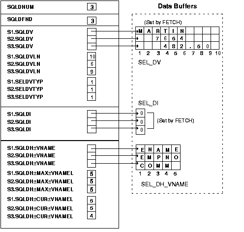

Select Descriptor You must initialize this element before doing a FETCH. Oracle sets the indicator values after fetching select-list items.
For select descriptors, when Oracle executes the statement
EXEC SQL FETCH ... USING DESCRIPTOR SELDSC;
if the Jth returned select-list item is NULL, the indicator-variable value to which SELDSC.SQLDSC(J).SQLDI points is set to -1. If not NULL, it is set to zero or a positive integer.

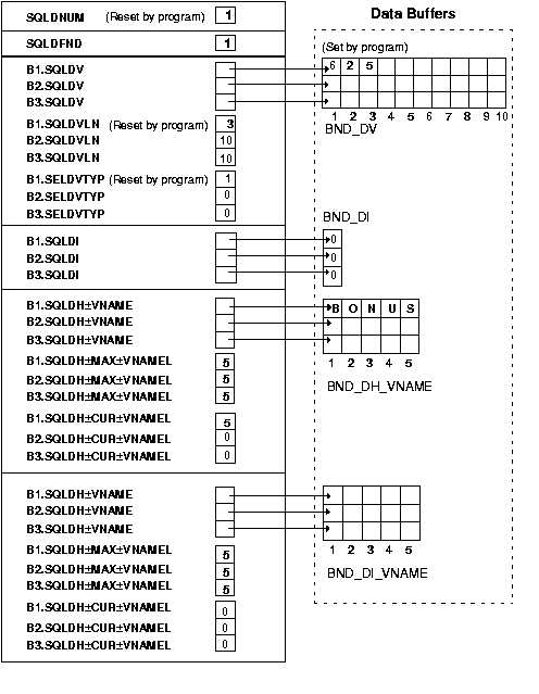

Bind Descriptor You must initialize this element and set the variable values before doing an OPEN.
For bind descriptors, when Oracle executes the statement
EXEC SQL OPEN ... USING DESCRIPTOR BNDDSC;
the indicator-variable value to which BNDDSC.SQLDSC(J).SQLDI points determines whether the Jth bind variable is NULL. If the value of an indicator variable is -1, the value of its associated variable is NULL.
Holds the address of a buffer used to store the name of a select-list item (for select descriptors) or the name of a bind variable (for bind descriptors). After a DESCRIBE, the appropriate names will be placed in the strings pointed to by the SQLDH_VNAME elements.
Your host program code must initialize the SQLDH_VNAME elements with the addresses of the strings you have declared before executing the DESCRIBE statement. Use the SQLADR procedure to do this initialization.
Contains the maximum length of the buffer pointed to by SQLDH_VNAME. Your program must set this value before issuing a DESCRIBE statement. A value placed in the string pointed to by SQLDH_VNAME will be truncated to this length if necessary.
Contains the actual number of characters in the string pointed to by SQLDH_VNAME after a DESCRIBE.
Holds the address of a string that stores the name of a bind indicator variable. It is set using SQLADR. It must be set before the DESCRIBE statement is executed. This element is not used in a select descriptor.
Contains the maximum number of characters in the SQLDI_VNAME string. Your program must initialize this value before performing a DESCRIBE statement. A value placed in the string pointed to by SQLDI_VNAME will be truncated to this length if necessary. This element is not used in a select descriptor.

But, when you write a Dynamic Method 4 program, you must specify the conversion by doing the following:
set the datatype code for each bind variable in the bind descriptor
change some of the datatype codes that Oracle returns when you DESCRIBE a select list into a select descriptor

Before you include the files that contain the select and bind descriptor declarations, you should set the size of the descriptor in each file. This is set by changing the N variable for the SQLDSC array of substructures.
You normally set this to a value high enough to accommodate the maximum number of select-list items and bind variables that you expect to have to process. The program will not be able to process the SQL statement if there are more select-list items or bind variables than the number of substructures. In our example, a low number of three is used so that the structures can be easily illustrated.
Use INCLUDE to copy the files containing the SQLDA declarations into your program, as follows:
EXEC SQL INCLUDE SELDSC; /* select descriptor */ EXEC SQL INCLUDE BNDDSC; /* bind descriptor */

You must initialize several elements in each descriptor. Some are simply set to numeric values; some require the library procedure SQLADR to place an address in the element.
In our example, you first initialize the select descriptor. Set SQLDNUM to the number of substructures (3). Then, in each substructure, set the SQLDH_MAX_VNAMEL element to the length (5) of the name data buffer (SEL_DH_VNAME). Set the SQLDVLN element to the length (10) of the value data buffer (SEL_DV). Put the addresses of the data buffers in the SQLDH_VNAME, SQLDV, and SQLDI elements using SQLADR. Finally, set the reserved and unused elements to zero.
SELDSC.SQLDNUM = 3; DO J = 1 TO SELDSC.SQLDNUM; SELDSC.SQLDSC(J).SQLDH_MAX_VNAMEL = 5; SELDSC.SQLDSC(J).SQLDVLN = 10; /* setup the pointers */ CALL SQLADR(ADDR(SEL_DH_VNAME(J)), ADDR(SELDSC.SQLDSC(J).SQLDH_VNAME)); CALL SQLADR(ADDR(SEL_DV(J)), ADDR(SELDSC.SQLDSC(J).SQLDV)); CALL SQLADR(ADDR(SEL_DI(J)), ADDR(SELDSC.SQLDSC(J).SQLDI)); /* initialize unused elements to 0 */ SEL_DI(J) = 0; SELDSC.SQLDSC(J).SQLDFMT = 0; SELDSC.SQLDSC(J).SQLDFCLP = 0; SELDSC.SQLDSC(J).SQLDFCRCP = 0; END;
The bind descriptor is initialized in almost the same way. The difference is that SQLDI_MAX_VNAMEL must also be initialized.
BNDDSC.SQLDNUM = 3; DO J = 1 TO BNDDSC.SQLDNUM; BNDDSC.SQLDSC(J).SQLDH_MAX_VNAMEL = 5; BNDDSC.SQLDSC(J).SQLDVLN = 10; /* length of indicator variable name */ BNDDSC.SQLDSC(J).SQLDI_MAX_VNAMEL = 5; /* setup the pointers */ CALL SQLADR(ADDR(BND_DH_VNAME(J)), ADDR(BNDDSC.SQLDSC(J).SQLDH_VNAME)); /* address of indicator variable name */ CALL SQLADR(ADDR(BND_DI_VNAME(J)), ADDR(BNDDSC.SQLDSC(J).SQLDI_VNAME)); CALL SQLADR(ADDR(BND_DV(J)), ADDR(BNDDSC.SQLDSC(J).SQLDV)); CALL SQLADR(ADDR(BND_DI(J)), ADDR(BNDDSC.SQLDSC(J).SQLDI)); /* set unused elements to 0 */ BND_DI(J) = 0; BNDDSC.SQLDSC(J).SQLDFMT = 0; BNDDSC.SQLDSC(J).SQLDFCLP = 0; BNDDSC.SQLDSC(J).SQLDFCRCP = 0; END;
The descriptors that result after the initialization are shown in Figure 5-3 and Figure 5-4. In these pictures, the left-hand box represents the descriptor structure, and the boxes on the right represent the data buffers (such as SEL_DV) that you declared in your program. The arrows represent pointers, showing which data buffers the SQLDA elements point to.
The data buffers are empty after initialization (except SEL_DI and BND_DI, which were set to zero in the preceeding example code). As our example progresses, and the DESCRIBE or FETCH statements begin to fill in the data buffers, the values will be shown in later figures. Whenever these boxes are empty, it indicates that the variable is either uninitialized or was not filled in by a DESCRIBE or FETCH statement. Unused or reserved fields in the descriptors (SQLDFMT, SQLDFMTL, SQLDFCLP, and SQLDFCRCP) are not shown in these figures.
To save space, the SQLDA element names in the left hand columns of Figure 5-3 through 5-9 are abbreviated. Each structure element name must be preceded by the structure and substructure names. For example, S2.SQLDV must be written as SELDSC.SQLDSC(2).SQLDV in the PL/1 code. B3.SQLDVTYP stands for BNDDSC.SQLDSC(3).SQLDVTYP.Continuing our example, you prompt the user for a SQL statement, and then store the input in SELECT_STMT.

EXEC SQL DESCRIBE BIND VARIABLES FOR SQL_STMT INTO BNDDSC;
Note that BNDDSC must not be prefixed with a colon.
The DESCRIBE BIND VARIABLES statement must follow the PREPARE statement but precede the OPEN statement.
Figure 5-5 shows the bind descriptor in our example after the DESCRIBE. Notice that DESCRIBE has set SQLDFND to the actual number of input bind variables found in the query's WHERE clause.
Figure 5-5 Bind Descriptor After the DESCRIBE

Your program must get values for any bind variables found in the SQL statement. In our example, a value must be assigned to the placeholder BONUS in the query's WHERE clause. So, you prompt the user for the value, and then process it as follows:
DCL (BN, BV) POINTER,
BNAME CHARACTER (10) BASED(BN),
BVAL CHARACTER (10) BASED(BV);
PUT SKIP LIST ('Enter values of bind variables');
/* Display the name. Use UNSPEC to get an integer
(really a pointer) into the buffer pointer. */
UNSPEC(BN) = UNSPEC(BNDDSC.SQLDSC(J).SQLDH_VNAME);
PUT SKIP EDIT (BN->BNAME, ': ')
(A(BNDDSC.SQLDSC(J).SQLDH_CUR_VNAMEL),A(2));
/* Get bind variable value from user. */
UNSPEC(BV) = UNSPEC(BNDDSC.SQLDSC(J).SQLDV);
GET LIST (BV->BVAL);
/* Set the length. */
BNDDSC.SQLDSC(J).SQLDVLN = LENGTH(BV->BVAL);
/* Make the datatype VARCHAR2. */
BNDDSC.SQLDSC(J).SQLDVTYP = 1;
END;
Assuming that the user supplied a value of 625 for BONUS, Figure 5-6 shows the resulting bind descriptor.
Figure 5-6 Bind Descriptor After Assigning Values

Accessing the data dictionary, DESCRIBE sets the length and datatype of each select-list item.
shows the select descriptor in our example after the DESCRIBE. Notice that DESCRIBE has set SQLDFND to the actual number of items found in the query's select list.
Also notice that the NUMBER lengths in the second and third SQLDVLN elements are not usable yet. For select-list items defined as NUMBER, you should use the library procedure SQLPRC to extract precision and scale, as explained in the next section.
Figure 5-7 Select Descriptor After the DESCRIBE

In our example, before FETCHing the select-list values, you reset some length elements for display purposes. You also reset the datatype value to avoid dealing with Oracle datatypes.
... DCL J FIXED BIN(15), (SCALE, PRECISION) FIXED BIN(31); DCL SQLPRC EXTERNAL ENTRY(ANY, ANY, ANY); ... /* Process each field value */ DO J = 1 TO SELDSC.SQLDNUM; /* If the datatype is NUMBER (datatype code 2) extra processing is required. */ IF SELDSC.SQLDSC(J).SQLDVTYP = 2 THEN DO; /* get precision and scale */ CALL SQLPRC(SELDSC.SQLDSC(J).SQLDVLN, PRECISION, SCALE); /* Allow for the size of a number with no precision in the table. */ IF PRECISION = 0 THEN PRECISION = 6; SELDSC.SQLDSC(J).SQLDVLN = PRECISION + 2; IF SCALE <0 THEN SELDSC.SQLDSC(J).SQLDVLN = SELDSC.SQLDSC(J).SQLDVLN + (-SCALE); END; /* If datatype is a DATE (datatype code 12) set length to 9. */ IF SELDSC.SQLDSC(J).SQLDVTYP = 12 THEN SELDSC.SQLDSC(J).SQLDVLN = 9; /* Coerce all datatypes to VARCHAR2. */ SELDSC.SQLDSC(J).SQLDVTYP = 1; END;
shows the resulting select descriptor. Notice that the lengths for the buffers that will hold the EMPNO and COMM fields are set to 6 and 9. These values were set in the preceeding DO-loop from the EMP table column lengths of 4 and 7 by the statement that adds 2 to PRECISION (for possible minus sign and decimal point). Notice also that the datatypes are set to 1 (VARCHAR2).
Figure 5-8 Select Descriptor Before the FETCH

... EXEC SQL WHENEVER NOT FOUND GOTO N_FND; NXT_ROW: EXEC SQL FETCH EMP_CURSOR USING DESCRIPTOR SELDSC; CALL PRINT_ROW(SELDSC); /* proc. to print values */ GOTO NXT_ROW; N_FND: ...
shows the select descriptor in our example after the FETCH. Notice that Oracle has stored the column and indicator-variable values in the data buffers pointed to by the descriptor.
Figure 5-9 Select Descriptor After the FETCH
After the FETCH, your program can scan the select descriptor for the select-list values returned by FETCH and process them. In our example, values for columns ENAME, EMPNO, and COMM can be processed.
Note how Oracle converts these values into the SEL_DV data buffers. The select-list value 'MARTIN' is from an Oracle VARCHAR2 column. It is left justified in the 10-byte field of SEL_DV(1).
The EMPNO value is a NUMBER(4) in the Oracle table. The program adds 2 to this (for decimal point and possible sign), resulting in a length of 6. Since EMPNO is a NUMBER, the value '7654' is right justified in a 6-byte field in the output buffer.
The COMM column has a length of 7. The program adds 2 (for decimal point and sign) for a total length of 9. The value '482.50' is right justified on conversion into the 9-byte field of SEL_DV(3).

* STEP 16 -- Process the select-list items.
PRINT_ROW: PROCEDURE (SELDSC);
DCL BLANKS FIXED BINARY (15),
DI POINTER,
I FIXED BINARY (15),
LINE CHARACTER(132) BASED(P),
P POINTER,
SELDI FIXED BINARY (15) BASED(DI);
DO I = 1 TO SELDSC.SQLDNUM;
/* Check if the select-list item is NULL. */
UNSPEC(DI) = UNSPEC(SELDSC.SQLDSC(I).SQLDI);
IF DI ->> SELDI << 0 THEN
/* This item is NULL. Set the length of
buf to zero so output spacing (blank pad)
comes out correctly. */
SELDSC.SQLDSC(I).SQLDVLN = 0;
/* Compute number of required blanks
for appropriate spacing. */
BLANKS = MAX( MAX(SELDSC.SQLDSC(I).SQLDH_CUR_VNAMEL,
SELDSC.SQLDSC(I).SQLDVLN), 9) -
SELDSC.SQLDSC(I).SQLDVLN;
/* Print column value, with blank padding. */
UNSPEC(P) = UNSPEC(SELDSC.SQLDSC(I).SQLDV);
PUT EDIT ( P ->> LINE, ' ')
(A(SELDSC.SQLDSC(I).SQLDVLN), X(BLANKS), A(1));
END;
PUT SKIP;
END PRINT_ROW;

* STEP 5 -- Initialize the select and bind descriptors.
DO I = 1 TO 20;
SELDSC.SQLDSC(I).SQLDH_MAX_VNAMEL = 80;
EXEC Oracle IFDEF SQ3LIB;
CALL SQ3ADR
(SEL_DH_VNAME(I),SELDSC.SQLDSC(I).SQLDH_VNAME);
EXEC Oracle ELSE;
CALL SQLADR
(ADDR(SEL_DH_VNAME(I)),
ADDR(SELDSC.SQLDSC(I).SQLDH_VNAME));
EXEC Oracle ENDIF;
SELDSC.SQLDSC(I).SQLDI_MAX_VNAMEL = 80;
SELDSC.SQLDSC(I).SQLDVLN = 80;
CALL SQ3ADR(SEL_DV(I),SELDSC.SQLDSC(I).SQLDV);
EXEC Oracle ELSE;
CALL SQLADR
(ADDR(SEL_DV(I)), ADDR(SELDSC.SQLDSC(I).SQLDV));
EXEC Oracle ENDIF;
SEL_DI(I) = 0;
CALL SQ3ADR(SEL_DI(I),SELDSC.SQLDSC(I).SQLDI);
EXEC Oracle ELSE;
CALL SQLADR
(ADDR(SEL_DI(I)), ADDR(SELDSC.SQLDSC(I).SQLDI));
EXEC Oracle ENDIF;
SELDSC.SQLDSC(I).SQLDFMT = 0;
SELDSC.SQLDSC(I).SQLDFCLP = 0;
SELDSC.SQLDSC(I).SQLDFCRCP = 0;
END;
DO I = 1 TO 20;
BNDDSC.SQLDSC(I).SQLDH_MAX_VNAMEL = 80;
CALL SQ3ADR
(BND_DH_VNAME(I),BNDDSC.SQLDSC(I).SQLDH_VNAME);
EXEC Oracle ELSE;
CALL SQLADR
(ADDR(BND_DH_VNAME(I)),
ADDR(BNDDSC.SQLDSC(I).SQLDH_VNAME));
EXEC Oracle ENDIF;
BNDDSC.SQLDSC(I).SQLDI_MAX_VNAMEL = 80;
CALL SQ3ADR
(BND_DI_VNAME(I),BNDDSC.SQLDSC(I).SQLDI_VNAME);
EXEC Oracle ELSE;
CALL SQLADR
(ADDR(BND_DI_VNAME(I)),
ADDR(BNDDSC.SQLDSC(I).SQLDI_VNAME));
EXEC Oracle ENDIF;
BNDDSC.SQLDSC(I).SQLDVLN = 80;
CALL SQ3ADR(BND_DV(I),BNDDSC.SQLDSC(I).SQLDV);
EXEC Oracle ELSE;
CALL SQLADR
(ADDR(BND_DV(I)), ADDR(BNDDSC.SQLDSC(I).SQLDV));
EXEC Oracle ENDIF;
BND_DI(I) = 0;
CALL SQ3ADR(BND_DI(I),BNDDSC.SQLDSC(I).SQLDI);
EXEC Oracle ELSE;
CALL SQLADR
(ADDR(BND_DI(I)), ADDR(BNDDSC.SQLDSC(I).SQLDI));
EXEC Oracle ENDIF;
BNDDSC.SQLDSC(I).SQLDFMT = 0;
BNDDSC.SQLDSC(I).SQLDFCLP = 0;
BNDDSC.SQLDSC(I).SQLDFCRCP = 0;
END;

* STEP 9 -- Describe the bind variables
* in this SQL statement.
BNDDSC.SQLDNUM = 20;
EXEC SQL DESCRIBE BIND VARIABLES FOR S INTO BNDDSC;
IF BNDDSC.SQLDFND << 0 THEN DO;
PUT SKIP LIST ('Too many Bind Vars in this SQL stmt.');
PUT LIST (' Try again...');
GOTO NXT_STM;
END;
* STEP 10 -- Reset N of bind variables.
BNDDSC.SQLDNUM = BNDDSC.SQLDFND;
IF BNDDSC.SQLDNUM ^= 0 THEN
CALL GET_BIND_VARS (BNDDSC); /* do STEP 11 */
* STEP 12 -- Open the cursor using the bind descriptor.
EXEC SQL OPEN C USING DESCRIPTOR BNDDSC;
