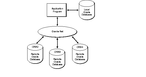

The communicating points in a network are called nodes. Oracle Net lets you transmit information (SQL statements, data, and status codes) over the network from one node to another.
A protocol is a set of rules for accessing a network. The rules establish such things as procedures for recovering after a failure and formats for transmitting data and checking errors.
The Oracle Net syntax for connecting to the default database in the local domain is simply to use the service name for the database.
If the service name is not in the default (local) domain, you must use a global specification (all domains specified). For example:
HR.US.ORACLE.COM
Pro*C/C++ supports distributed processing through Oracle Net. Your application can concurrently access any combination of local and remote databases or make multiple connections to the same database. In Figure 3-1, an application program communicates with one local and three remote Oracle databases. ORA2, ORA3, and ORA4 are simply logical names used in CONNECT statements.
By eliminating the boundaries in a network between different machines and operating systems, Oracle Net provides a distributed processing environment for Oracle tools. This section shows you how Pro*C/C++ supports distributed processing through Oracle Net. You learn how your application can
Directly or indirectly access other databases
Concurrently access any combination of local and remote databases
Make multiple connections to the same database
For details on installing Oracle Net and identifying available databases, refer to the Oracle Net Services Administrator's Guide and your system-specific Oracle documentation.

EXEC SQL CREATE DATABASE LINK db_link1 CONNECT TO username1 IDENTIFIED BY password1 USING 'NYNON'; EXEC SQL CREATE DATABASE LINK db_link2 CONNECT TO username2 IDENTIFIED BY password2 USING 'CHINON'; EXEC SQL CREATE SYNONYM emp FOR emp@db_link1; EXEC SQL CREATE SYNONYM dept FOR dept@db_link2;
Then, your program can query the nondefault EMP and DEPT tables, as follows:
EXEC SQL SELECT ENAME, JOB, SAL, LOC FROM emp, dept WHERE emp.DEPTNO = dept.DEPTNO AND DEPTNO = :dept_number;
Oracle executes the query by performing a join between the nondefault EMP table at db_link1 and the nondefault DEPT table at db_link2.
