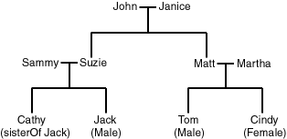

This section presents a simplified PL/SQL example of an RDF model for statements about family tree (genealogy) information. Example 1-8 contains descriptive comments, refer to concepts that are explained in this chapter, and uses functions and procedures documented in Chapter 2 and Chapter 3.
The family relationships in this example reflect the family tree shown in Figure 1-1. This figure also shows some of the information directly stated in the example: Cathy is the sister of Jack, Jack and Tom are male, and Cindy is female.
Example 1-9 Using an RDF Model for Family Information
-- Basic steps:

-- Insert rows into the table. These express the following information:
-- John and Janice have two children, Suzie and Matt.
-- Matt married Martha, and they have two children:
-- Tom (male, height 5.75) and Cindy (female, height 06.00).
-- Suzie married Sammy, and they have two children:
-- Cathy (height 5.8) and Jack (male, height 6).
-- Person is a class that has two subslasses: Male and Female.

-- General inferencing in the family model
EXECUTE SDO_RDF_INFERENCE.CREATE_RULEBASE('family_rb');
INSERT INTO mdsys.rdfr_family_rb VALUES(
'grandparent_rule',
'(?x :parentOf ?y) (?y :parentOf ?z)',
NULL,
'(?x :grandParentOf ?z)',
SDO_RDF_Aliases(SDO_RDF_Alias('','http://www.example.org/family/')));
COMMIT;
-- Because a new rulebase has been created, and it will be used in the
-- rules index, drop the preceding rules index and then re-create it.
EXECUTE SDO_RDF_INFERENCE.DROP_RULES_INDEX ('rdfs_rix_family');
-- Re-create the rules index.
BEGIN
SDO_RDF_INFERENCE.CREATE_RULES_INDEX(
'rdfs_rix_family',
SDO_RDF_Models('family'),
SDO_RDF_Rulebases('RDFS','family_rb'));
END;
-- Select all grandfathers and their grandchildren from the family model,
-- without inferencing. (With no inferencing, no results are returned.)
SELECT x grandfather, y grandchild
FROM TABLE(SDO_RDF_MATCH(
'(?x :grandParentOf ?y) (?x rdf:type :Male)',
null,
SDO_RDF_Aliases(SDO_RDF_Alias('','http://www.example.org/family/')),
null));
-- Select all grandfathers and their grandchildren from the family model.
-- Use inferencing from both the RDFS and family_rb rulebases.
SDO_RDF_Rulebases('RDFS','family_rb'),
null));
-- Set up to find grandfathers of tall (>= 6) grandchildren
-- from the family model, with RDFS inferencing and
-- inferencing using the "family_rb" rulebase.
UPDATE mdsys.rdfr_family_rb SET
antecedents = '(?x :parentOf ?y) (?y :parentOf ?z) (?z :height ?h)',
filter = '(h >= 6)',
aliases = SDO_RDF_Aliases(SDO_RDF_Alias('','http://www.example.org/family/'))
WHERE rule_name = 'GRANDPARENT_RULE';
-- Because the rulebase has been updated, drop the preceding rules index,
-- and then re-create it.
BEGIN
'rdfs_rix_family',
END;
-- Find the rules index that was just created (that is, the
-- one based on the specified model and rulebases).
SELECT SDO_RDF_INFERENCE.LOOKUP_RULES_INDEX(SDO_RDF_MODELS('family'),
SDO_RDF_RULEBASES('RDFS','family_rb')) AS lookup_rules_index FROM DUAL;
-- Select grandfathers of tall (>= 6) grandchildren, and their
-- tall grandchildren.
SDO_RDF_RuleBases('RDFS','family_rb'),
null));
