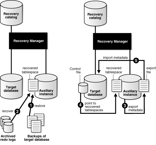

Figure 8-1, "Tablespace Point-in-Time Recovery (TSPITR) Architecture" illustrates the context within which TSPITR takes place, and a general outline of the process.
Figure 8-1 Tablespace Point-in-Time Recovery (TSPITR) Architecture
The figure contains the following entities:
The target instance, containing the tablespace to be recovered
The Recovery Manager client
The control file and (optional) recovery catalog, used for the RMAN repository records of backup activity
Archived redo logs and backup sets from the target database, which are the source of the reconstructed tablespace.
The auxiliary instance, an Oracle database instance used in the recovery process to perform the actual work of recovery.
There are four other important terms related to TSPITR, which will be used in the rest of this discussion:
The target time, the point in time or SCN that the tablespace will be left at after TSPITR
The recovery set, which consists of the datafiles containing the tablespaces to be recovered;
The auxiliary set, which includes datafiles required for TSPITR of the recovery set which are not themselves part of the recovery set. The auxiliary set typically includes:
A copy of the SYSTEM tablespace
Datafiles containing rollback or undo segments from the target instance
In some cases, a temporary tablespace, used during the export of database objects from the auxiliary instance
The auxiliary instance has other files associated with it, such as a control file, parameter file, and online logs, but they are not part of the auxiliary set.
The auxiliary destination, an optional location on disk which can be used to store any of the auxiliary set datafiles, control files and online logs of the auxiliary instance during TSPITR. Files stored here can be deleted after TSPITR is complete.
All of these terms will be referenced throughout the remainder of this chapter.
To perform TSPITR of the recovery set using RMAN and an automated auxiliary instance, you carry out the preparations for TSPITR described in "Planning and Preparing for TSPITR", and then issue the RECOVER TABLESPACE
command, specifying, at a minimum, the tablespaces of the recovery set and the target time for the point-in-time recovery, and, if desired, an auxiliary destination as well.
RMAN then carries out the following steps:
