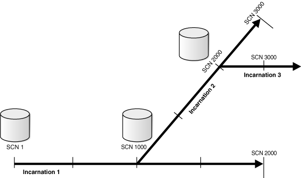

Figure 7-1, "Database Incarnation History With Multiple Resetlogs" shows a database that goes through several incarnations.
Figure 7-1 Database Incarnation History With Multiple Resetlogs
Incarnation 1 of the database starts at SCN 1, and continues through SCN 1000 to SCN 2000. At SCN 2000 in incarnation 1, you perform a point-in-time recovery back to SCN 1000, and open the datbase with a RESETLOGS operation. This creates incarnation 2, which begins at SCN 1000 and contines to SCN 3000. At SCN 3000 in incarnation 2, you perform another point-in-time recovery and RESETLOGS operation. This creates incarnation 3, starting at SCN 2000.
You can view the incarnation history of a database using the LIST INCARNATION command. Output describing the incarnation history in the figure is:
LIST INCARNATION; List of Database Incarnations DB Key Inc Key DB Name DB ID STATUS Reset SCN Reset Time ------- ------- -------- -------------- ------- ---------- ---------- 1 1 TRGT 930791268 PARENT 1 23-APR-05 2 2 TRGT 930791268 PARENT 1000 23-APR-05 3 3 TRGT 930791268 CURRENT 2000 23-APR-05
The value in the Reset SCN column is the SCN at which the RESETLOGS was performed. The Inc Key column is the incarnation key. RMAN uses the incarnation key to identify the database incarnation in some commands, such as using RESET DATABASE TO INCARNATION to change the current incarnation in some complex recovery scenarios.

By default, when used with an RMAN command like FLASHBACK DATABASE or RECOVER... UNTIL, an SCN is assumed to refer to the current incarnation path, rather than sibling incarnations. However, you can use the RESET DATABASE TO INCARNATION command to specify that SCNs are to be interpreted in the frame of reference of another incarnation. For example, consider the following command used in point-in-time recovery:
RMAN> RECOVER DATABASE TO SCN 1500;
If used in the database described in Figure 7-1, SCN 1500 refers to incarnation 2 by default. If, however, you run the following sequence of commands:
RMAN> RESET DATABASE INCARNATION TO 1; RMAN> RECOVER DATABASE TO SCN 1500;
SCN 1500 refers to the point in time during incarnation 1 when the SCN was 1500.
