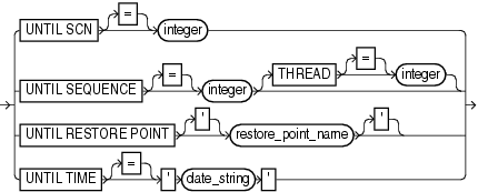

untilClause::=
A subclause that specifies an upper limit by time, SCN, restore point or log sequence number for various RMAN operations.

| Syntax Element | Description |
UNTIL SCN = integer |
Specifies an SCN as an upper limit. RMAN selects only files that can be used to restore or recover up to but not including the specified SCN. For example, RESTORE DATABASE UNTIL SCN 1000 chooses only backups that could be used to recover to SCN 1000. |
UNTIL RESTORE POINT restore_point_name |
Specifies a restore point, so that the SCN at which the restore point was created is the upper limit. RMAN selects only files that can be used to restore or recover up to but not including the corresponding SCN.
Note: The database must be mounted when using |
UNTIL SEQUENCE = integer THREAD = integer |
Specifies a redo log sequence number and thread as an upper limit. RMAN selects only files that can be used to restore or recover up to but not including the specified sequence number. For example, REPORT OBSOLETE UNTIL SEQUENCE 8000 THREAD 1 reports only backups that could be used to recover through log sequence 7999. |
UNTIL TIME = 'date_string' |
Specifies a time as an upper limit. RMAN selects only files that can be used to restore and recover up to but not including the specified time. For example, LIST BACKUP UNTIL TIME 'SYSDATE-7' lists all backups that could be used to recover to a point one week ago. |
