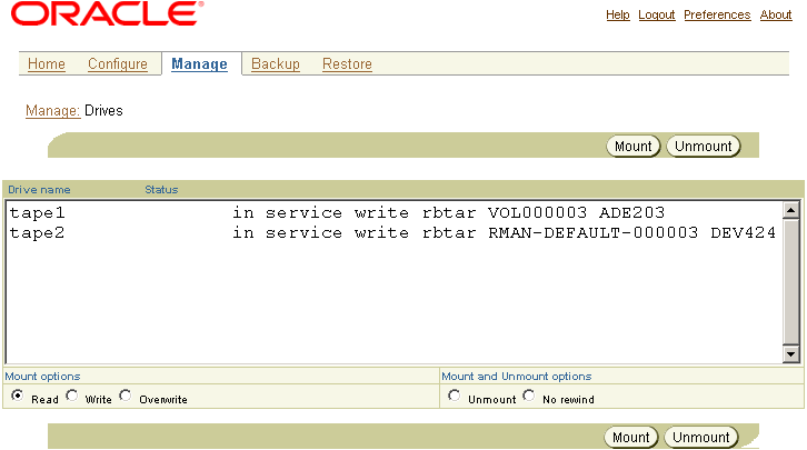

In the Manage page, click Drives to display the page shown in Figure 9-1. This page lists all dataset files and directories. You can use this page to mount and unmount volumes.

In the Drives page, select a drive from the main box.
The Web tool displays the names all drives that are attached to one or more media servers. A drive can have one of the following status values:
in service
This value indicates that the drive is logically available to Oracle Secure Backup.
not in service
This value indicates that the drive is not logically available to Oracle Secure Backup.
unmounted
mounted
This value indicates that the drive is mounted.
Choose a mount option from the Mount options provided.
These options let you logically mount a volume. When a volume is mounted, the obscheduled daemon is notified that a given volume is available for use. You can then set the mode of use for the volume.
The following mount options are available:
Read
Specify this option to tells the scheduler to use this volume for reading only.
Write
Specify this option to tell the scheduler that it can append any new backups to the end of the volume.
Overwrite
Specify this option to automatically mount a volume on the drive and position it at the beginning of the tape so that the existing contents of the volume are overwritten. If you use this option, you are granting permission to overwrite an unexpired volume. An unexpired volume is not eligible to be overwritten according to its expiration policy (see "Volume Expiration Policies").
Caution:
Use this mode only in situations that warrant or require overwriting unexpired volumes.From the Mount and Unmount options group, optionally choose one of the following options:
Unmount
Select this option to performs an unmount operation on the selected drive before it attempts a requested mount operation.
No rewind
Select this option to specify that the tape is not rewound when Oracle Secure Backup finishes writing to it. Oracle Secure Backup remains in position to write the next backup image.
Click Mount to mount the volume.

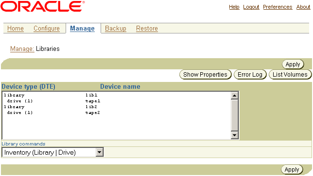

This section explains how to view and control tape libraries. This section contains the following topics:
In the Manage page, click Libraries to display the page shown in Figure 9-2. This page lists the tape libraries in the administrative domain. You can perform all tape library configuration tasks in this page or in pages to which it provides links.
To manage a library or tape drive:
In the main text box, select a library or tape drive.
From the Library commands pull-down menu, choose one of the following commands shown in Table 9-1. The last column of the table indicates the corresponding command in the obtool command-line interface.
Depending on the command, you must specify either a library or a drive. For those commands that apply to libraries, however, you can optionally specify a drive, because specification of a drive always implies the library in which it resides.| Menu Command | Applies to | Description | Section | obtool Command |

Click Apply to accept your selections.
The Web tool displays a new page with options specific to the command just specified. Refer to the relevant section for more information.
This command updates the current library inventory and enables you to force a physical inventory of the selected library.
In the Libraries page, select a library or drive in the main text box.
From the Library commands list, select Inventory (Library | Drive).
Optionally, check the Force box to force an inventory. Instead of reading from its cache, the library updates the inventory by physically scanning all library elements.
Click Apply, OK, or Cancel.

This section explains how to display properties for a library.
To view library properties:
In the Libraries page, select a library in the main text box.
Click Show Properties.
The Web tool displays a page with the properties for the library you selected.
Click Close to return to the Libraries page.

This section explains how to display the volumes currently contained in a library.
To display library volumes:
Click List Volumes.
The Web tool displays a page with the volumes for the library you selected.
This section explains how to display error messages associated with libraries and tape drives.
To display error messages:
Select a library or drive from the Library Management box.
Click Error Log.
The Web tool displays a page with error messages displays for the library or drive you selected.
Optionally, check Since (date) and specify a date range for specific error messages.
Optionally, check Read device dump file and enter the filename and path of the file that you want to read.
Choose one of the following:
Click Apply if you have either specified a date range or entered a filename.
Click Clear to eliminate error history. New error messages will display from the time of the clear.

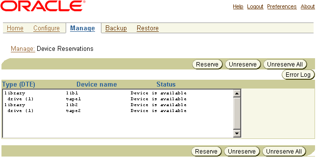

This section explains how to manage device reservations. This section contains the following topics:
In the normal course of operations, Oracle Secure Backup temporarily assigns exclusive use of shared resources to its processes and jobs. It does so using a built-in resource reservation system managed by the administrative server's service daemon.
You may encounter certain situations in which you desire exclusive and explicit use of a device. When such cases arise, you may direct Oracle Secure Backup to reserve a device for your use and, when you are finished, to release that reservation (unreserve it). While you hold the reservation, no Oracle Secure Backup component accesses the device.
In the Manage page, click Device Reservations to display the page shown in Figure 9-3. This page lists devices that you can reserve. You can perform all device reservation tasks in this page or in pages to which it provides links.
This section explains how to reserve a device for your exclusive use. You can also unreserve a specific device or unreserve all of your devices at once.
To reserve a device:
In the Device Reservations page, select a library or tape drive in the main text box.
Click Reserve.
The device is now reserved solely for your use. The reservation persists until you end your Web tool session or unreserve the device.
This section explains how to unreserve a device that has been previously reserved. You can unreserve a specific device or unreserve all of your devices at once.
Click Unreserve to reserve only the specified device or Unreserve all to unreserve all reserved devices.
The devices reserved in this instance of the Web tool are now available for other activities.
This section explains how you can display errors for a library or drive.
To display the error log for a device:
Click Error Log.
The Web tool displays a page with error messages for the device that you selected.
Optionally, click Since (date) and specify a date range for specific error messages.
Optionally, click Read device dump file and enter the filename and path of the file you want to read.
Click Close to return to the Devices page.
