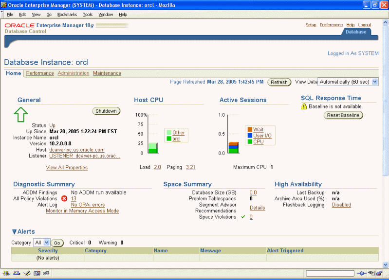

Database Control provides a Web-based graphical interface for managing all aspects of Oracle Database.
To open Database Control from the Windows Start menu, click Start > Programs > Oracle– oracle_home > Database Control– database_name.
You can also open Database Control from the URL provided during installation.
The following figure shows the Database Control home page.

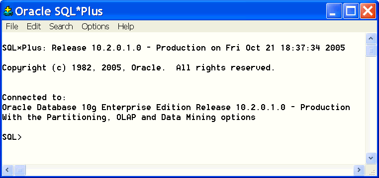

SQL*Plus is a command-line interface for the SQL language. You can perform all Oracle administrative tasks using SQL.
To open SQL*Plus from the Windows Start menu, click Start > Programs > Oracle– oracle_home > Application Development > SQL Plus.
You will be prompted for your user name and password. You must supply a host string only when connecting to a remote computer. The host string takes the form host_name:port:SID, such as myhost:1521:orcl
The following figure shows the SQL Plus window.

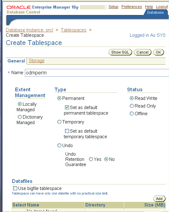

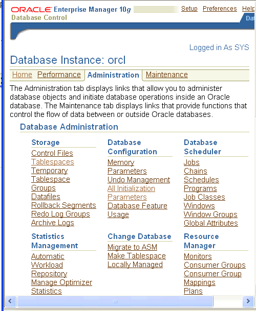

From the Database Control home page, select the Administration tab.
In the Storage category on the Administration page, choose Tablespaces.
On the Tablespaces page, click the Create button.

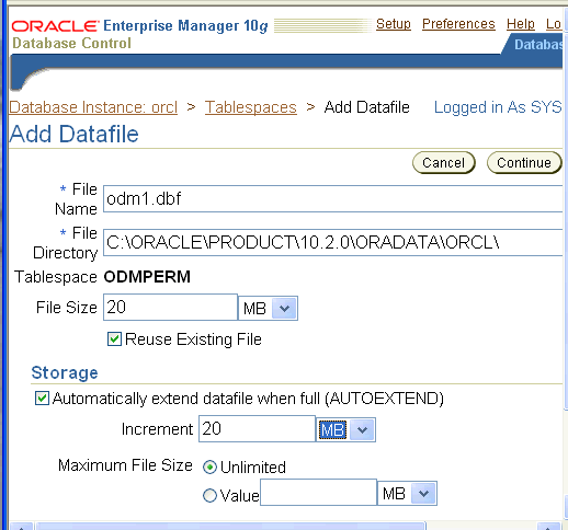

On the General tab of the Create Tablespace page, provide a name for the tablespace. Specify whether it is temporary or permanent, and set it as the default. To create the datafile, click the Add button.
On the Add Datafile page, provide a file name for the tablespace. Specify the file size and click the Reuse Existing File box. In the Storage section, specify AUTOEXTEND and provide the increment size. Click Continue.
On the Create Tablespace page, click OK.

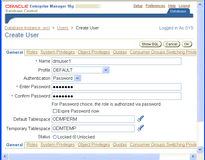

On the Database Control home page, select the Administration tab.
In the Users & Privileges category on the Administration page, choose Users.
On the Users page, click Create.
On the Create User page, provide the user name and password, and specify default and temporary tablespaces. Select the System Privileges tab.

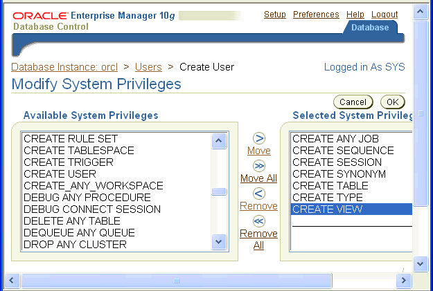

On the System Privileges page, choose Edit List.
On the Modify System Privileges page, use the arrows to move the required privileges from the Available box to the Selected box. Click OK.

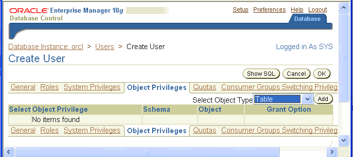

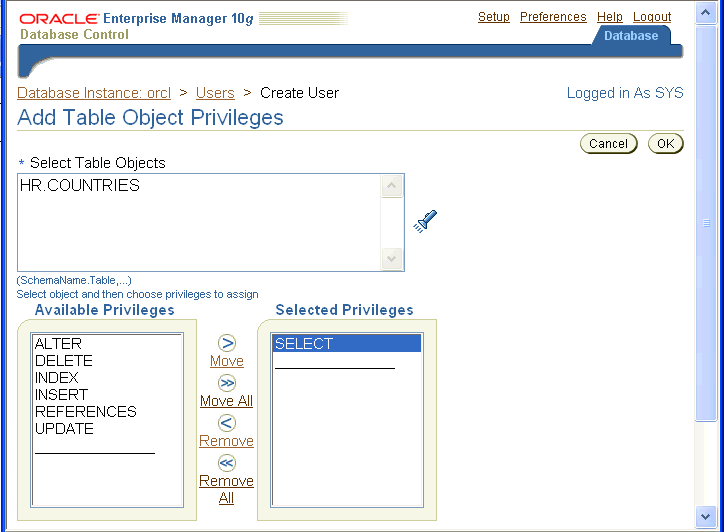

On the Create User page, select the Object Privileges tab to grant access to the mining data. In the Select Object Type drop down list, choose Table. Click Add.
On the Add Table Object Privileges page, choose the table where the mining data is stored and grant SELECT
access to it. The following example provides the user with SELECT
access to the sample HR.COUNTRIES
table. Click OK.

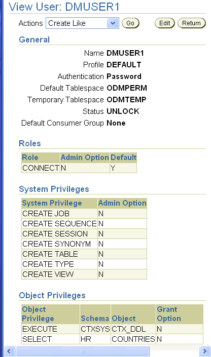

You can view the definition of the user you have created by clicking the View button.
